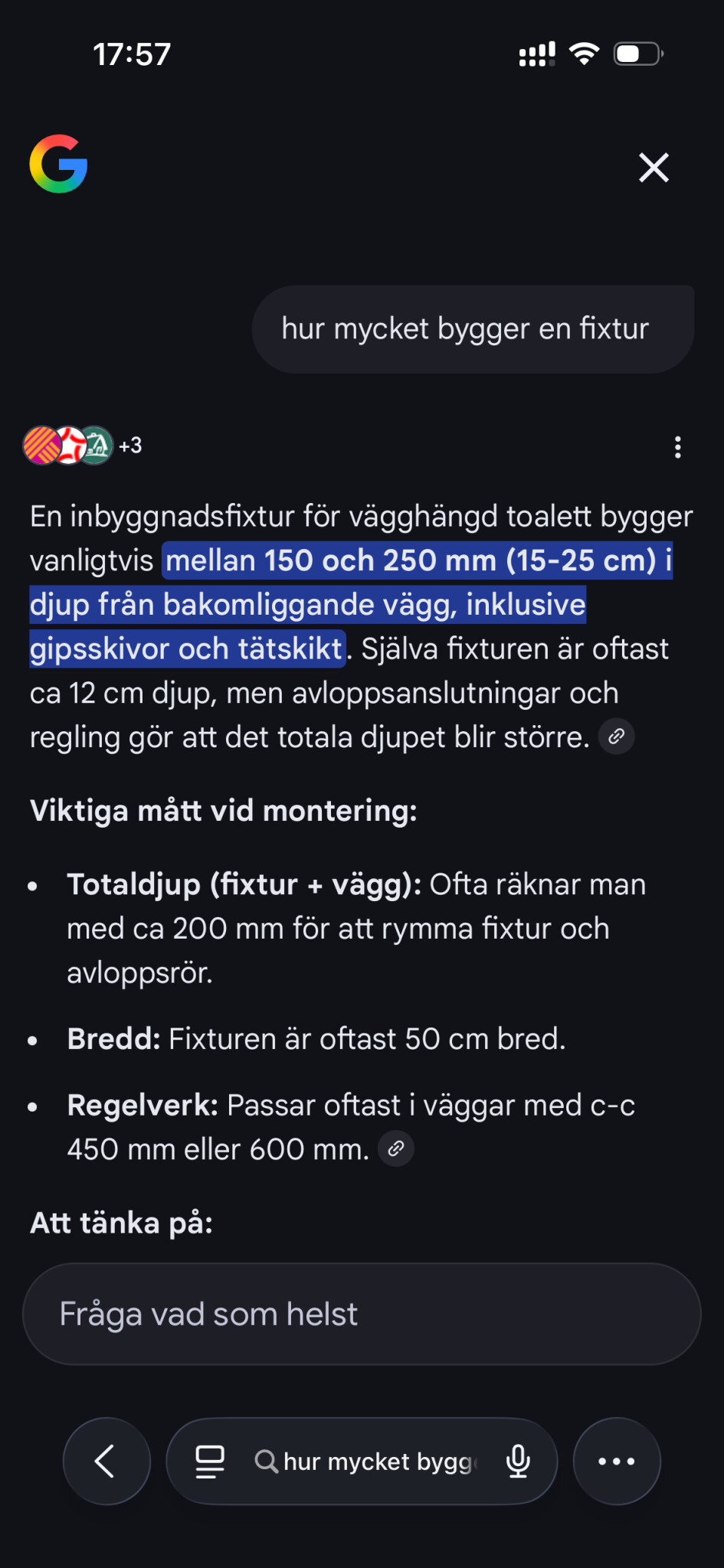

Ok vad menar du? Enligt hantverkaren är det normalt att fixtur bygger 15-20 cm. Stämmer inte det menar du?

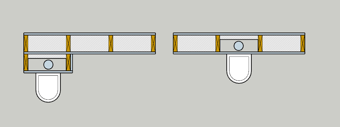

That's how it will be. A "box" will be added to conceal the mounting and flushing module. The mistake is that this module wasn't hidden in the wall, as I suggested earlier.
Bellow: that's it will be and that's how it should be
  • Två ritningar av en väggkonstruktion; den vänstra visar en synlig flushmodul och den högra visar modulen dold i väggen.

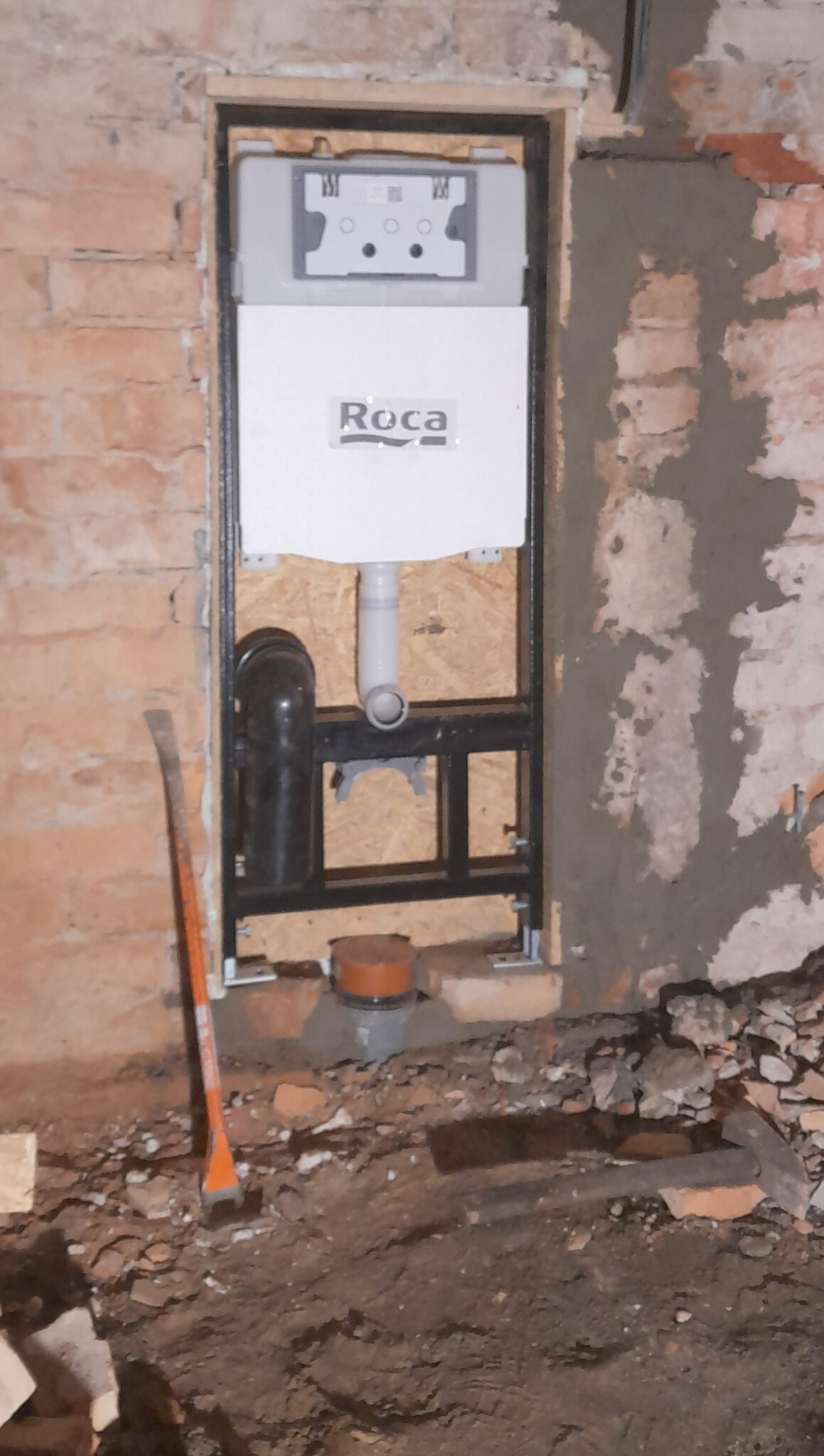

Just because artificial "intelligence" tells you so doesn't convince me. (Once again you ask about something and then "you know better") Below is an example of what I was talking about. 8cm deep. And this isn't some invention from distant Asia, made on a junk. But a brand-name product that still costs 900 PLN, or about 2500 SEK.

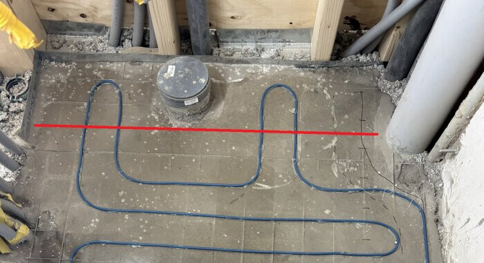

Under construction floor with exposed blue heating cables and a red line indicating area of concern.

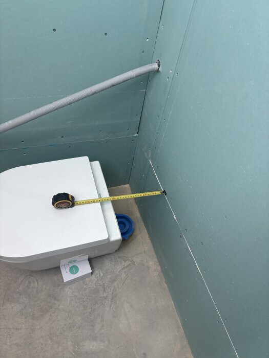

Mätband på toalettstol i hörn av renoverat badrum med exponerade väggar och synlig slang, visar djupet av installationen.
The two photos above show that part of the heating cable has been covered! This is unacceptable. Again, many people have advised you to throw these scumbags out or call an inspector. At least do the latter before you have to tear down the bathroom again. Many mistakes can be fixed now at a lower cost.

I pretty sure that the middle picture is the bathroom and the other one the guest toilet

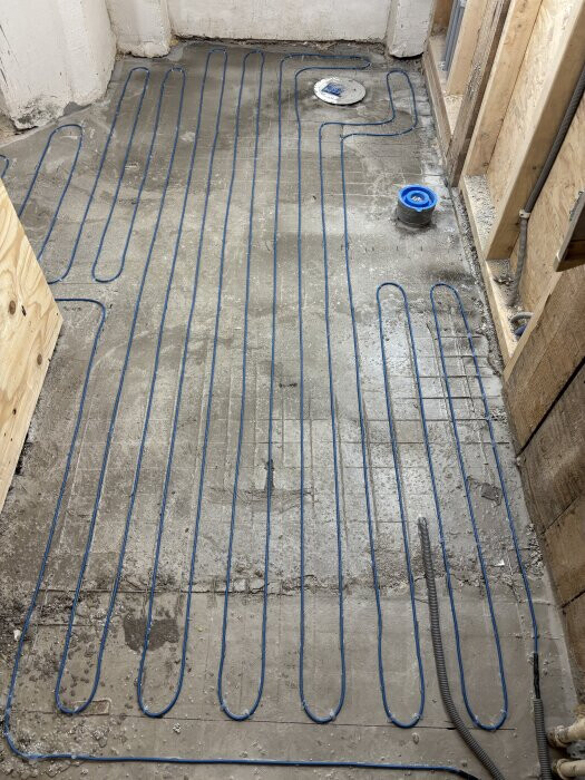

Bild av ett badrum under renovering, med synligt golvvärmesystem och toalettavlopp inte placerat i hörnet.
@GoC Sorry, but your certainty doesn't convince me. Above is the bathroom, and as you can see, the toilet isn't in the corner.

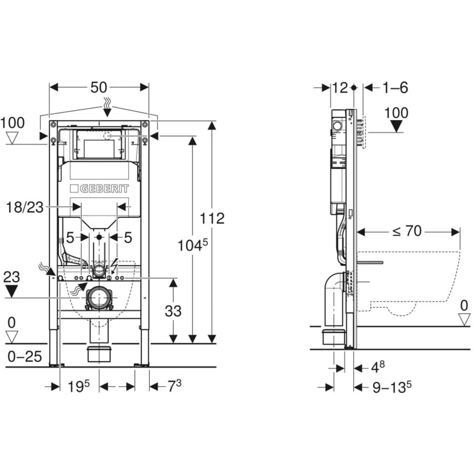

This is the fixture we have.
According to the constructor it cannot be built inside the wall. Also according to the contractor the toilets drain need to be 6cm out from the wall

I'm sorry, but that's not true. These types of toilets are designed to be built into the wall. You see them every day, for example, in shopping malls and gas stations. Ask them to show you the regulations.
Diagram över en vägghängd toalett och cistern från Geberit, visande mått och avstånd. 70 mm avstånd till vägg, installationen visas både framifrån och från sidan.
Do you see the nonsense in this drawing that the toilet drain needs to be 70mm from the wall???
And let me ask: did they move the heating cable so it wouldn't reach under the cower? Or did they perhaps have some silly explanation, like that it's needed to defrost the water tank or evaporate condensate?
