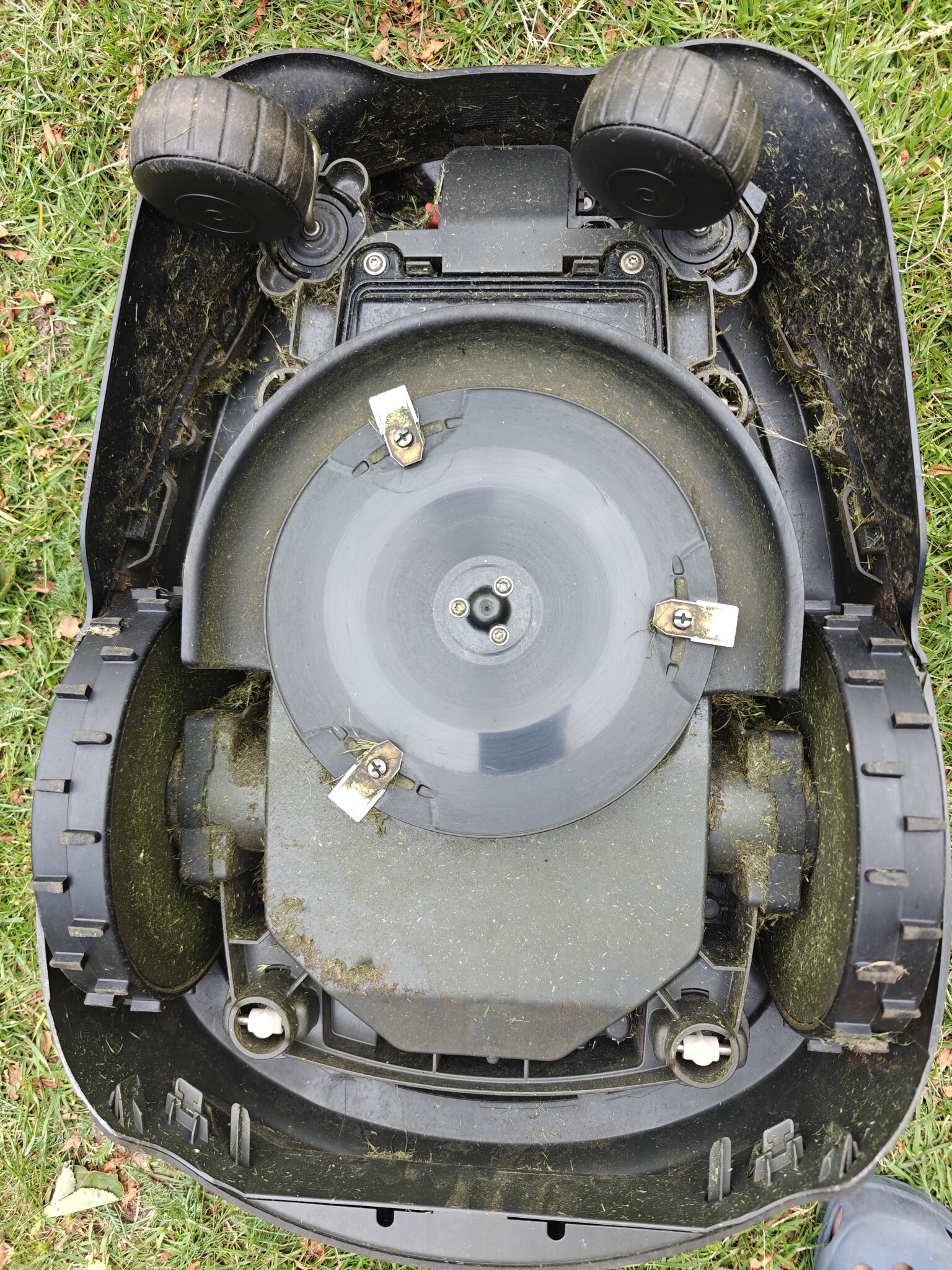

Ah but it has happend twice in 2 weeks now. I dont think it looks particularly dirty? Can the outer shell be removed for a deeper cleaning?stavee skrev:
