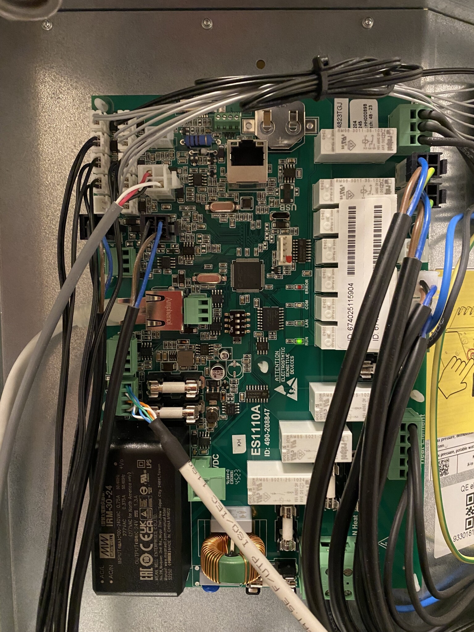

I had my Qvantum connected with a network cable, and with WIFI as well. Qvantum took back the router that came with the heat pump.JudgeSweden skrev:
I have a loose router that we put inside the overhead cupboard, so now I had to fish it out and put it outside instead. Don't understand why the boiler needs to have a 4G connection when it already has Wi-Fi available? If the power goes out in the house, the boiler dies anyway. It would be if your internet connection fails then, just like the alarm has a 4G backup.
What model do you have and when did you have it installed? I have a QE4 that was installed in January.
Fungerar det med ethernet kabel nu? Jag provade efter installationen i september förra året. Då gick det inte och Teltonika routern ansluten till pumpen var enda sättet. Fjärruppkoppling och uppgradering fungerade inget vidare.. Någon månad senare fick de wifimodulen på displayenheten att fungera (en ESP32 modul). Jag ska kabeln igen nu i helgen, wifi täckningen vid vår QE4 är på gränsen..JudgeSweden skrev:
OK, jag vet att det varit tal om att de ska bygga in funktionen istället för att ha en extern enhet. Då går din på 4G istället för Wi-Fi, för du har molnsymbolen nere till vänster i din display?
Jag hade ett eluttag bakom gamla VVB, så jag kunde koppla in routern där. Har man ett nätverksuttag i närheten kan man enkelt dra en Ethernet-kabel till uttaget från pannans Erhernet-port.
Yes, my QE6 was installed in November last year. The ethernet cable was connected to the port on the print. But it also uses the built-in WIFI module as well. In the log of the router I see traffic on both interfaces.M Mull129 skrev:Does it work with an ethernet cable now? I tried after the installation in September last year. Then it didn't work and the Teltonika router connected to the pump was the only way. Remote connection and upgrading didn't work at all. A month or so later they got the wifi module on the display unit working (an ESP32 module). I'm going to re-wire the cable this weekend, the wifi coverage at our QE4 is on the limit.
OK, I disconected the LAN cable when the internal wifimodule started to work. I would be surprised if they enabled the LAN as an option to wifi. I'll check tonight/tomorrow.M mhmschouten skrev:

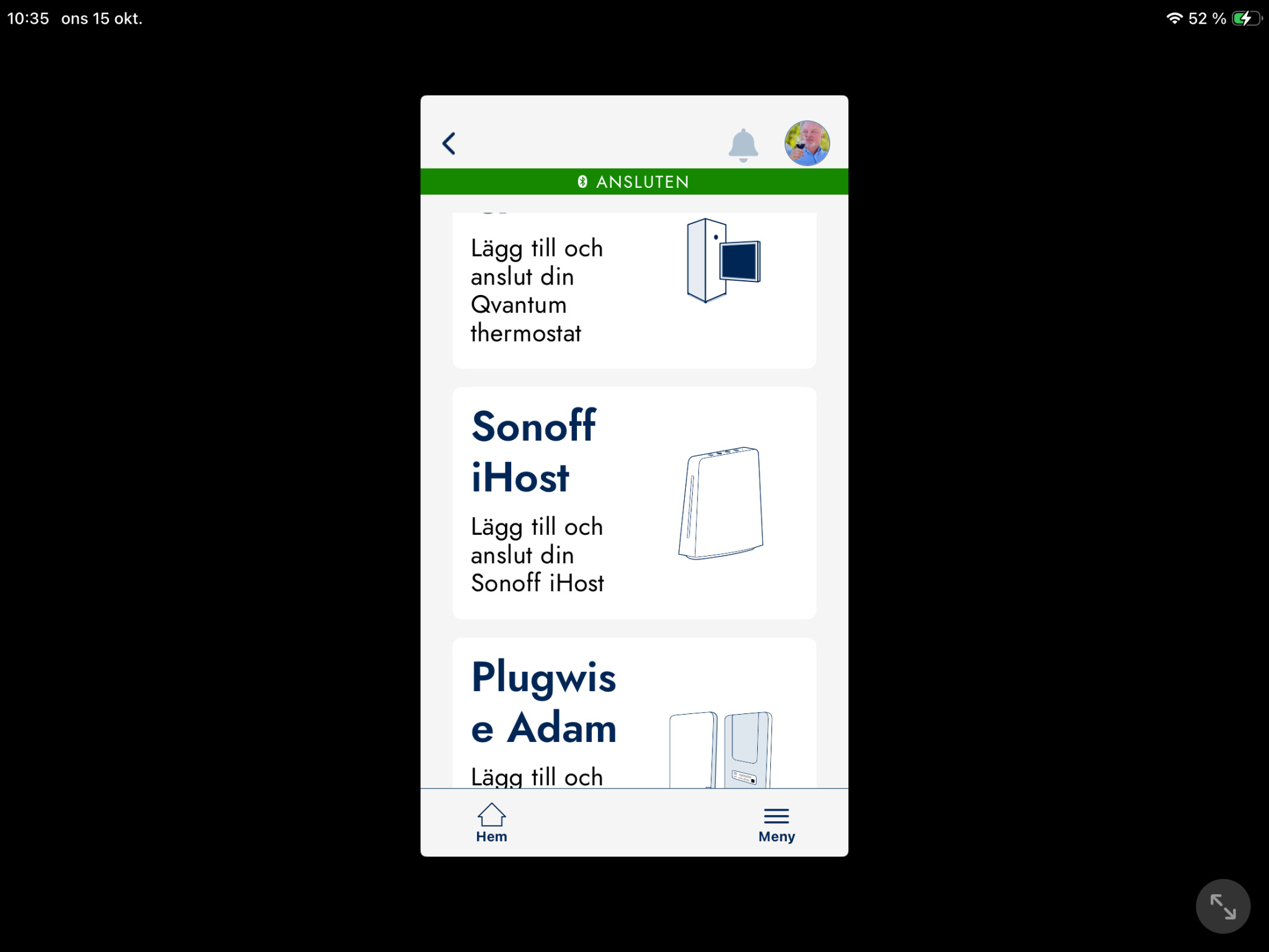

Nu såg jag stöd för att lägga till enheter i nya appen. Tex trådlös termostat! Var köper man denna, kan ju slippa en massa jobb..
Se bild
Se bild

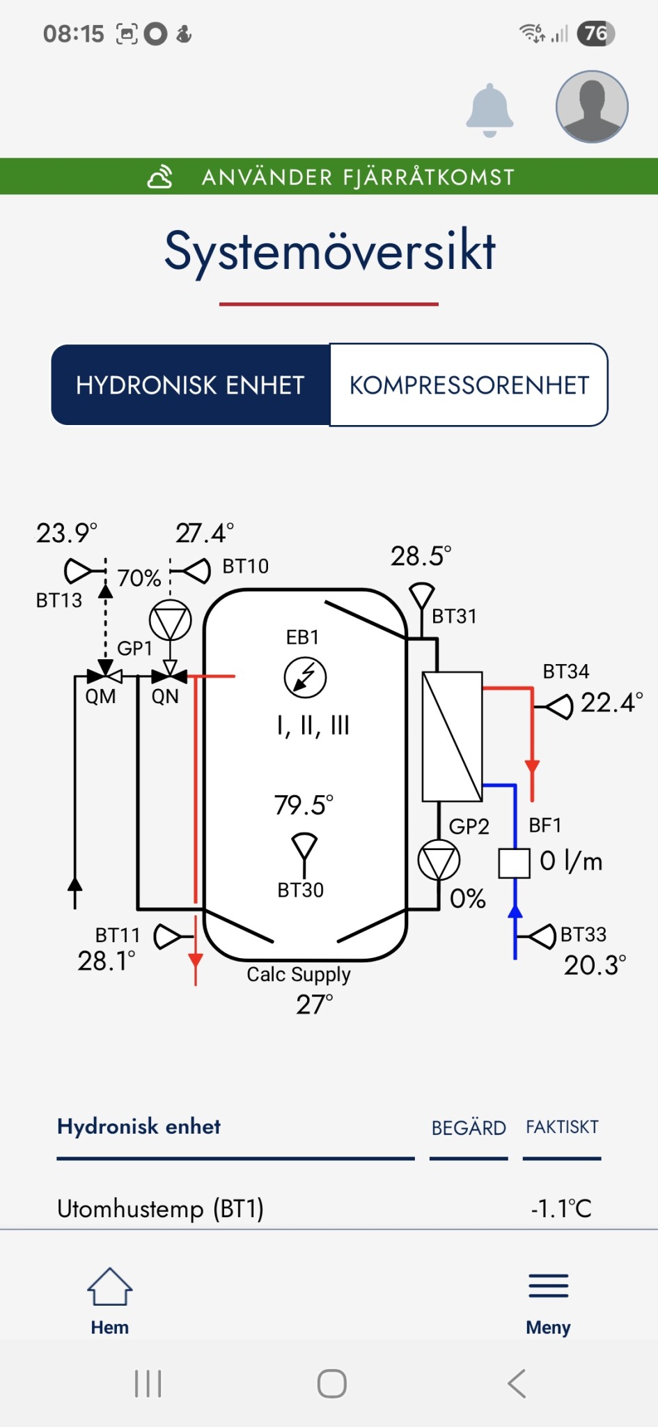

I morse fick min QE6 något konstigt ryck och värmde tanken till 80 grader än fast jag har inställt varmvattnet på "2-gubbar". Den brukar värma upp till 64 grader med kompressor.
Nu maxade den till 80 grader med elpatron, precis som jag INTE vill ha det....
Någon som vet om någon uppdatering har gjorts?
Någon som upplevt något liknande?
