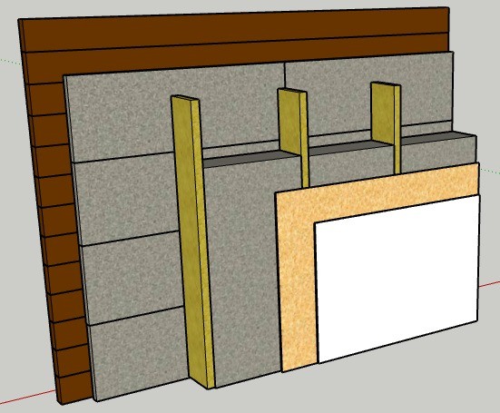

Thanks for your reply! you got me thinking more about overall thermal requirements. I also decided to do a cost analysis per square meter vs wall thickness. I hope I have found a better solution now which is MUCH cheaper than using PIR and overall the wall thickness isnt really impacted. I am thinking it will also help with the thremal bridge problem - I have attached a sketchup image I made. External wall, Stenull 45mm, Stenull 220mm, plywood 12mm and gips 13mm. I tried my best to calculate the thermal value (using something from kingspan) it came out at 7.32 overall at a cost of 325 kr per square meter compared with 851 kr per kvm for PIR with a U value of 6.11.F fb35523 skrev:60 mm insulation of any kind will not give you a "Swedish house grade" insulation.I actually saw this, which looks promising:

Does this make sense or am I missing the point?

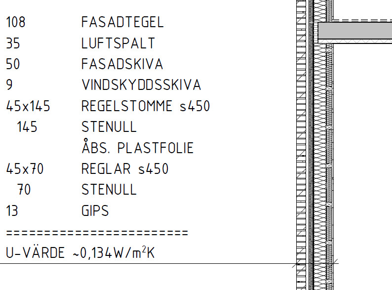

I would do it like this:
External wall, Windproofing?, Stenull 220mm,PLASTFOLIE, Stenull 45mm, plywood 12mm and gips 13mm.
That way you can have your electrics in the 45 mm without breaking the moisture barrier.
Somewhat like this:
Somewhat like this:
Please refer to Träguiden,
https://www.traguiden.se/konstruktion/konstruktionsexempel/vaggar/
The site is owned by Svenskt Trä, Swedish Wood and they have a bit of knowledge.
"Swedish Wood represents the Swedish sawmill industry and is part of the Swedish Forest Industries Federation."
https://www.swedishwood.com/
Excellent thanks! do you think that the 45 mm stenull needs to be cut to catch the underlying wooden studs or does that matter if the plywood is nailed over the top?B BjörnEng skrev:
