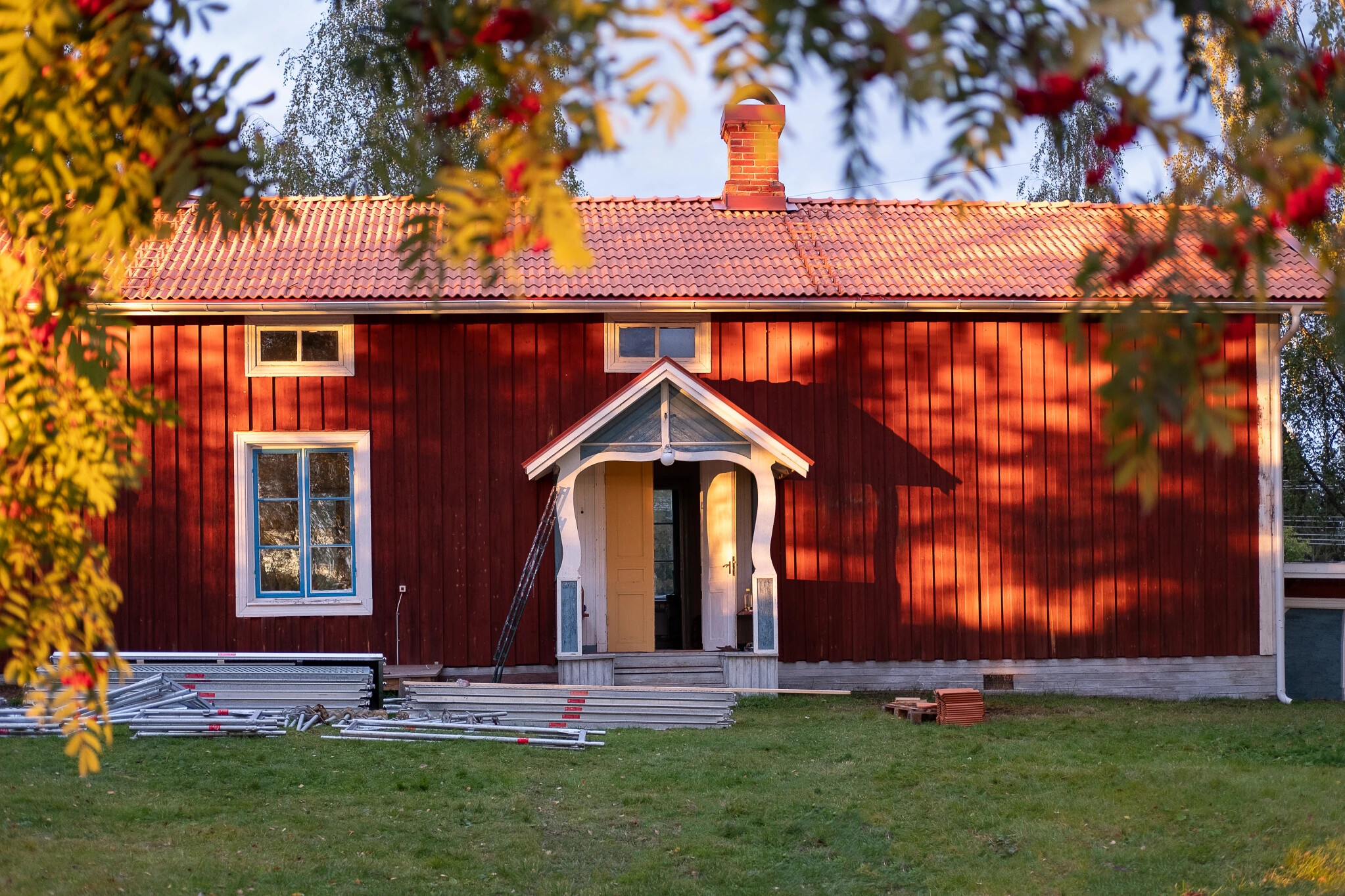

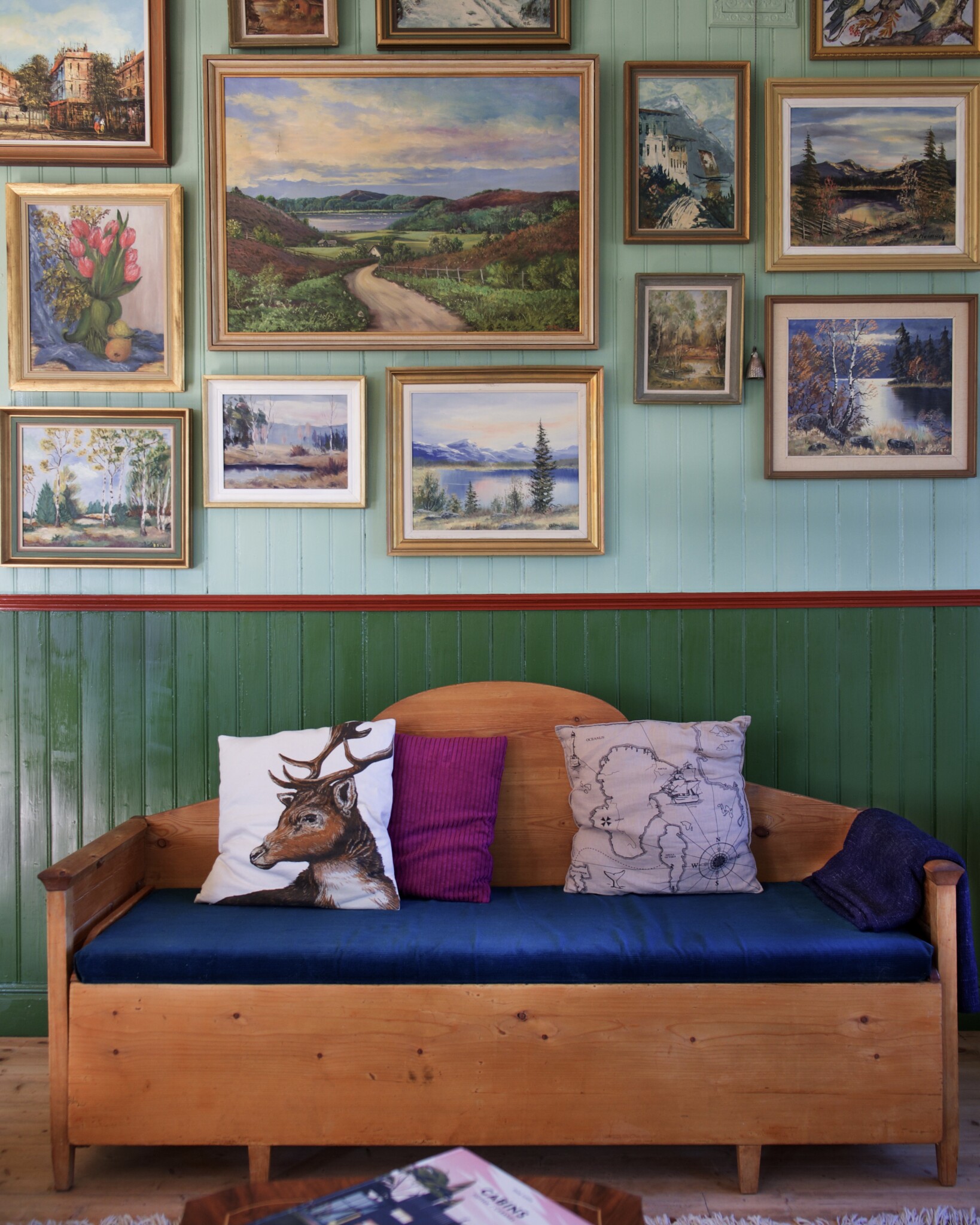

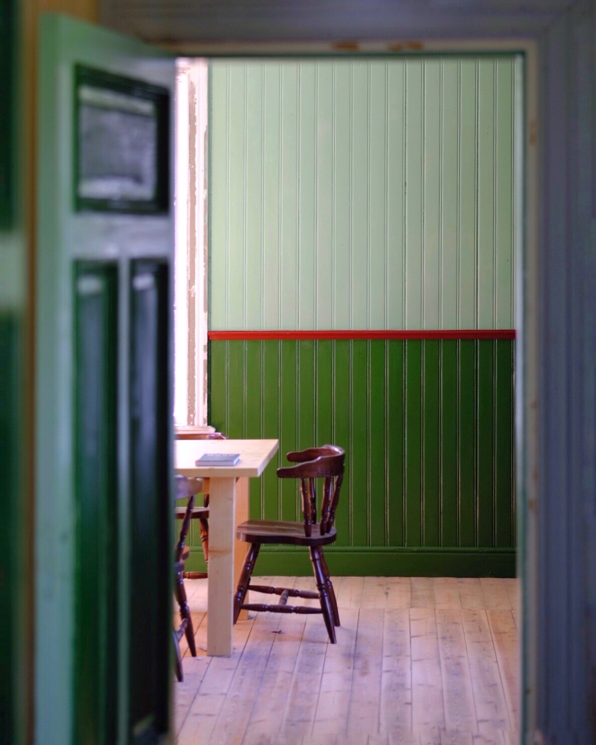

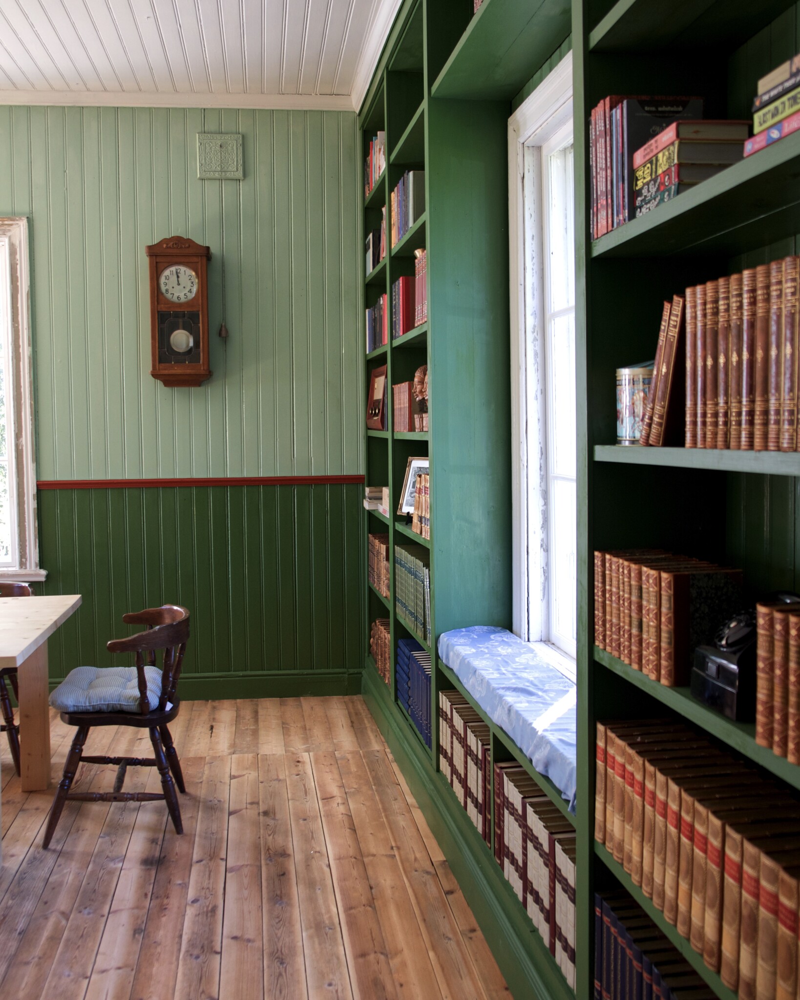

I did the same thing in 2017, bought myself an old school house that had been standing empty for a few years by then. I taught myself what is needed to fix the house, hired companies for those that I didn't know how to do (sewage, roof) and over the years it has become a place that we as a family look forward to going to.
My recommendation is to do it, you only live once. You will create a wonderful memory renovating the place and making it yours.
Good luck.
Read about my project here https://skolanvattuvalla.wordpress.com/
