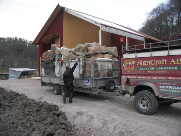

excuse writing in english, i read and speak swedish. I enquired about an Ifor Williams Trailer a few years ago a LM166 they wanted I believe 49,000kr for that that was just the bed nothing else.
I bought a brand new one in the UK for £2600 with sides, and high mesh extensions, 8ft loading ramps and spare wheel, it sits on 185 x 60 x 12, I went to a local tyre company one year here and they fitted dubbdäck on an extra set of 13" wheels I had ordered in from Starco, it was while pulling a vehicle in the snow I realised they had sold me a shite set of tyres that were not C rated 104N. I made enquiries here about winter tyres, and was told by the däckmafia that only Chen Shin CR966 were approved here for winter (odubbad). I found an importer here talked to a sales guy and after a discount was told they would cost 2500kr each....nice try.
I have since bought Maxxis (Chen Shin) CR966 from England 195 x 50 x 13 which is same running diameter as 185 x 60 x 12 they cost £49 each and £26 in postage for 5 of them.
It cost me about the same as others have mentioned for regbesikt. I got Ifor Williams to supply a registration kit for Sweden in the UK which they charged £50, not sure how that works today, the hitch is german Knott and the same I think on most of their 3500kg trailers, removed the fog light on the back, otherwise just move it to the otherside. The loading hooks are rated in UK for 900kg, but I think the spec in Sweden was 500kg, I had a paper for that, but it wasn't written "Enligt TSV 1978 blah blah blah" So I wrote my own intyg for that.
They have a new agent here in Sweden now Trailerimport not had any dealings there.
The trailers are very strong, if you look on ebay you will see second hand ones selling sometimes as much as new, they are the UK's biggest and best trailer manufacturer.
