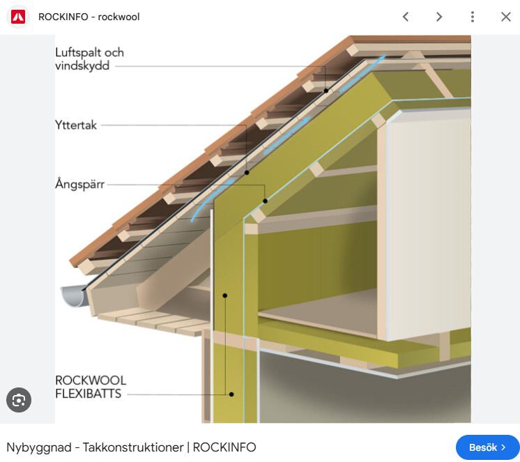

Adding a picture, (honestly stolen from https://info.rockwool.se/sv/isolera-ratt/nybyggnad/takkonstruktioner/), which describes the principles in an universal language.

As for the external roofing, there always needs to be an ventilation layer/duct directly underneath. For a tin roof there will always be condensation due to temperature changes more or less every day year around. That moist needs to be able to ventilate to the outside. Also, with more hefty/rapid temperature changes there is a lot of condensation so a moistproof roofmaterial underneath is required to handle it. For external roofs with roof tiles this is even more important. Thoose roofs do not have a problem with condensation, but they are not so watertight so rain and snow gets in to some degree, especially in combination with wind.
