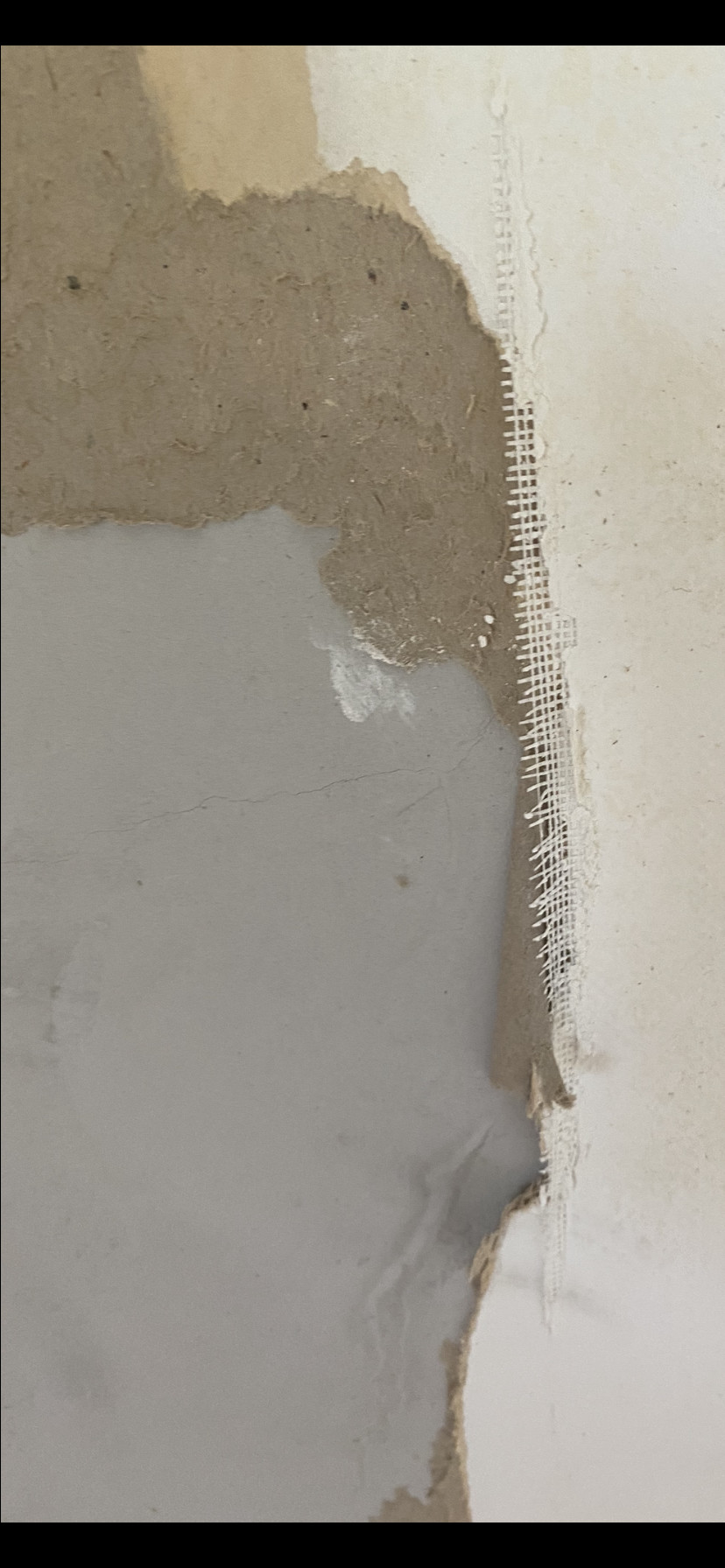

I have bought my first house and started renovating it. I started to remove wallpaper to pain the walls.
But seems I remove one layer more! There were two layer wallpaper and another layer of cardboard( that I do not what is that)
Then what can I do? What is this cardboard? House is old from 1965.
Any clue appropriate a lot.

Är det gipsväggar? För gips har ett tunt lager papp utanpå som man inte ska ta bort.
Majid Faz
I think, not sure. See picture.
then what should I do? Do I have any solution?
  • En vägg med skadad puts och en exponerad armeringsduk.

Looks like "vävtapet". Your fine, you can just remove it :)
