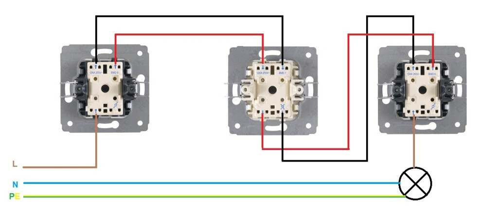

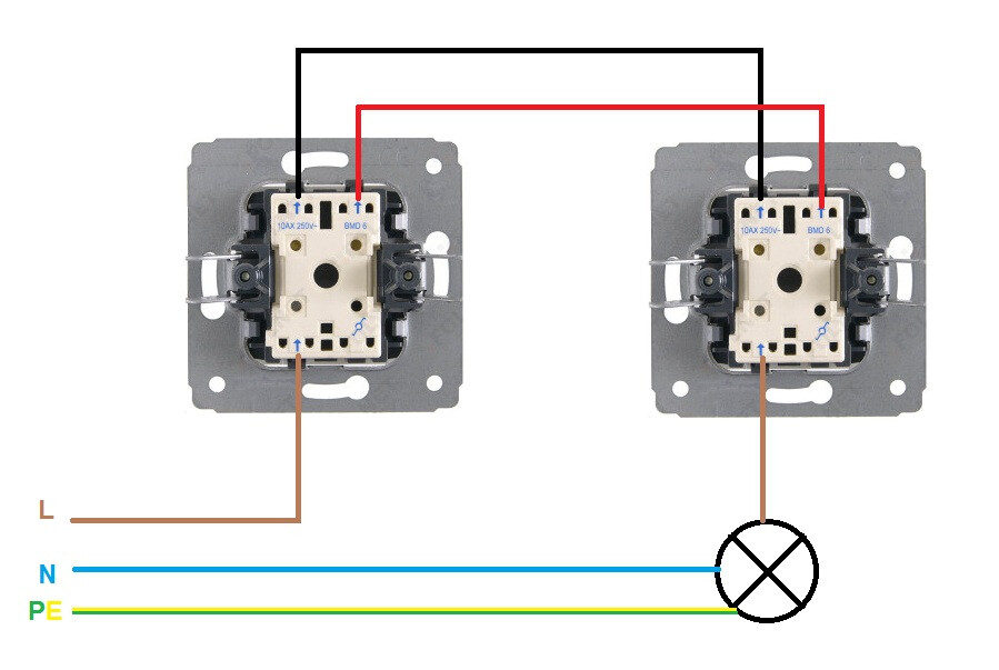

In your photo there is a cross switch which is used in the case of 3 or more points of switching on the light. The rule is that the number of regular staircase switches is always 2 and any number of cross switches. In the case of 3 levels - 2 staircase and 1 crossBerhem skrev:
Either you bought the wrong switch or you have the wires connected incorrectly.
2 point
3 point
Your type switch is this midle on down picture
