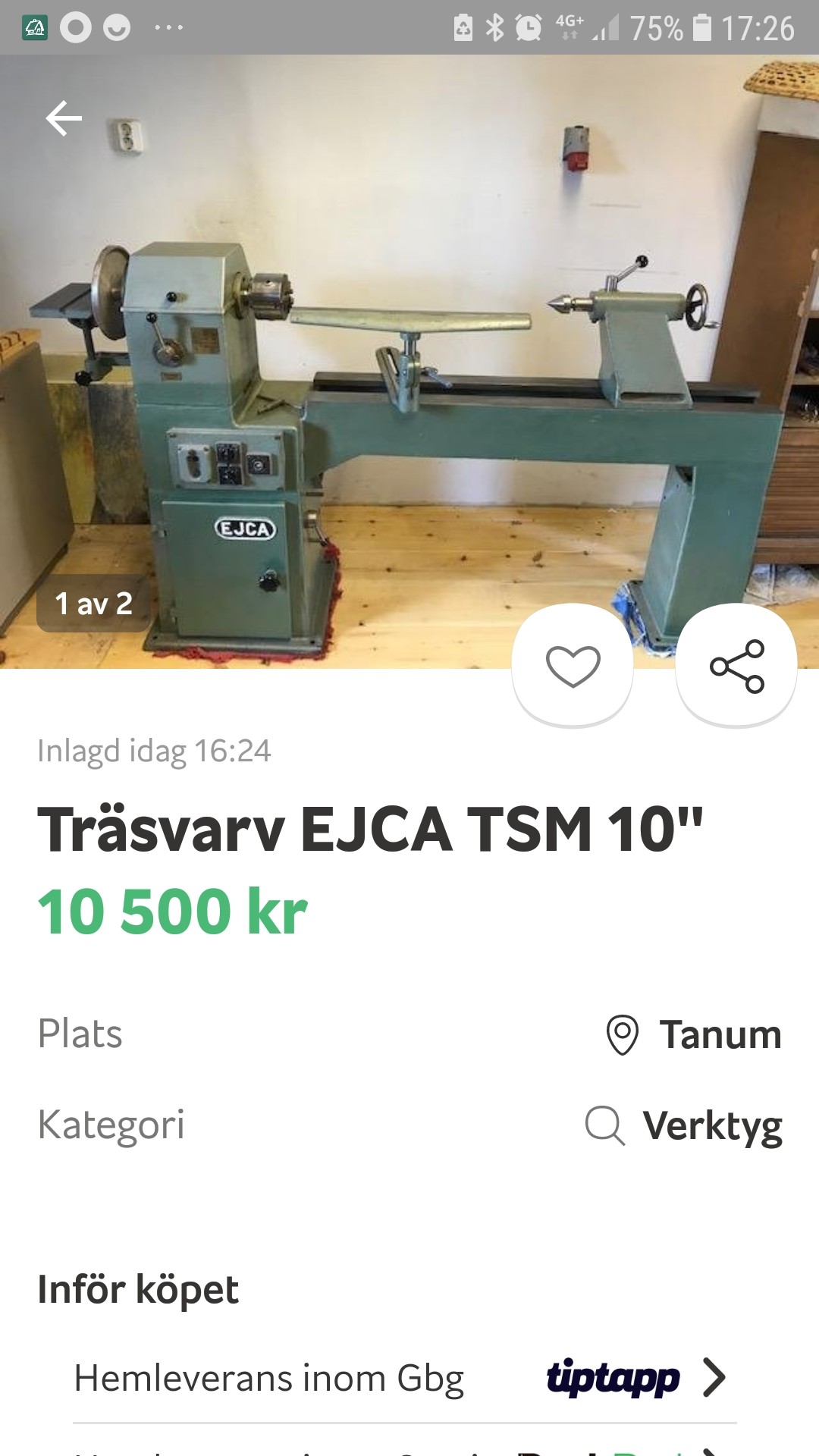

Ett exempel:
https://www.blocket.se/vi/86256971.htm
