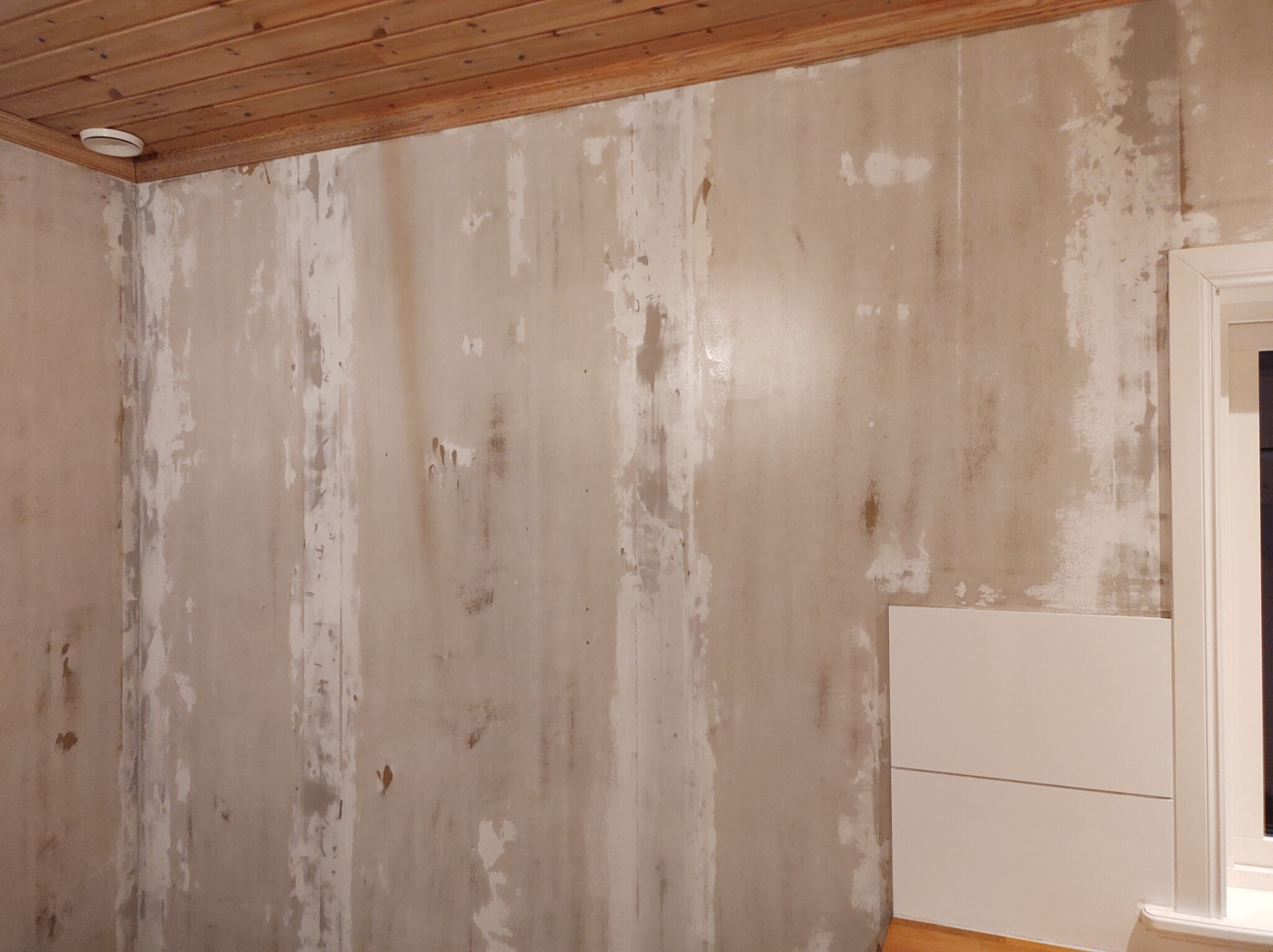

We are renovating the living room and removed wallpaper from plasterboards to paint everything.
The previous owners used different kind of wallpapers in different areas. Really glad that 75% of the wallpapers came off without any issues or any damage to the plasterboards behind it, except some left over glue which can be removed easily.

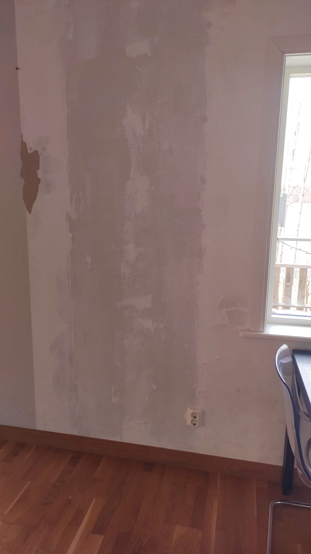

There is a different kind of wallpaper in the kitchen and we just started removing this, but it also takes away the face paper (the upper 1mm of the plasterboard). See picture (left is plasterboard with the face paper still on it, in the middle its gone after removing the wallpaper and to the right it is the problem wallpaper which doesn't come off properly.
I have a few questions about about how proceed
1) Any tips on how to remove the rest of the wallpaper without damaging the plasterboard?
2) How to repair the damaged area? It is not deep, just really not even 1mm.
3) What primer to use on the plasterboard before painting? Is it ok to just use Beckers Primer and then Beckers Living?

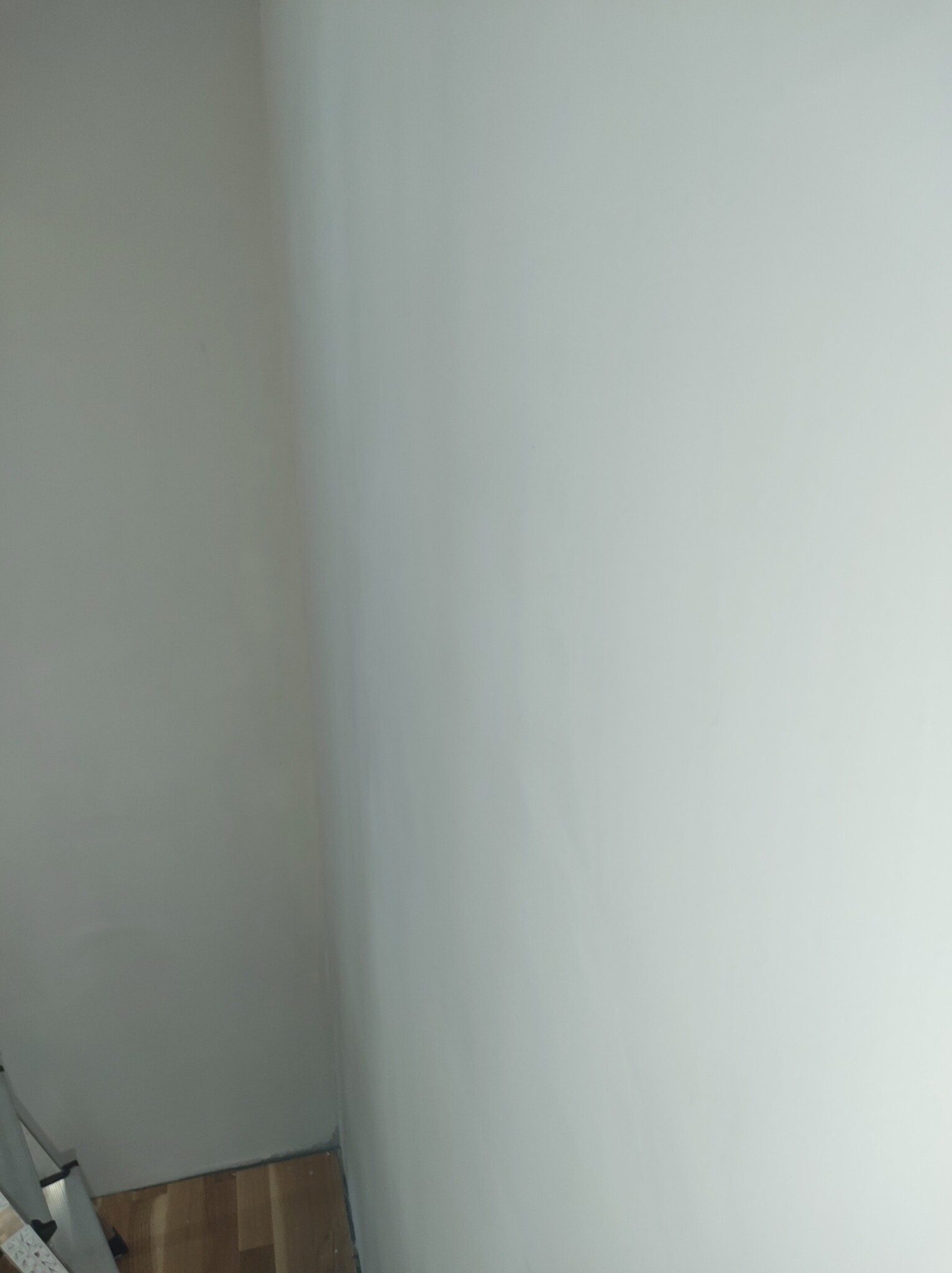

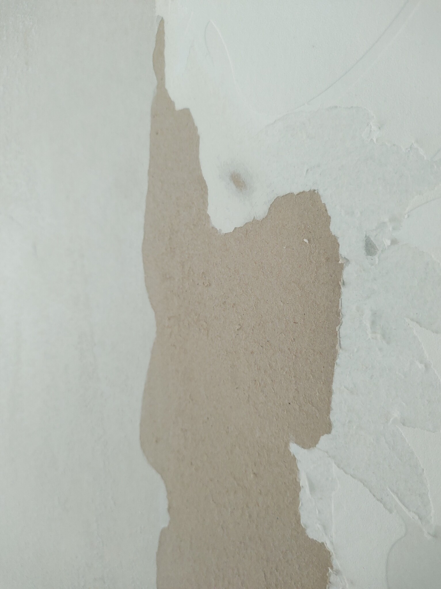

Quick update, also for other that might run into same issues.
This is what I did:
1) Remove wallpaper
2) Use Zinsser Gardz on all walls, damaged or undamaged. I sealed it all with Zinsser Gardz.
3) Skim coated with Jotun Rullsparkel, three layers.
4) Manual sanding with Mirka Abranet (thanks to tips here on Byggahus).
Result is a pretty smoot wall! Thank you
Picture 1: After removing wallpaper and using Zinsser Gardz
Picture 2: After skim coating and sanding
Thank you all for the help!
