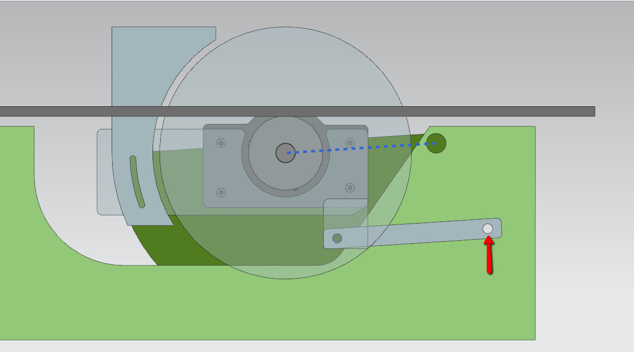

To start with, the principle is a parallelogram with a rotating axial bearing in the center of the arbour, refer to picture below. So, the principle is that the riving knife plate rotates around blade axis center, and the bar screwed to the chassi makes sure the top of the knife stays parallel to the saw top. The length of the bar matches the distance between the pin around which the swing arm rotates and the blade (blue dot line).

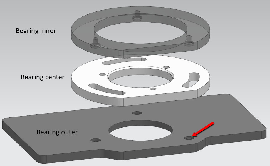

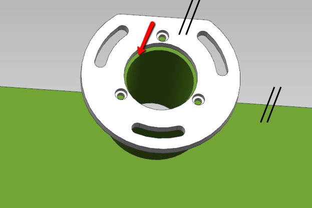

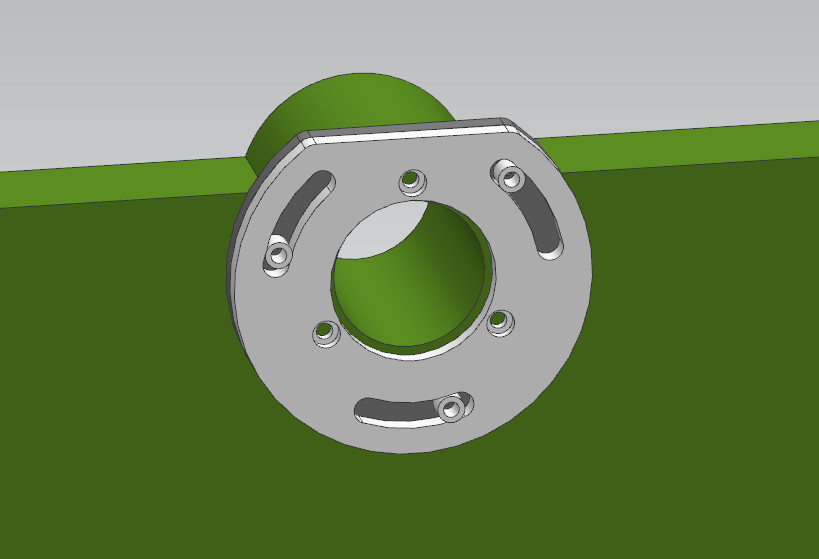

Below pic is the heart of the function, the axial bearing. These 3 parts needs to be very accurately machined. In the slots there are guide pins (seen in pic 3). The center bearing is screwed onto the front of the arbour housing (threaded directly into it, I think I used M4. Then nuts on backside to counterlock the screws). Inner and outer bearing rotates around the center bearing.

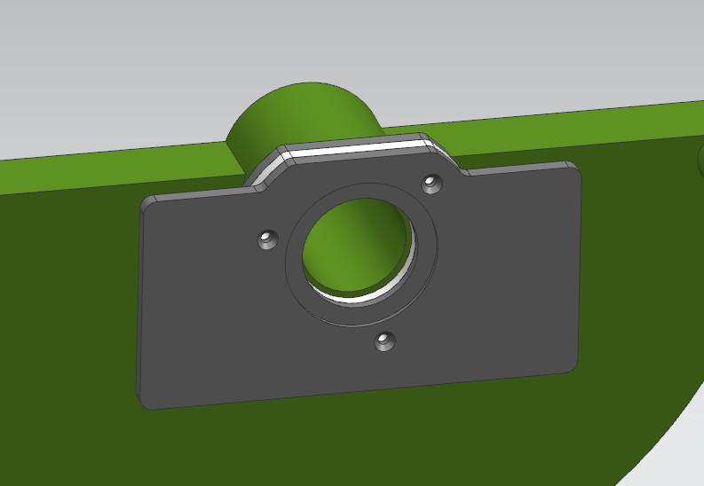

Center bearing is as said, screwed onto front of arbour (you need inner bearing to be in place when you finally assemble it). Top flat surface on center bearing should be parallel to flat surface on swing arm.To make the knife parallel to the blade, front arbour house surface needs to be parallel to the blade. I used a file to get the surface parallel and checked it with the arbour flange (?, the big steel thing right behind the blade). Centerbearing should preferable be concentric to hole in arbour housing.
Guide pins shown, I made these on my metal lathe, in POM plastic for low friction. These should be a few hundred of mm longer than nominal distance between bearing parts to allow movement. Pins are flat sunk in both inner and outer bearing for guidance.

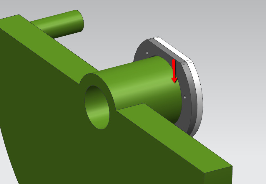

To fit the inner bearing some material needs to be removed from arbour housing. The housing is not concentric. I used a file for this as well.
Heart of mechanism in place and now you here https://www.byggahus.se/forum/threa...och-maskiner-idag.250889/page-19#post-2338695. You see I have some brown sheets between the parts, that is taped on low friction material (I think PTFE) to avoid aluminium against aluminium rubbing.

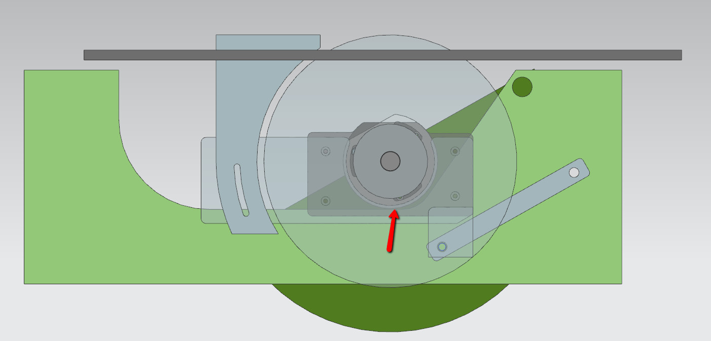

Following pics is what is needed in terms of modifications to give the bearing room. You need to remove some material from the saw to make room for the bearing in the lower position. I used an angle grinder with colour removal disc.

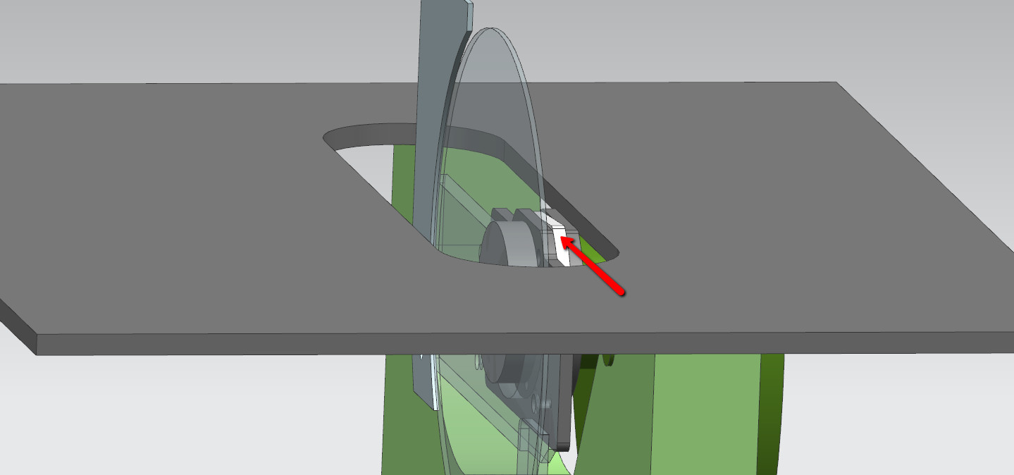

Entire top needs to be shifted slightly to the right (no machining work and this is very small move, dont remember but I loosened the bolts and slightly moved the top).
I made a recess in my zero clearance insert to make room for the bearing in the top position. (not much needs to be removed).

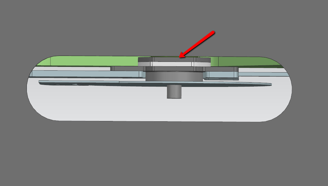

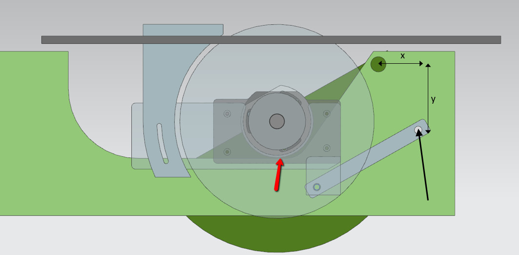

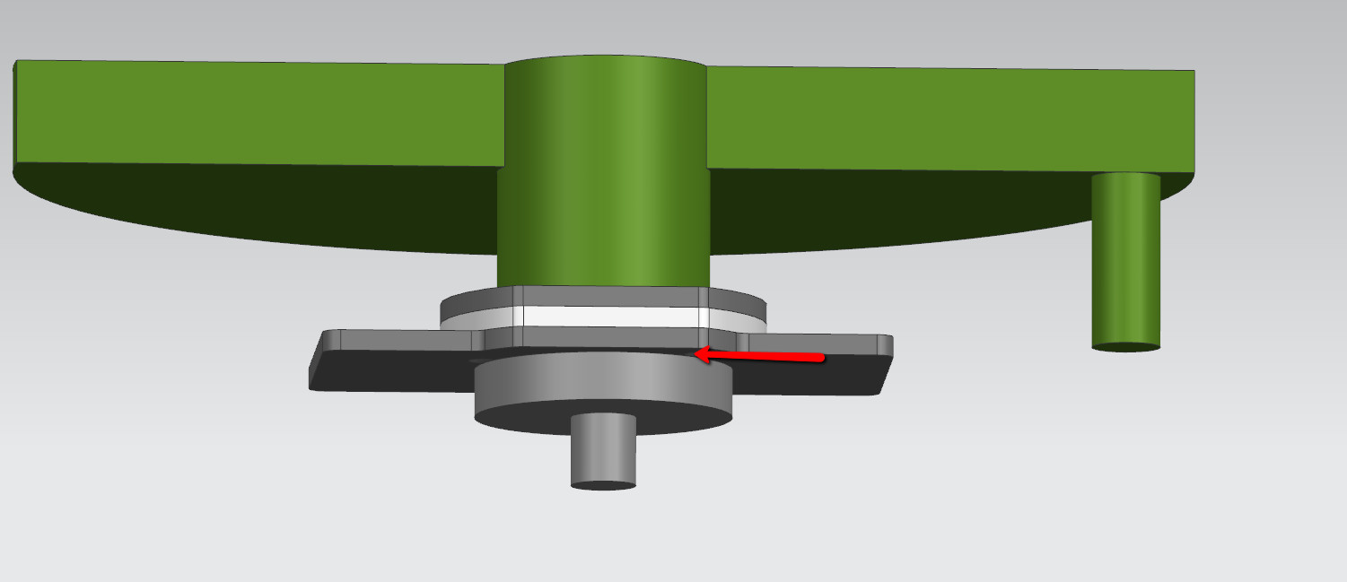

This is the tricky one and the main reason for why you should try to use thinner plates in the bearing construction. Arbour flange needs some axial clearance to the outer bearing plate. That means pushing the arbour towards the blade side. But, pushing it out long enough means the arbour bearing closest to the blade ends up half way outside the housing. So, I removed approx. 5mm from the distance cylinder that sits between the bearings, material was removed from blade side. Then I added approx. 5mm thick turned distance cylinder between bearing nearest blade and the arbour flange. This moves the entire ball bearing and distance cylinder towards the non blade side so both bearings fits inside housing.
This hole (black arrow) needs to be at the correct position in both x and y, in relation to the swingarm pin center. Take the dimension from 3D file.

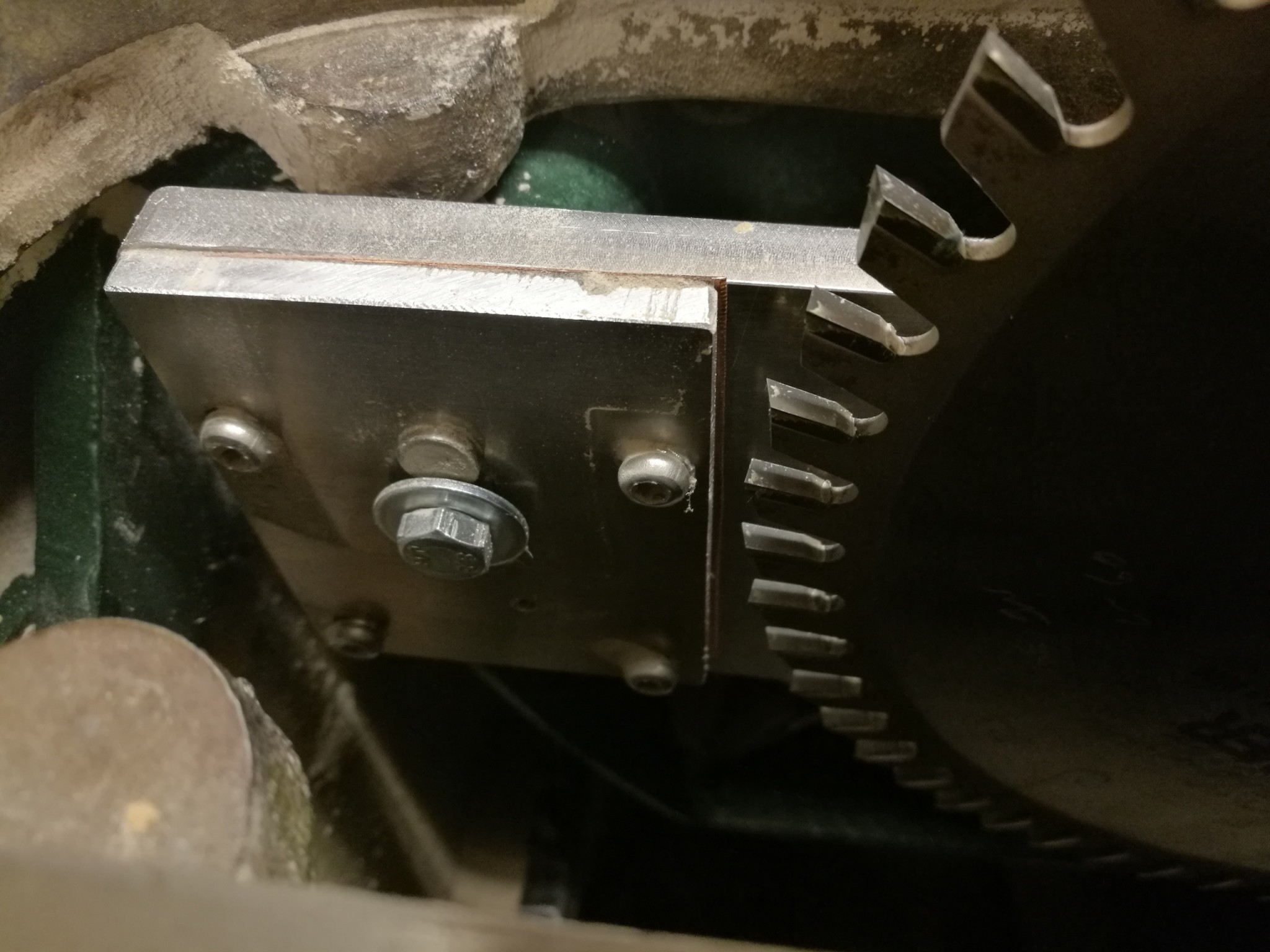

Rest is easy, the big plate the riving knife sits on doesnt need to be very accurate (but the hole position for the bar needs to be connected at the right position). The connection bar (or rather the hole positions) needs to match distance between swing arm rotation point and blade center axis. Follow the 3d for C-C dimension between the holes.
Riving knife sits on its own plate, 2 turned cylinders for guiding and bolt between them. I use dewalt knife and blade guard, they are extremely cheap (around 10£ for both knife and guard).
