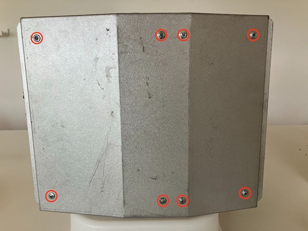

After removing the drum from the device unscrew the front screws marked in read.
Grå metallplatta med sex skruvar, markerade i rött, som används för montering eller demontering av en komponent.

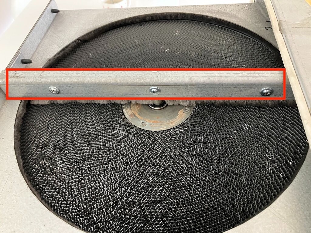

Inspect everything is in order and that the belt is not broken or cracked.

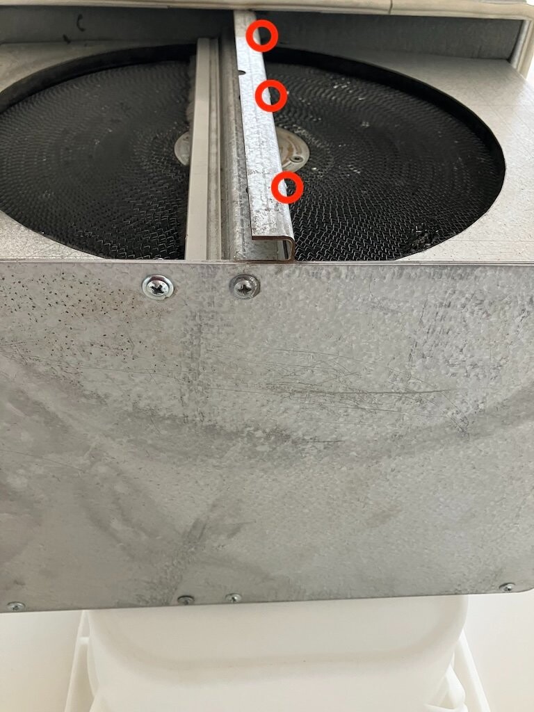

Then proceed to remove the top holder of the brushes by unscrewing the two screws op the back side. You don't need to unscrew the three screws holding the brush.
Metallram fäst med tre skruvar över ett svart nätgaller, del av en apparat där lager och axel kan justeras.
Then remove the torx screws holding the shaft and the plate holding the bearing. You wont be able to extract the shaft until it gets unscrewed from the other side.

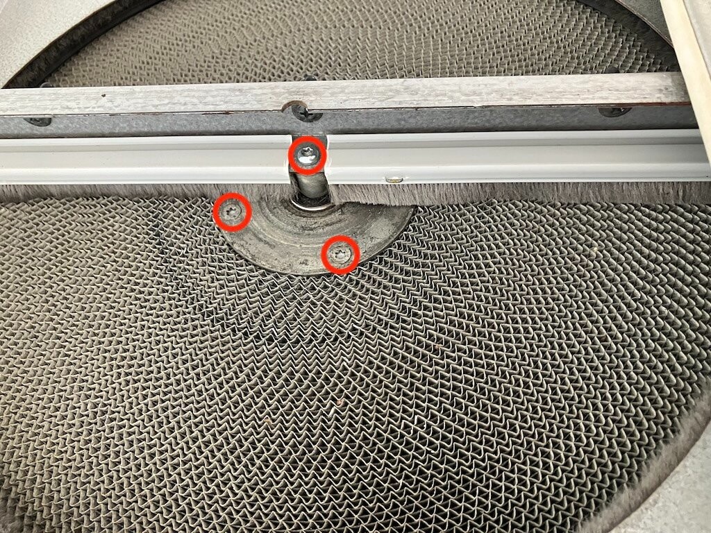

Now on the other side, first unscrew the screws holing the brush:
Metallisk trumma med tre markerade skruvar framtill, del av en mekanisk enhet för lagermontering.
Take out the brush so you can get access to the torx screw holding the shaft. Unscrew the shaft. Now you should be able to take out the shaft and the plate holding the top bearing.
