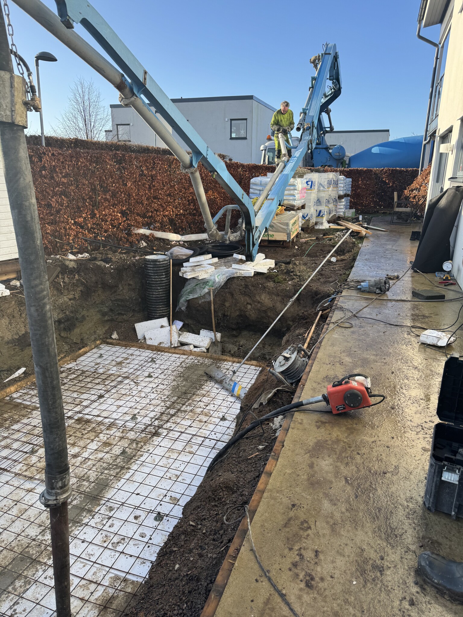

Ett företag har startat byggnation av pool och utfört grävningssteget och även gjutit pool plattan.
Jag reagerade i efterhand nu en dag efter plattan gjutits att armeringen inte överlappar på vissa ställen. Påpekade detta men de menar att de byggt många pooler på detta sättet och att det aldrig varit problem.
Vad säger ni om armeringen enligt bild?

Problems with this type of construction generally arise after the warranty period. It's clear that the company skimp not only on the reinforcement mesh, but also on the spacers. It's a clear sloppy job.

Yes I agree. And I am stupid that paid for the job day before it was ”ready”. The drain pump was added same day as the casting and I am unsure if that one is ok as well..
Just because you paid doesn't end the matter. You have photo evidence of the slab's poor workmanship. Any expert will confirm this. The company should now pour another layer with the proper reinforcement. This is optimal. The photo shows that the ground conditions don't guarantee the slab's durability. If the subsoil were rock, it would be a different story. Here, you can see clay and silt.
