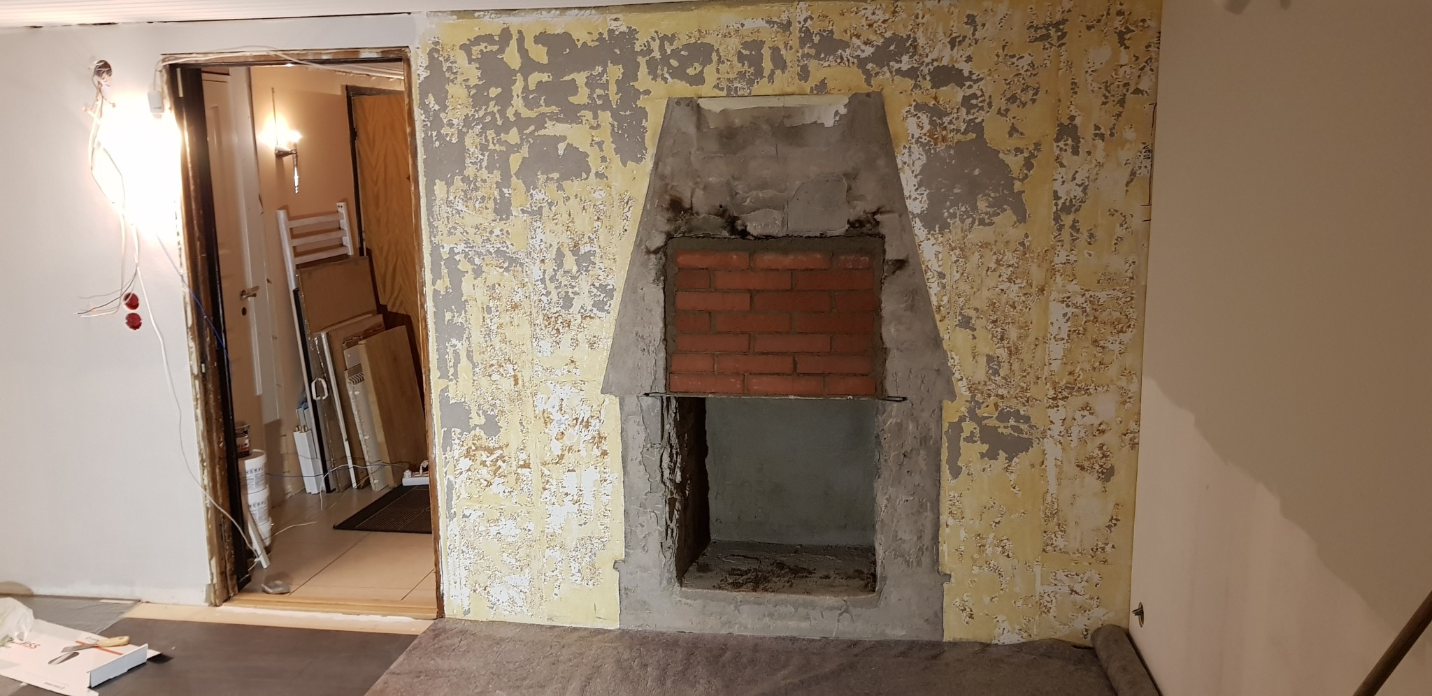

I have an open fireplace that we're planning to install a insatskamin. We won't be doing this for at least a year so just want to plaster the wall/aperture in preparation. I live in Kungsbacka and have no idea who to contact for this work as plastering isn't really a specific trade here in Sweden. Can any guide me? Tack!

I'd say you should find a "murare", that's the relevant trade in Sweden for this kind of job.
Places that sell fireplaces/woodburners usually either have their own murare, or can recommend someone, as it's often needed when installing a fireplace in an existing chimney, such as yours. Make sure to tell the person doing the job that you have plans to install a fireplace later on, so that they use the right materials.
