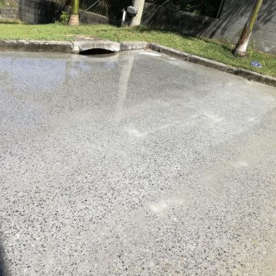

You can grind the concrete to make the stone visible and then treat it with concrete sealing. It should also be possible to get some anti-slip protection in the sealing treatment.
