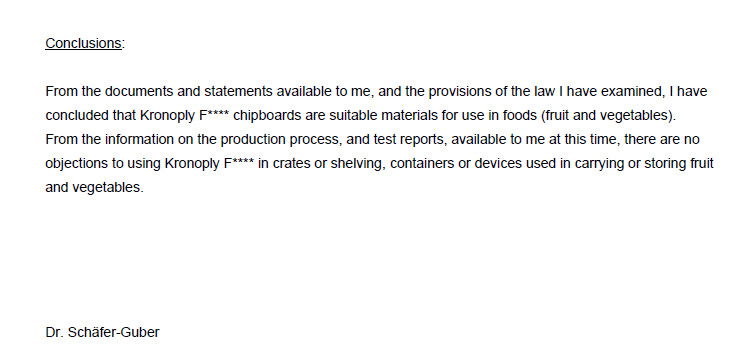

Fick nu svar and PDMI från SWISS KRONO (Kronoply) som producerar den formaldehyd-fria OSB som Byggmax säljer för 105 kr/skivan. Vad ska man säga om detta?
Dear Mr. Kiander,
PMDI is a Polyurethane beased glue. You could also find this material as foam in the mattress of your bed or your sofa, in the armature of your car.... But such products are 100 % made of that and in our boards it is only 2.5 %!
After bonding this glue is emission free and neutral to the environment. Because of that the OSB can also be used for food packaging (find a certificate attached).
I hope this would answer your question. If you need more information please do not hesitate to contact us.
Mit freundlichen Grüßen / Best regards
Stefan Gottfried
SWISS KRONO GmbH
Och här är sammanfattningen av bilagan:
Dear Mr. Kiander,
Stefan Gottfried
SWISS KRONO GmbH
