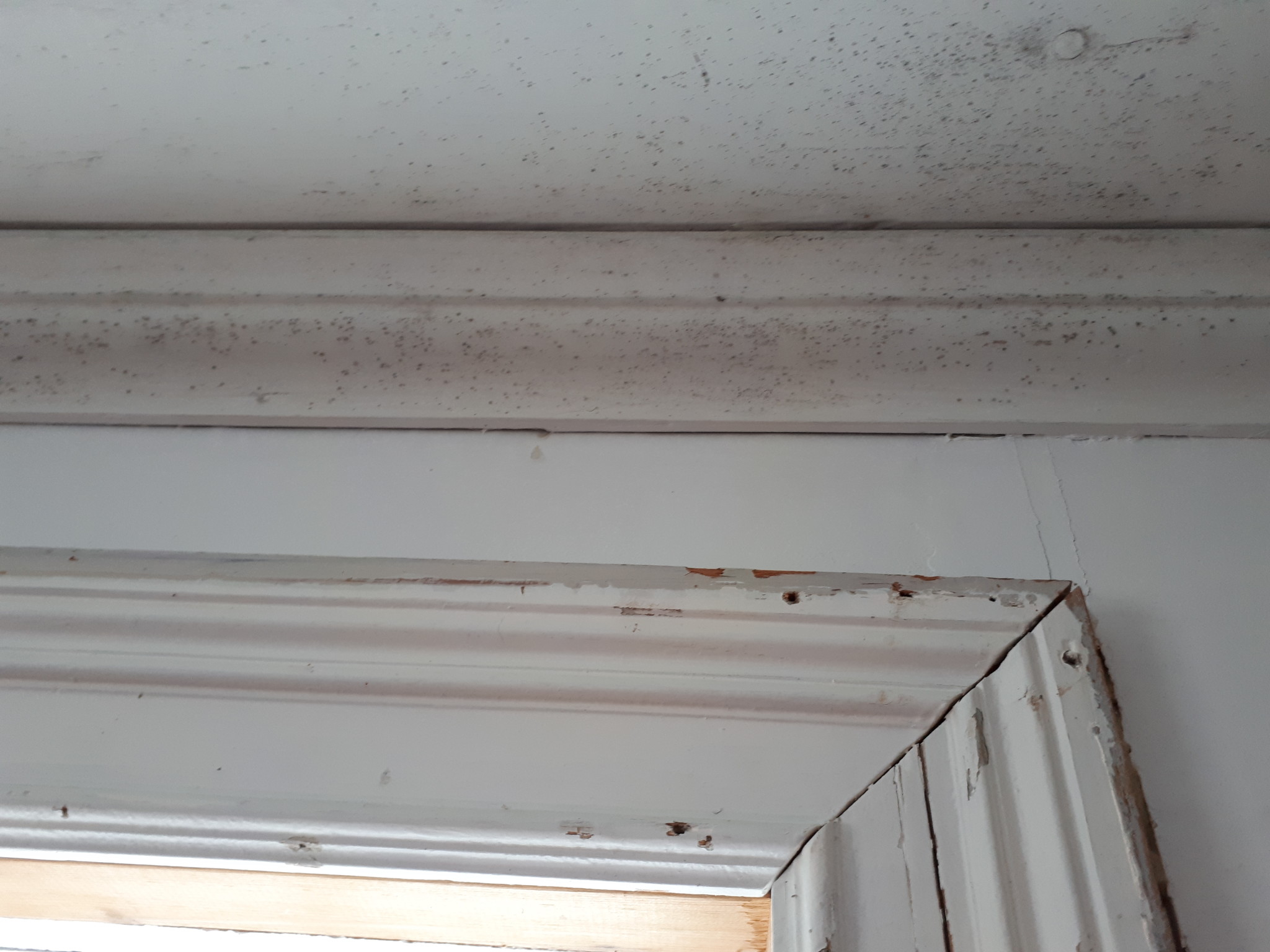

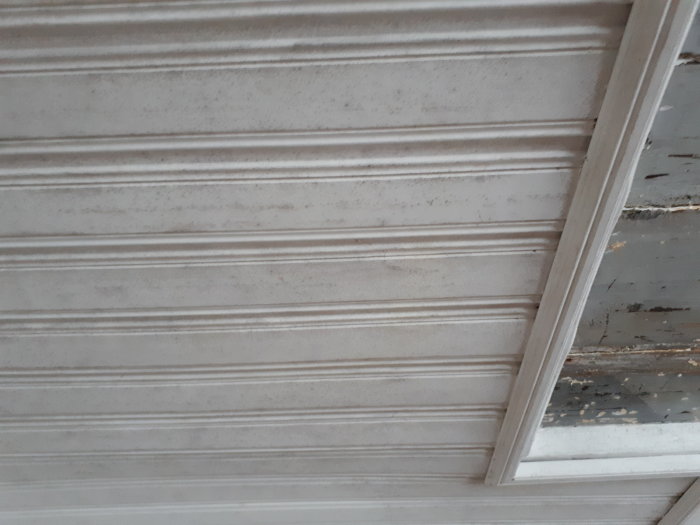

I have just moved in to an older stuga.

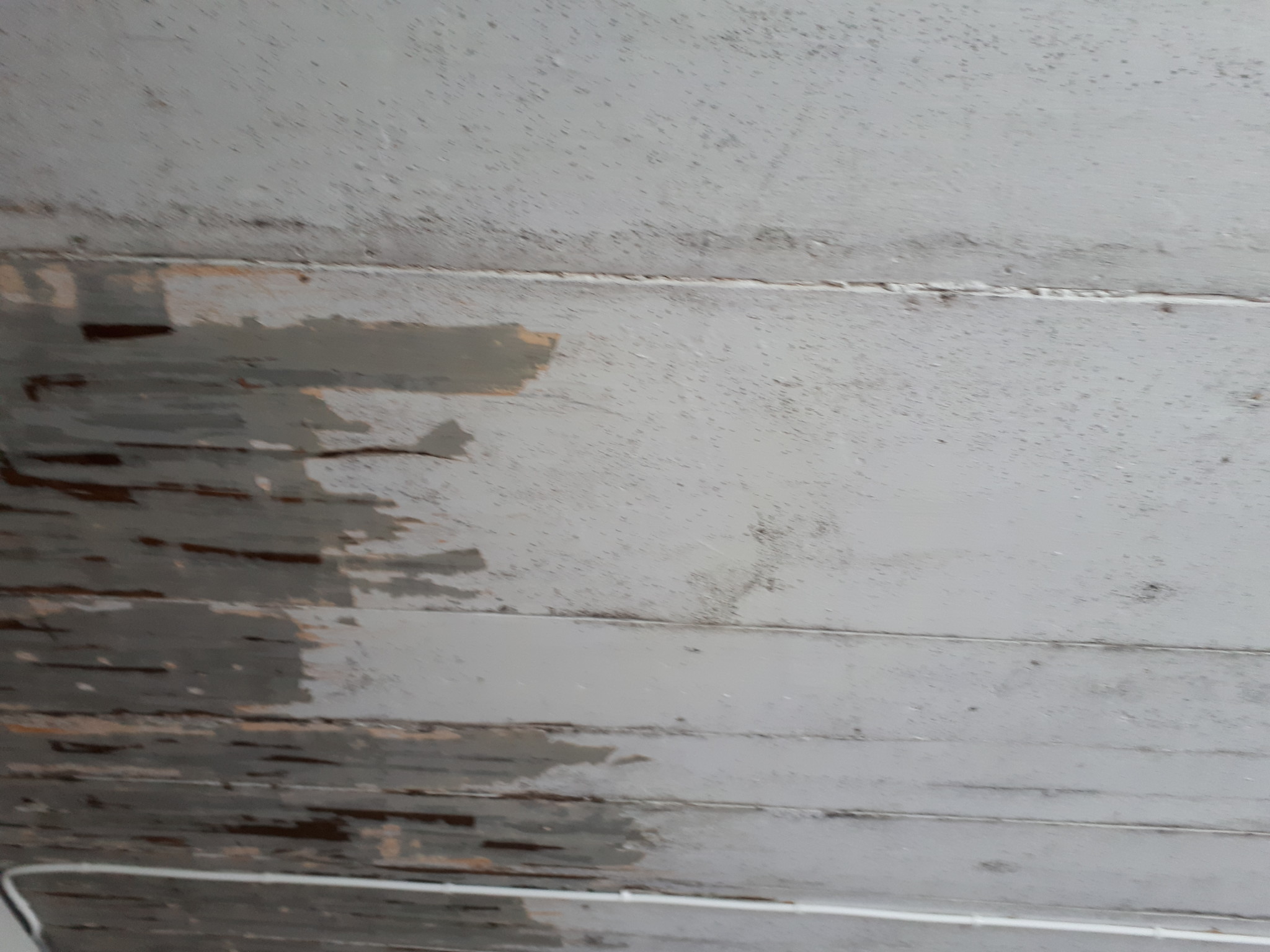

I have noticed that in the vardagsrum, there is mould on the paint on the ceiling and above the windows. The people who were there before me had started scraping it off.
I would like to continue.
I have no experience with doing this, and I would very much appreciate some advice
Do you think it is ok to continue scraping off the paint in the wintertime ?
Is there anything specific i must do whilst scraping off paint that has mould ?
Is there a specific product i must apply on the scraped surfaces afterwards, before repainting ? I ordered some linoljafärg for the repainting afterwards.
Thank you very much for your help!
I understand Swedish well, so no problem to reply in Swedish

Hej, först och främst måste man undvika att mögelpåväxt inomhus uppstår. Det gör man med att se över sin ventilation och uppvärmning
Att skrapa är nog mer för att ta bort färglager. Skall man bara måla om så använd något medel för att avlägsna mögel ex.
https://alcro.se/produkter/alg-mogelmedel
