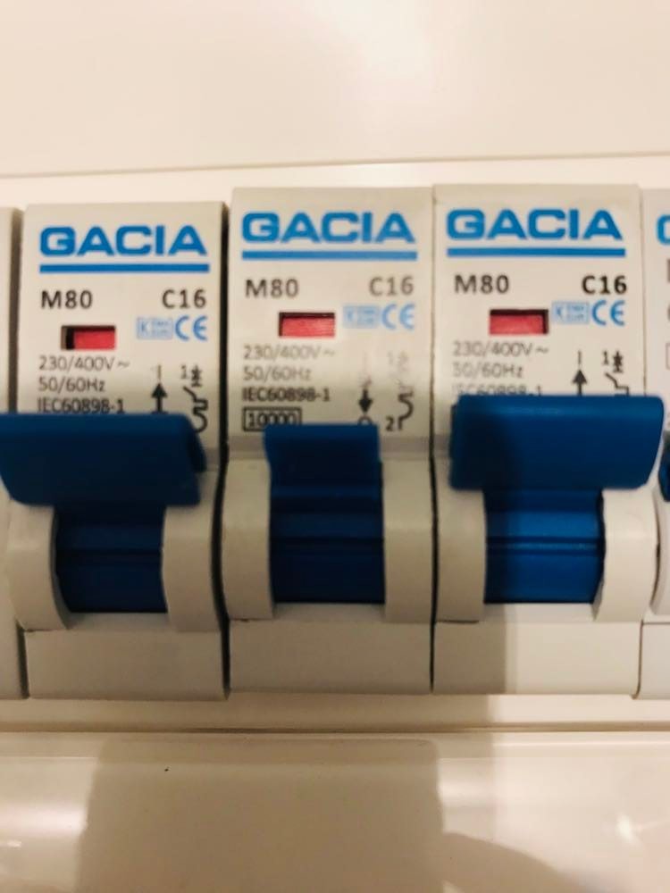

I have tried now for hours searching online, but I just cannot find where I can buy a 5G Perilex plug with a cable in Sweden (Stockholm area), but 2.5mm.
I have tried searching everywhere, but all I find is 1.5mm. My new oven's manual specifies that I should use 2.5mm.

If you have 16A fuses for the oven (most likely) you can use a 5g1,5 cable. It's the way we usually do it in Sweden.M mburazin skrev:Hi everyone,

Thanks so much for the quick reply!Mikael_L skrev:
This is a photo of the 3 fuses that correspond to the 3 phases that lead to my outlet that connects to the oven. Just tested using a multimeter. C16 means 16A, right? So I should be good to go ?
