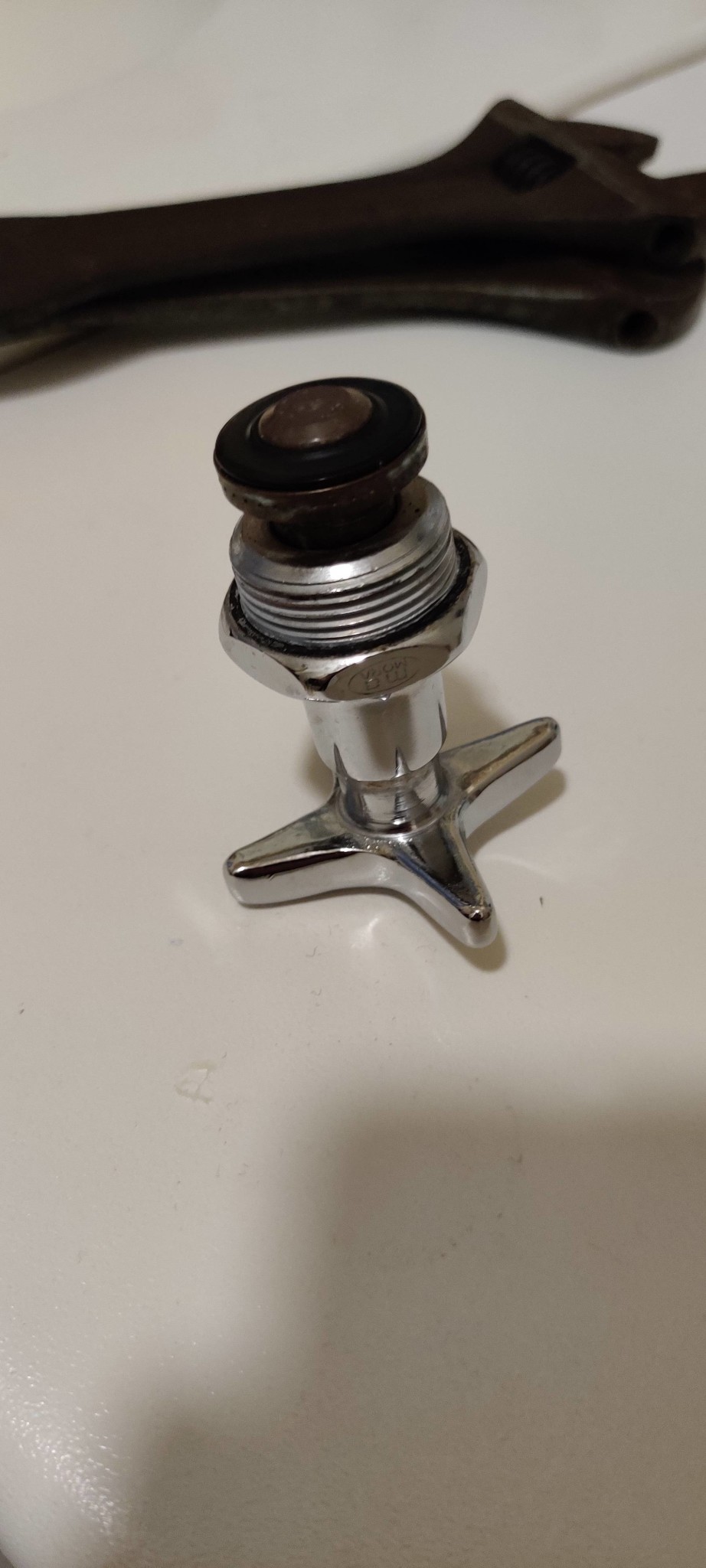

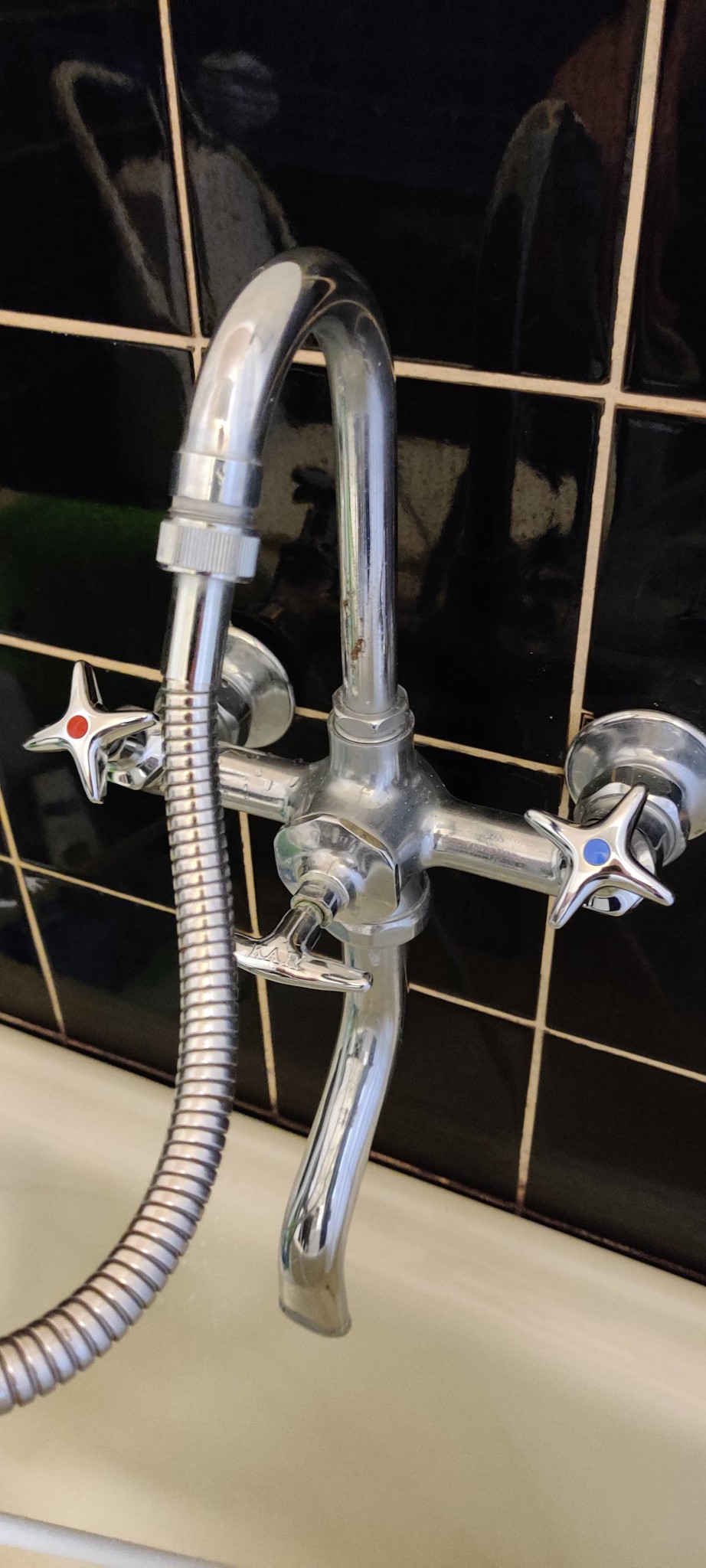

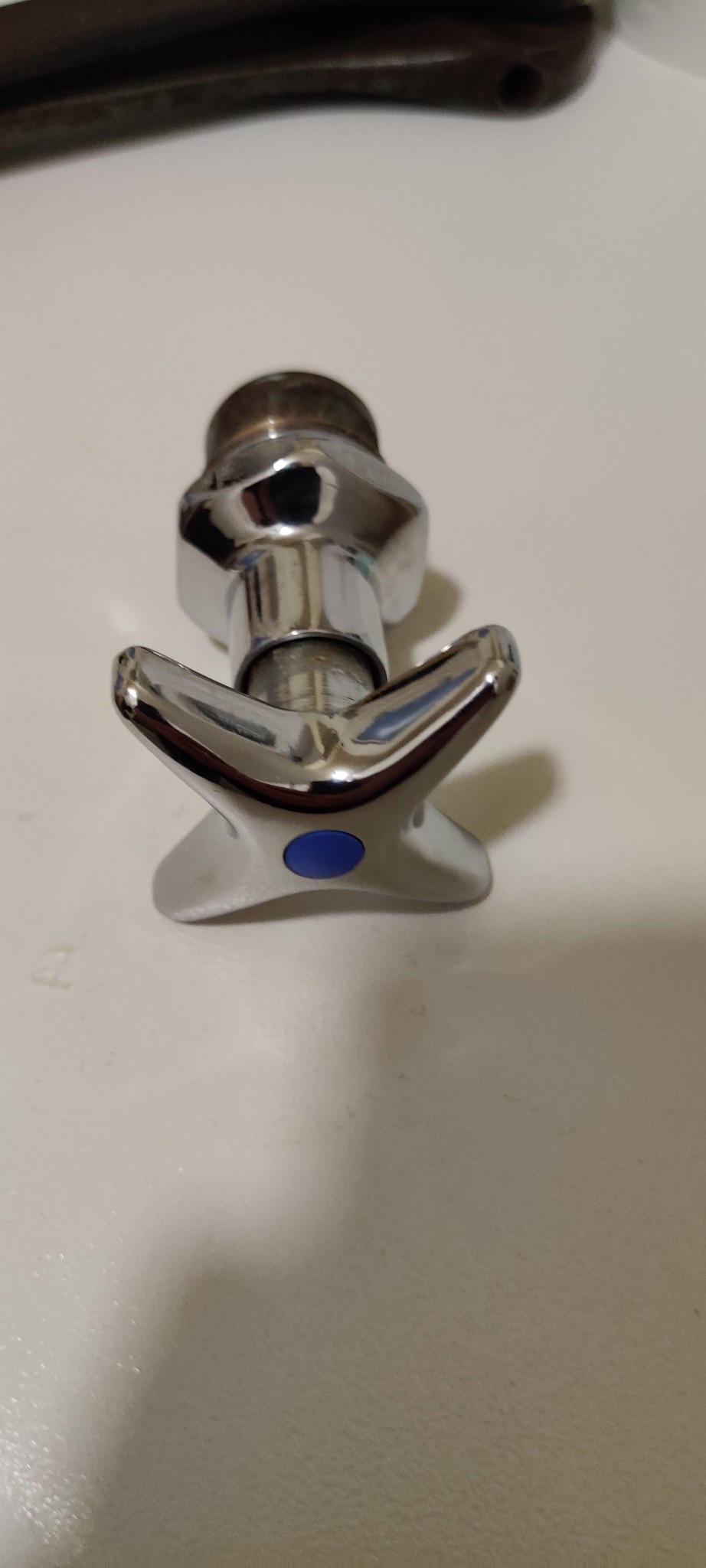

James 1
It drips constantly! It's marked as a Mora but not sure which valve seats to get and my local VVS parts shop closed :(
Thanks for any suggestions and it's totally OK to write me in Swedish!

Har den droppat länge räcker det inte att bara byta packning. Du måste brotscha botten också. Dimension på packningen kan jag inte.

I figured they were very brand-specific but I guess I'll just pull one out and take it with me to Clas Ohlson or Bauhaus. Thanks for the help!
Ulltand
No I dont thik they are brand specific.
Normaly it works fine just to change them without any other action.
