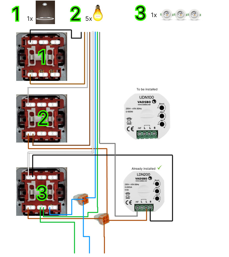

I need some help. I want to install a Vadsbo dimmer.

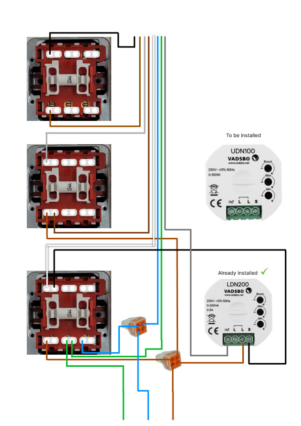

Here is the image on how the cables are connected now. I only have power on the green circle. This switch only turns on the light above the table)

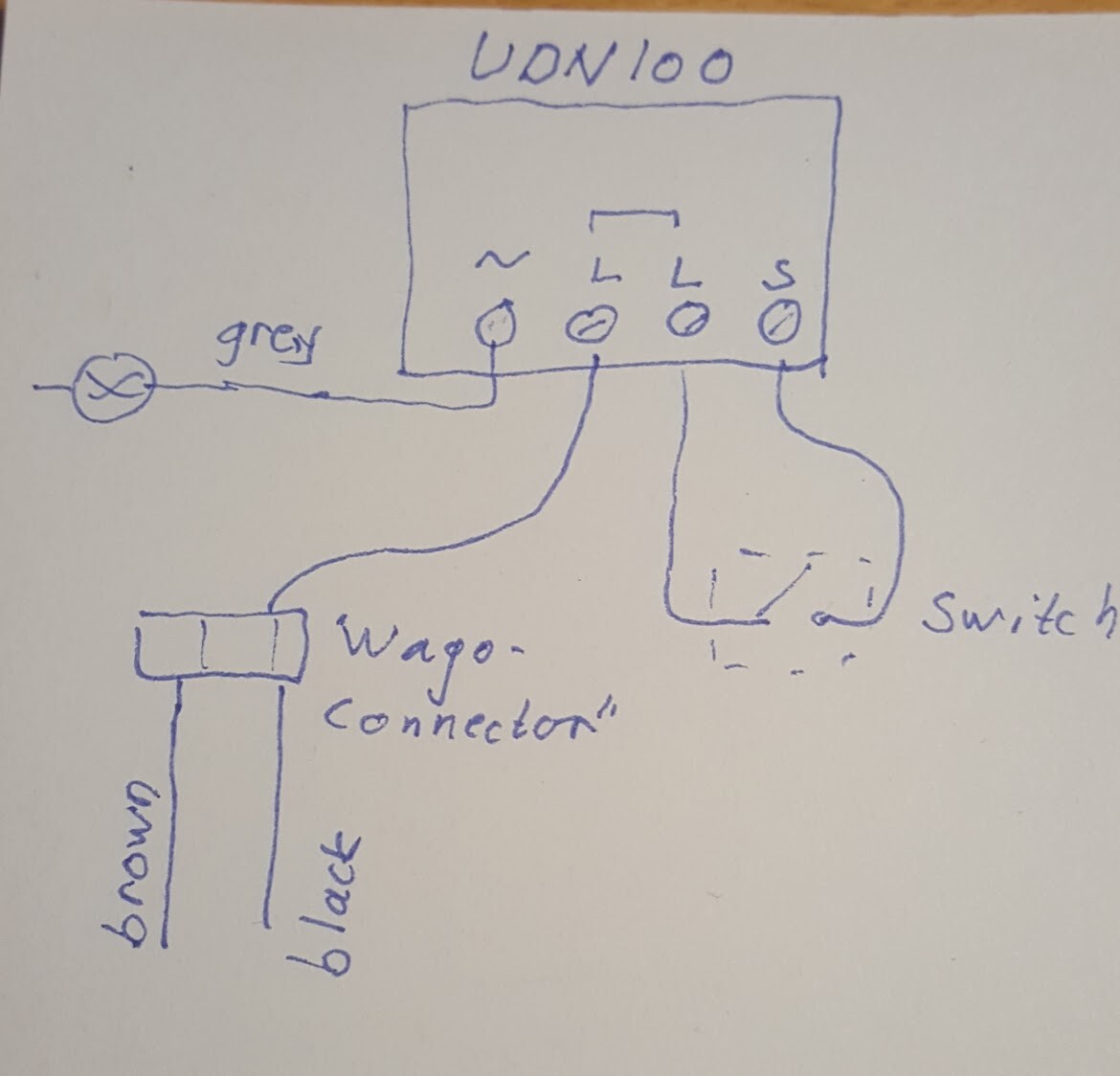

This is the images of how I think it should be connected.
Any help is appreciated
Thank you.

I am planning to use the UDN100 with 5 x 4,5w dimmable lightbulbs.zanu skrev:

What is the White wire that is connected to the same connection as black on the switch?

If you connected as your first picture and testetd. Then the dimmer is probably burned.

And how does that compare to the connection diagram of how it should be connected?
Exactly how does it not work? Dark or lights on all the time?
