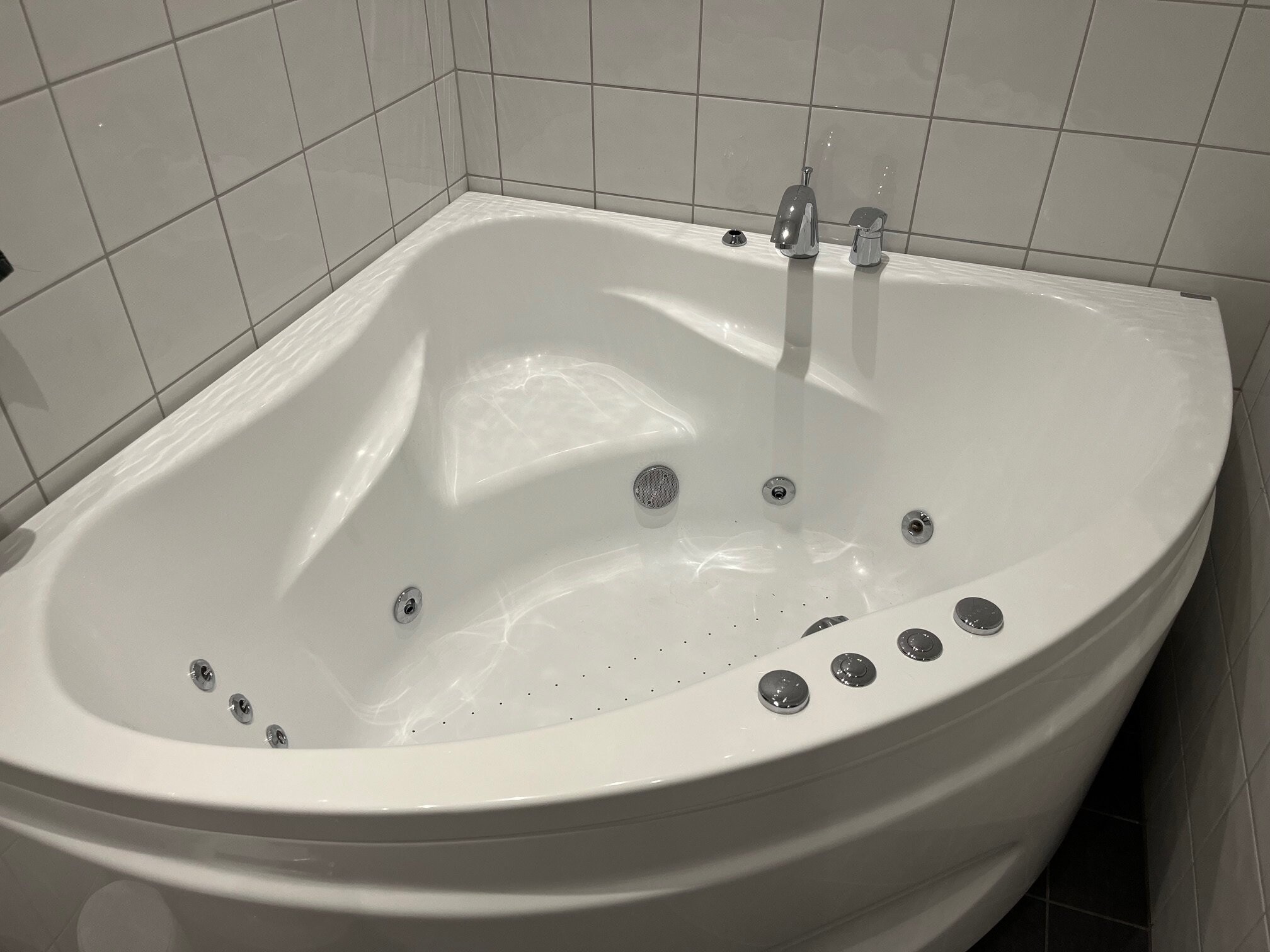

Jag har nyligen flyttat till en lägenhet som har ett bubbelbadkar i badrummet. Tidigare ägare har inte sparat någon dokumentation och jag har ingen aning om vad det är för modell eller hur det fungerar. Badkaret är märkt "PoolSpa" och jag har kontaktat Poolspa entreprenad och det är inte rätt företag. https://poolspa.se/

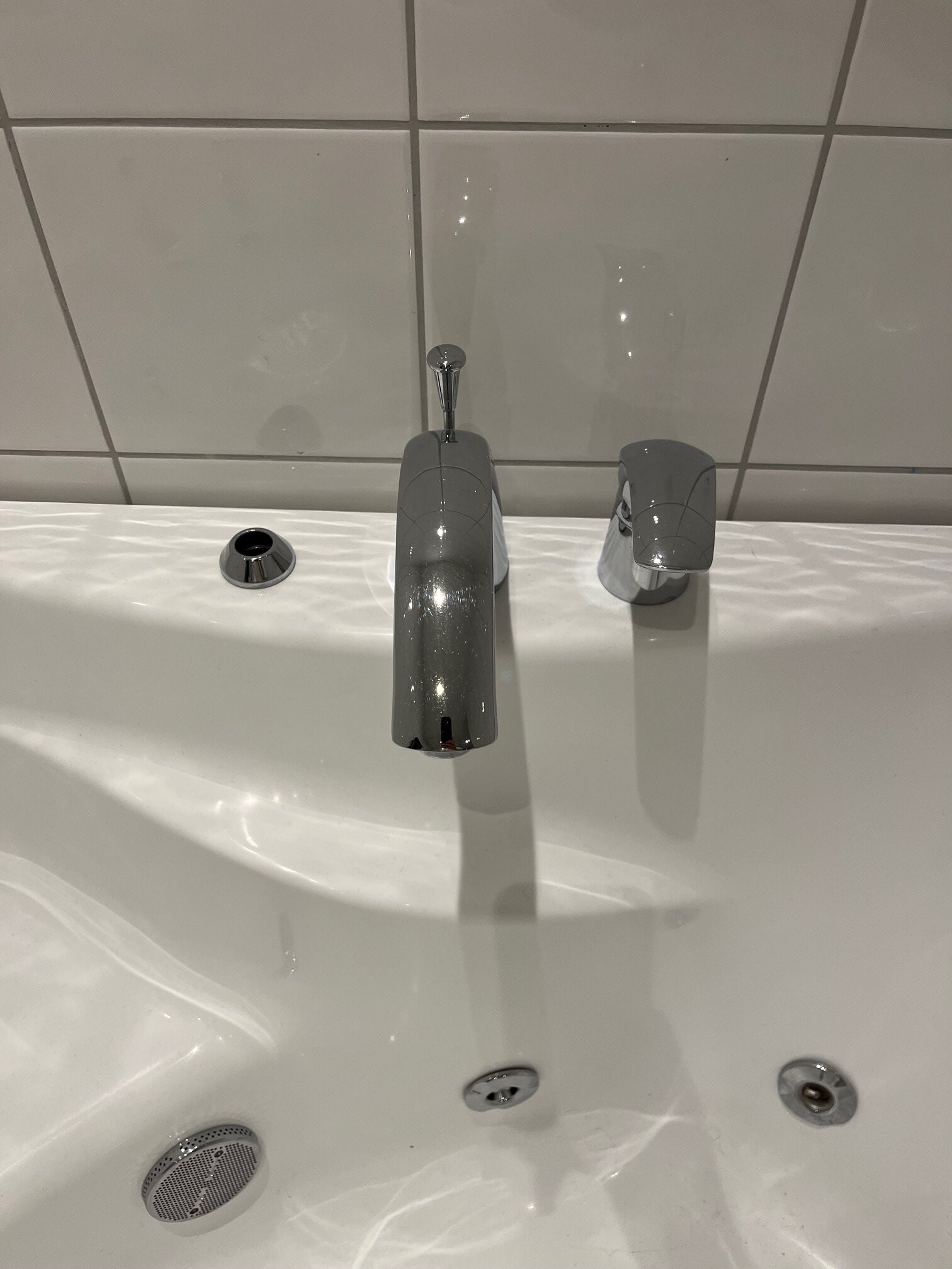

Jag tror även att badkaret saknar ett duschmunstycke som ska sitta till vänster om kranen.
Någon som kan identifiera badkaret?
  • Bubbelbadkar i hörnet av ett kaklat badrum, märkt "PoolSpa", med flera jetmunstycken och kranar, saknar eventuellt duschmunstycke.
  • Bubbelbadkar med en kran och en plats för duschmunstycke, märkt "PoolSpa", utan tydlig modellidentifiering.

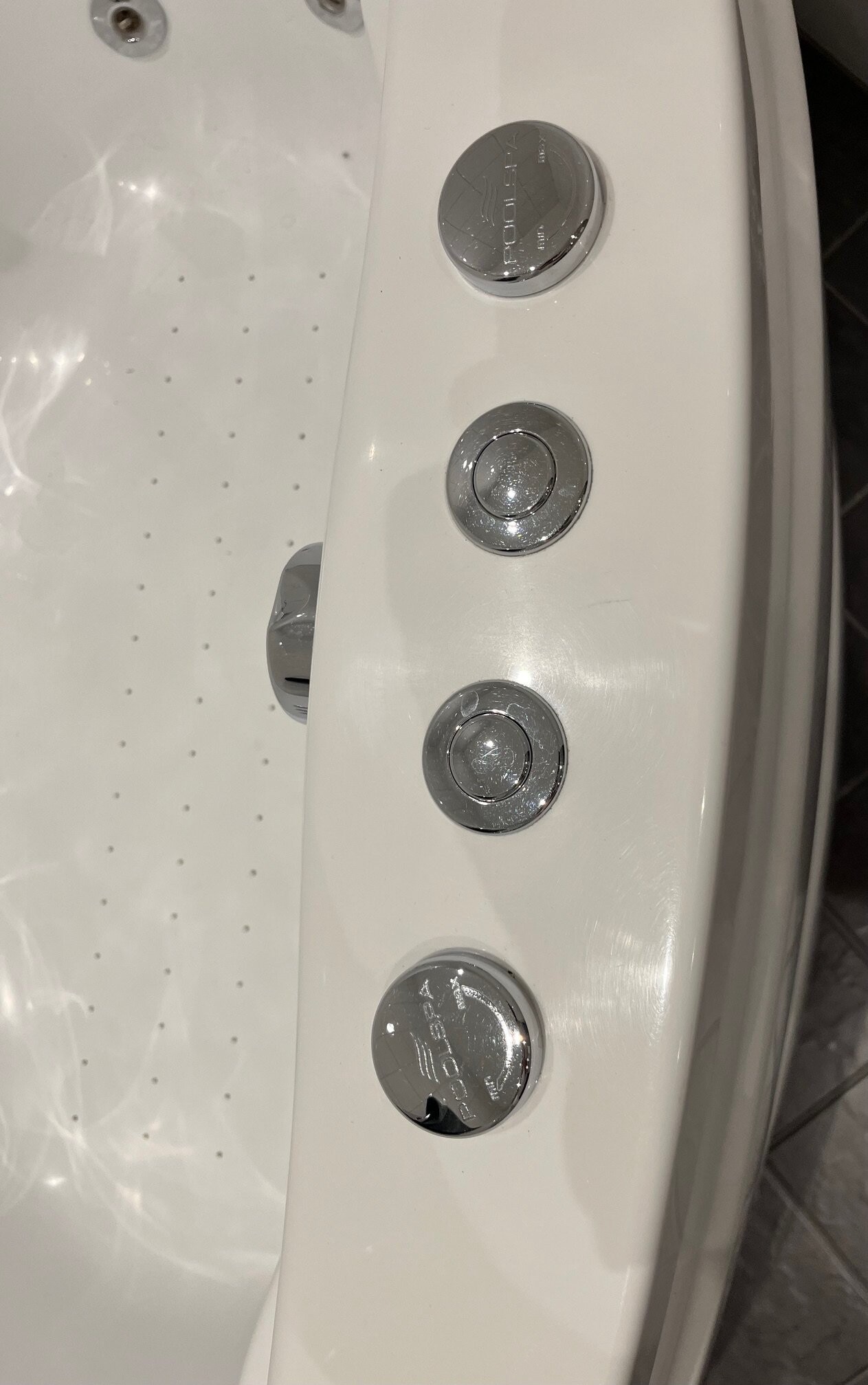

  • Kontrollpanel på bubbelbadkar med tre kromknappar, varav en märkt "PoolSpa".

Yes. The company is located in Gryfice, Poland. It now belongs to Roca. It used to have a representative office in Stockholm on Arsta. I worked there, and my company also provided services for them. My first visit to Sweden was related to this. Building a trade show stand. I also designed several hot tubs for them. Yes, you're right about the lack of a shower, but I suspect it's sealed under the tub. Pool-Spa, or rather Roca, as it's their only brand now, probably won't help you. Around 2000, after a change of ownership, the new owner started installing their own versions of controllers and accessories. It seems like a simple system. I think it was called System 2. It consists of two pneumatic switches, if I remember correctly, one for the hydromassage pump and one for the blower. And two knobs for adjusting their intensity. I can't promise anything, but maybe I have an electronic version of the multilingual manual (also Swedish) somewhere (but when I back to Poland), I making the leyaut this manual. But onlu maybe....

Many thanks for the help! Very valuable information.
I have made an attempt to get in touch with Roca but it probably won't lead anywhere. My bathtub was installed around 2010. I would be very grateful if you could find some kind of manual. I would like to disassemble parts of the tub to see what has happened to the shower head.
The front panel is mounted (at least in my day) on springs. To remove it, simply press it down and slide the top panel outside the rim of the tub.
