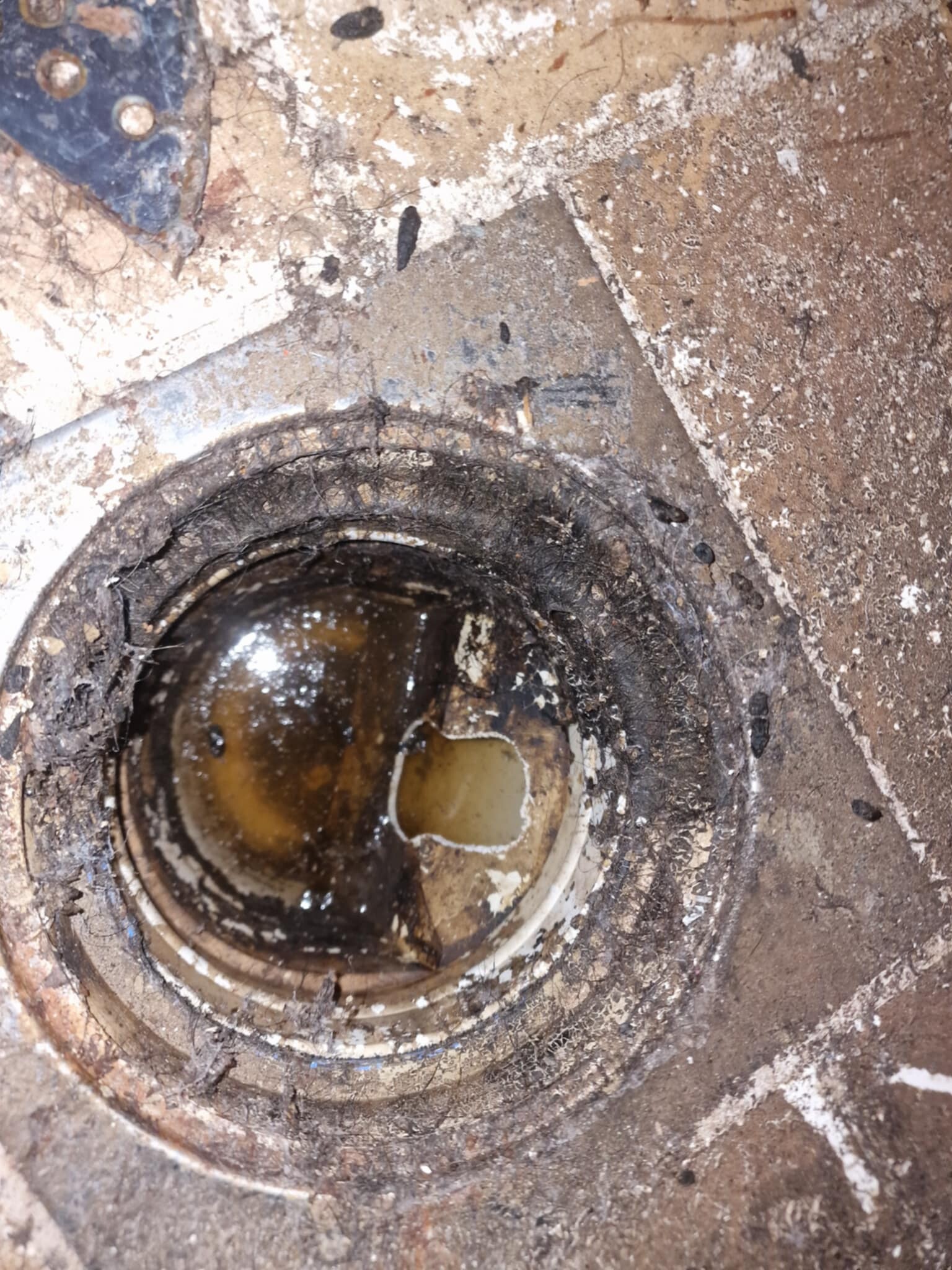

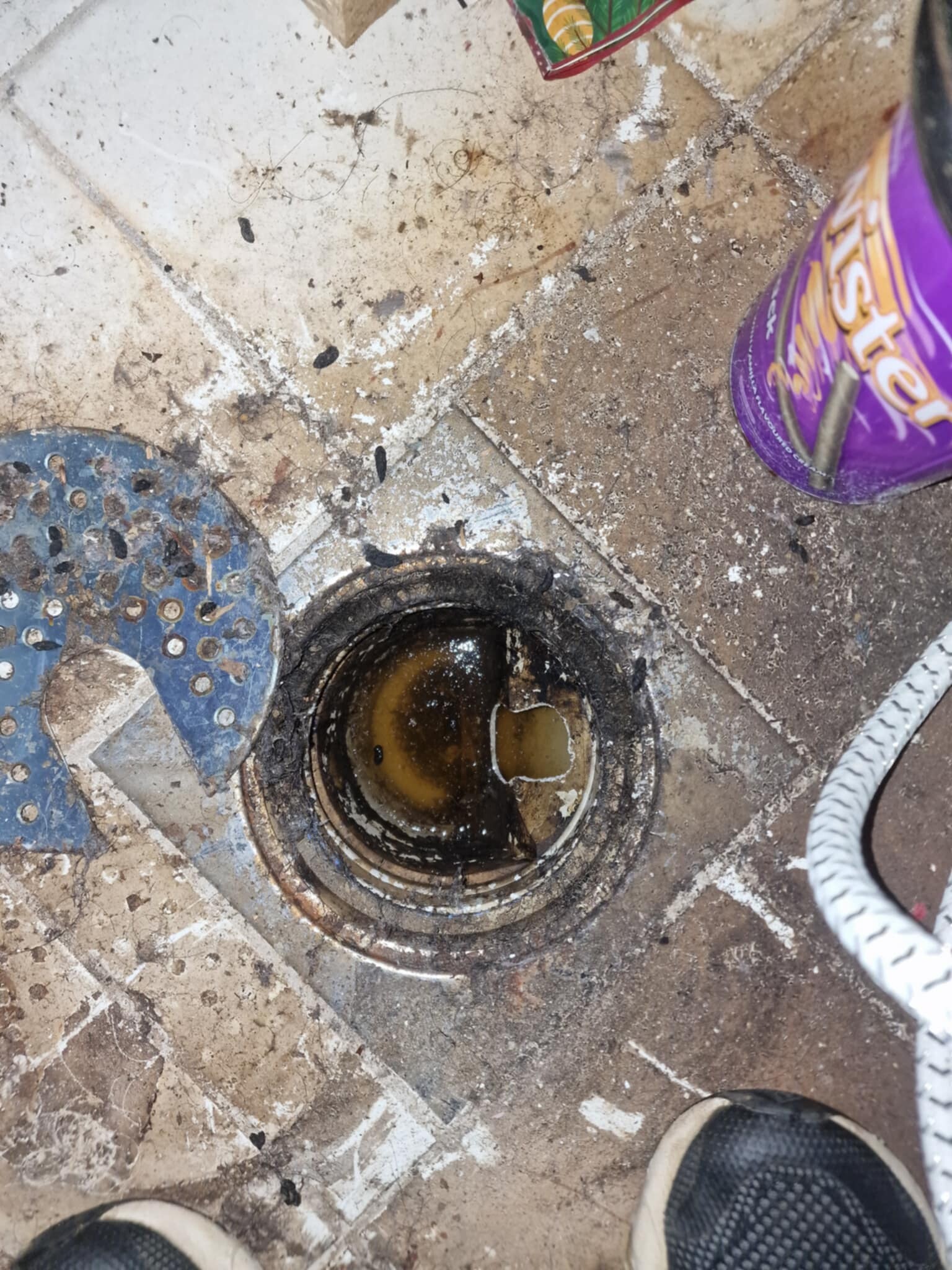

We were using a Shower cabin. Now thinking to change as Duschdorr. The drain looks like this. And I wish to have a hair filter so that its not going into the drain. Any suggestions please?
IN SWEDISH:
We used a shower stall. Now I'm thinking of changing to a shower door. The drain looks like this. And I want a hair filter so it doesn't run down the drain. Any suggestions?

What you are looking for is called a Golvbrunnssil, basically just a circular piece of chrome with small holes that will allow water flow and keep hair from falling through.
Normally they come in 10, 15 or 20cm and should fit whatever drain you already have.
I advise you to deep clean your drain and carefully lift up the bucket trap inside. Just use soap and hot water with a dish brush or sponge.

Big hole in the "water lock" ?
No smell?
