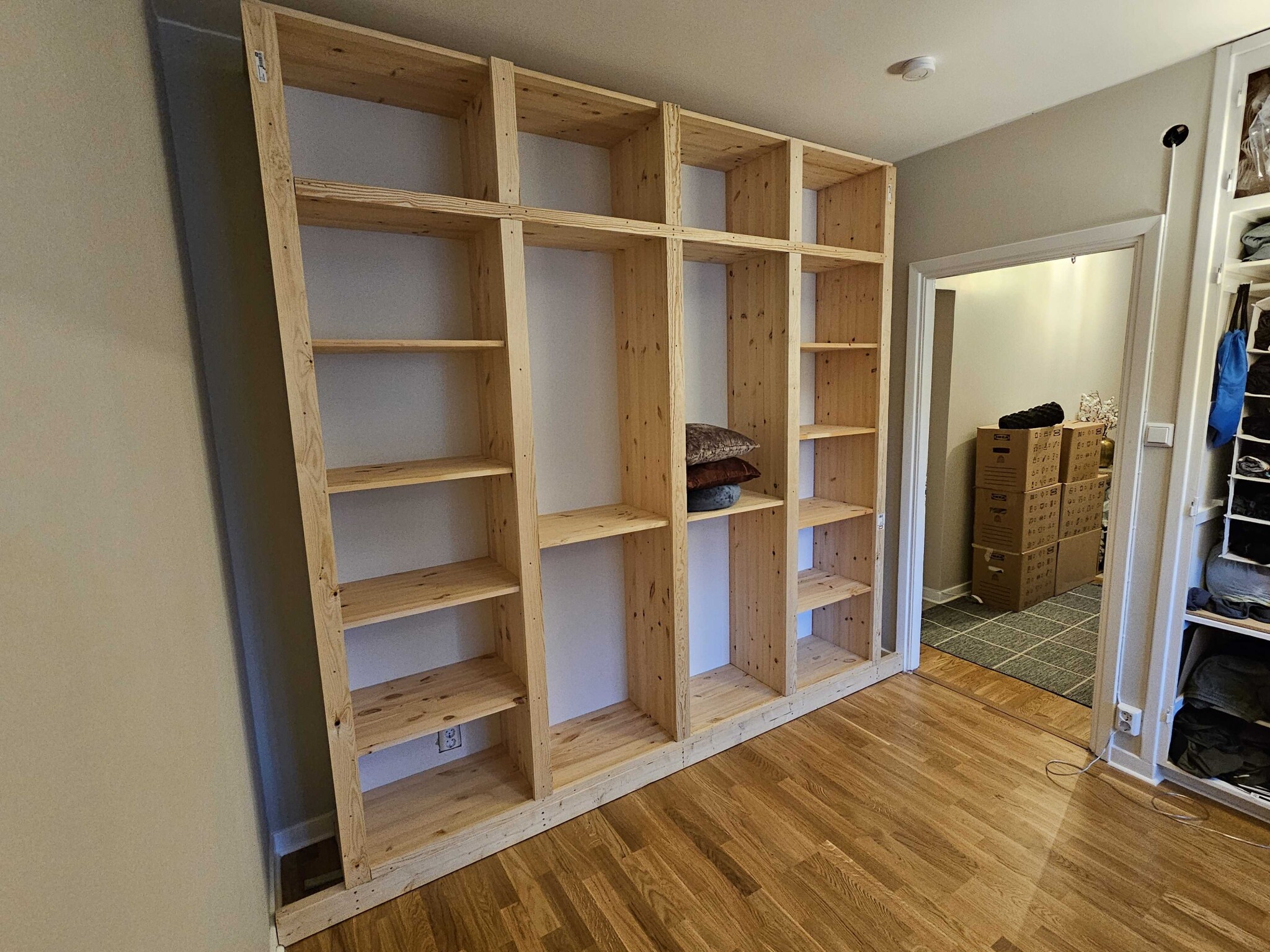

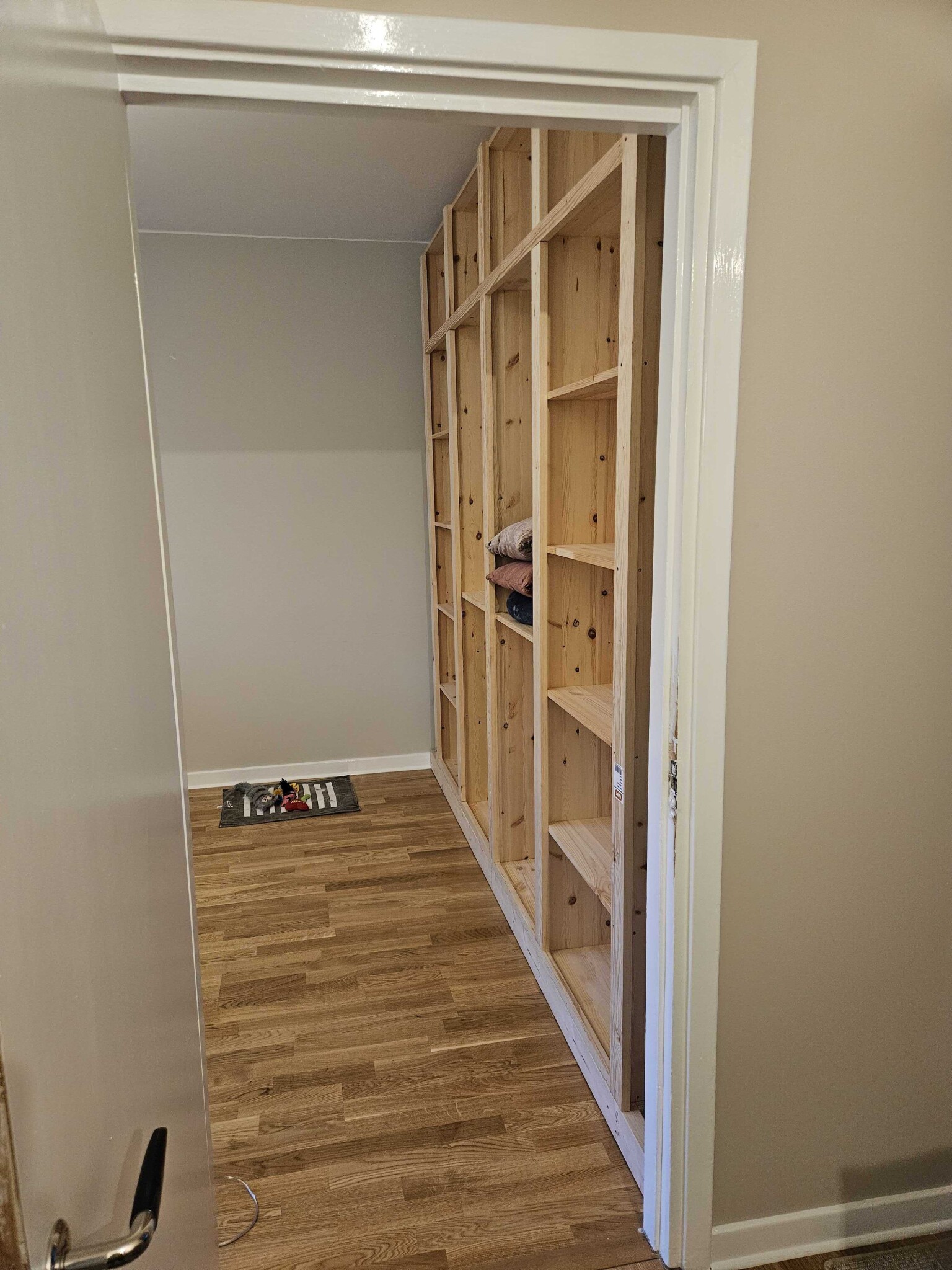

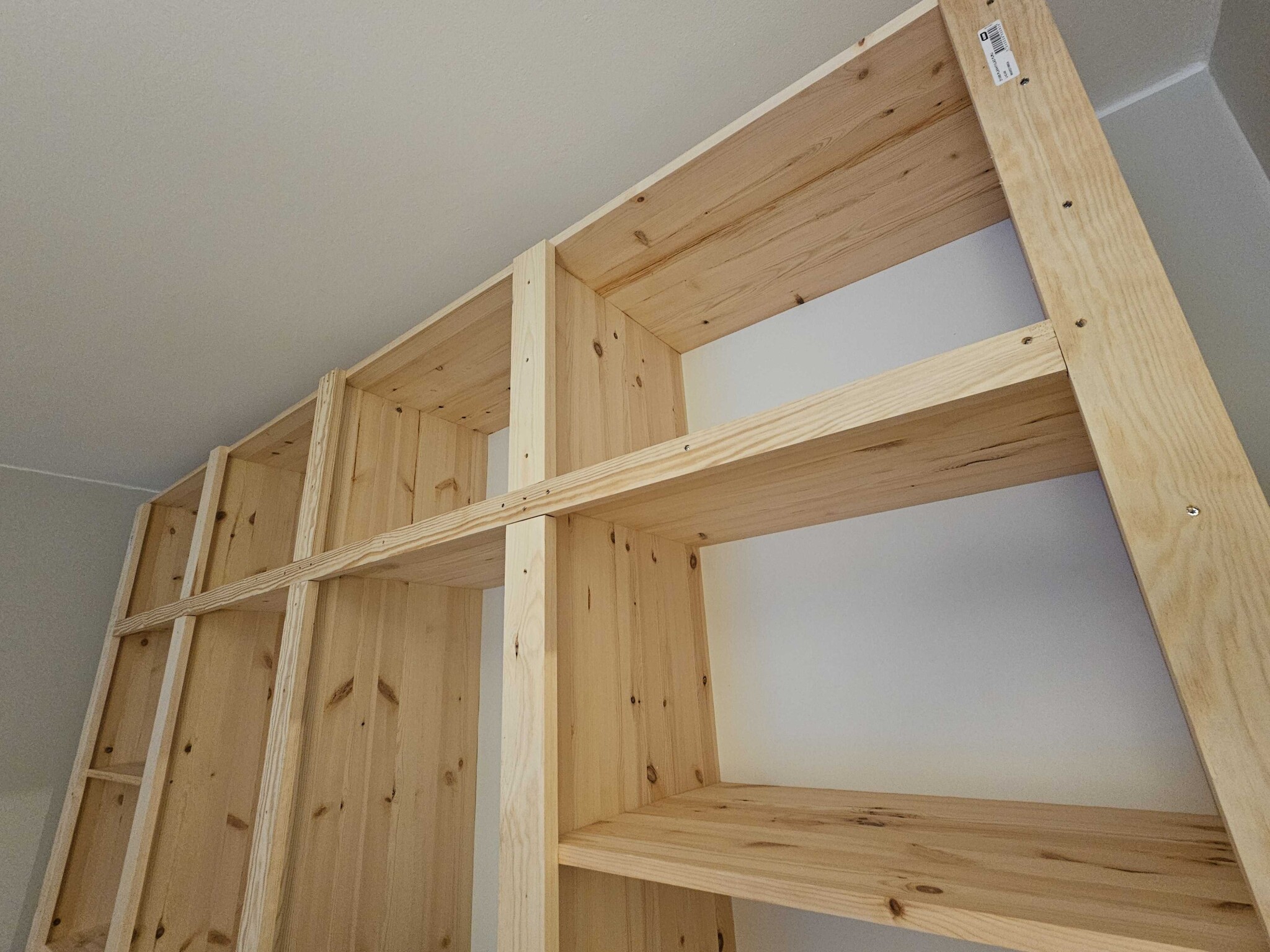

I need to build doors to a wardrobe that I built and there are some nice references in this thread. I did think about doing the wardrobe with small planks and plywood, but it felt too complicated so I just built it like this
I turned out OK and the building is still standing with the extra weight.
I used 18mm boards and 21mm planks on the front. Now I just need to plan how to do the doors and fill the empty space around the wardrobe. I might ask some questions if I can't figure something out, but I'll post this here anyways
