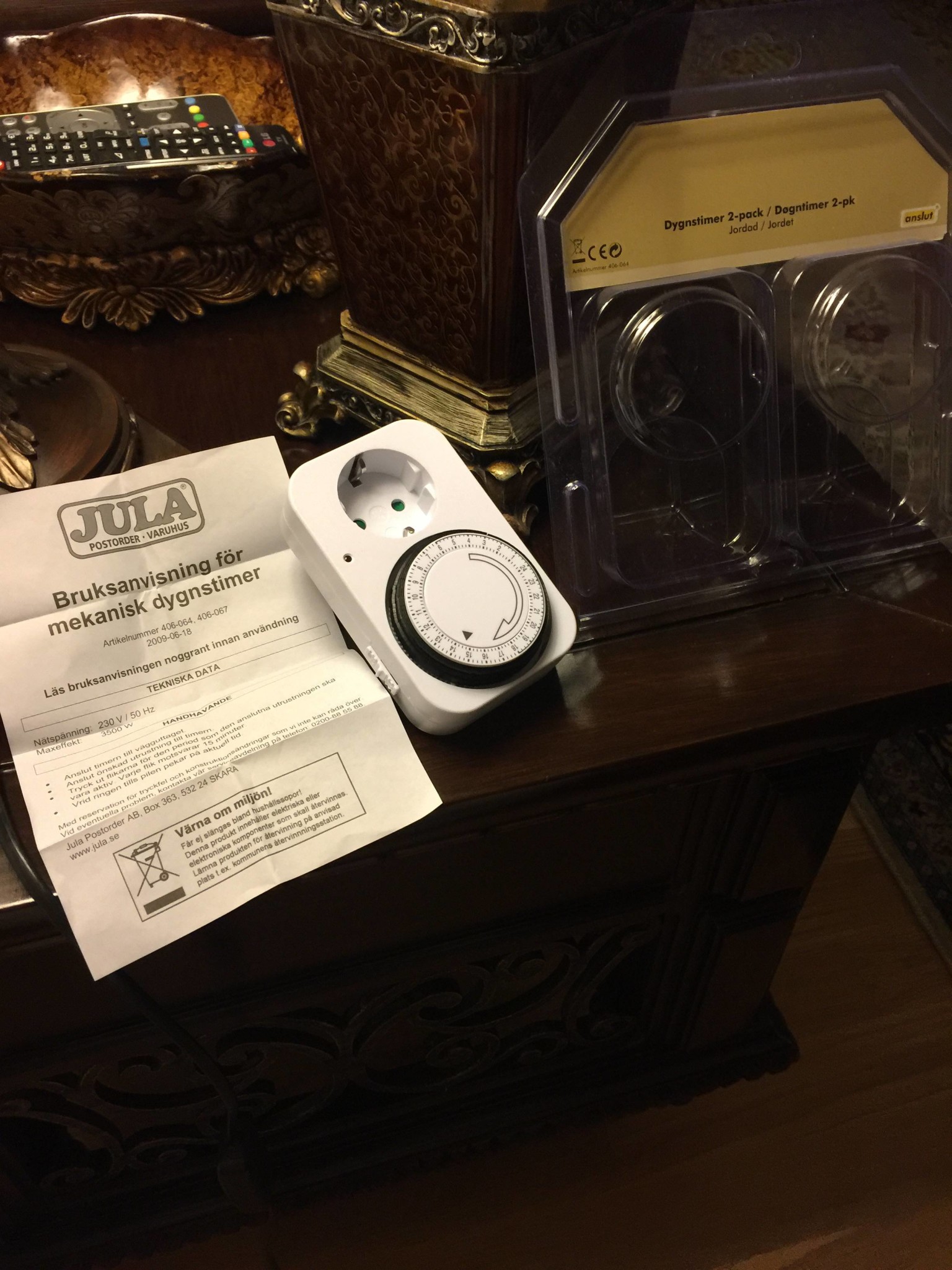

Manal #1 Medlem · 1 inlägg 29 nov 2017 20:04 Manal Medlem 1 inlägg 29 nov 2017 20:04 #1 Can someone Please help me in starting this timer for My lamps , I can not understand how to set it from 14:00 until 22:00 ..... your help is appreciated in anticipation Inloggade ser högupplösta bilder Logga in Skapa konto Gratis och tar endast 30 sekunder
N Noseone #2 Medlem · stockholm · 3 430 inlägg 29 nov 2017 20:30 Noseone Medlem stockholm 3 430 inlägg 29 nov 2017 20:30 #2 Press or raise the outer black nobs all the way between 14 and 22. Done.
