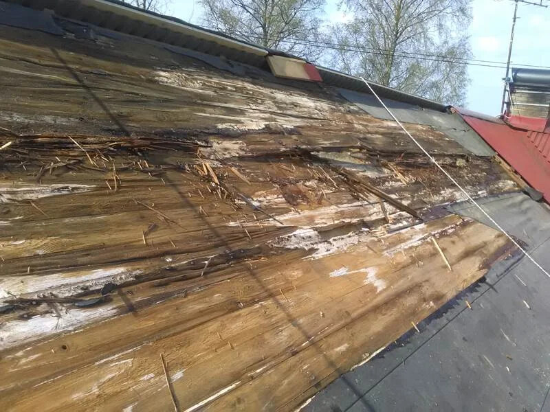

And you will avoid surprises like this roof on a 6-year-old house. Yes, its true. As you can see, even a relatively new home does not guarantee that you will avoid expensive troubles. Especially when the offer is a "bargain"A Arne_Planka skrev:

That should be discovered during the inspecion. Existing house have all the problems exposed and should be discoverable or fixed. New.. this can happen if you make a bad buildS sturnus skrev:
