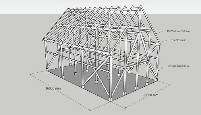

Här en modell på dimensioner som kan vara aktuella.
Det syns på gamla lador att man visste att trä är segt och går inte av i första taget.
Nedböjning var inte så noga vilket man inte vill ha idag, vilket kräver betydligt kraftigare dimensioner.

Sorry but I have to write this. I don't know who taught you how to design beam structures, but yours would collapse at the first significant side wind. There is also no full stabilization (roof) in the longitudinal direction. Horizontal longitudinal beams in the middle limit the use of the full height of the structure without giving anything. Also, spacing the posts every 2.5m makes no sense. But it's nice to see a pretty well done project in SU
Point taken.
So lets make the perfect barn construction together. I can make the drawings according to your directions and expertise.
