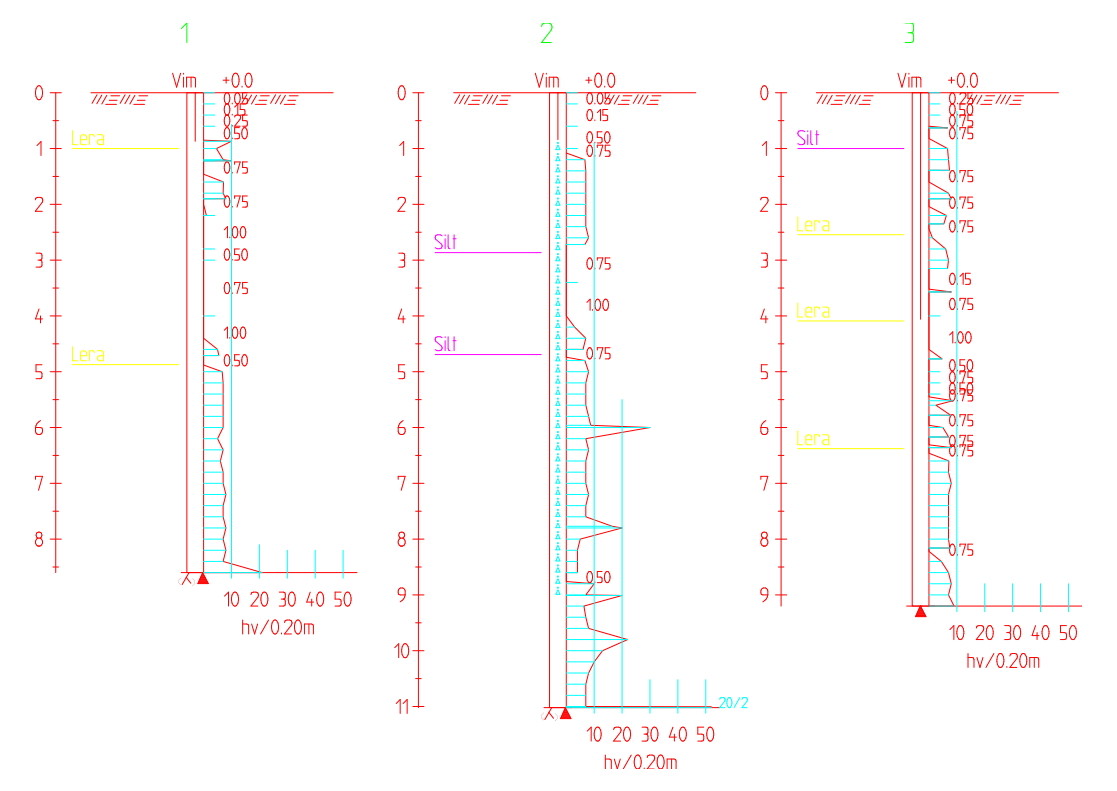

If there was a driller on site which checked the status of the clay, shouldn’t the results from the measurements be in the report? Or maybe you just got a summery? Cause you cant design piles based on the info you have provided.A aksgir skrev:Yes just across the street there is a mountain. I can see a little rock in the middle of my tomt also but not sure if thats part of a mountain or is just a rock.
Survey was done with a machine and the guy had computer on his machine to do some sort of geo measurements and he said they dont need to take any clay to send it to lab. Since their system measures everything while drilling in.
Neighbors did do geotechnical and didn't find any problems with the soil.
Was there only one drilling hole or did they check in different locations of your site?
If your neighbours did a survey, it probably will tell why they did not pile. Maybe closer to rock? Maybe they dug down? Maybe smaller house? Or the clay actually is better there.

Does the report mention anything about the value ”cuk”(undrained shear strength of the soil)? If not, the piles will be designed with a very low value of the soil. This value determine how ”strong” the pile is. For a ordinary house the total cost of this assumption is negligible since the loads are often very small.
This is the only report I gotB bossespecial skrev:Does the report mention anything about the value ”cuk”(undrained shear strength of the soil)? If not, the piles will be designed with a very low value of the soil. This value determine how ”strong” the pile is. For a ordinary house the total cost of this assumption is negligible since the loads are often very small.

I think its all in order, however its strange that the report doesnt contain the data from the measurements of the soil parameters - since they obviously have determined the soil as lose and much lose clay (which is dependent on the value cuk). The number of bore holes also influence how large load each pile is allowed to carry, so this information is also of importance when designing the piles. But if what @bossespecial said is true regarding the utilization of the piles, this might not be so important in this case.
I will ask the Geo Technical company to provide the more detailed report with parameters.P patrikd84 skrev:I think its all in order, however its strange that the report doesnt contain the data from the measurements of the soil parameters - since they obviously have determined the soil as lose and much lose clay (which is dependent on the value cuk). The number of bore holes also influence how large load each pile is allowed to carry, so this information is also of importance when designing the piles. But if what @bossespecial said is true regarding the utilization of the piles, this might not be so important in this case.

Ask them to give you the value cuk.
Atleast now we can see that they did 3 holes, which is good.
Though they have noted silt in the drilling results yet its not mentioned in the report under ”jordlagerföljd”.
Not used to interpret these results though, but I would guess that it id the results of a ”vingsondering”.
