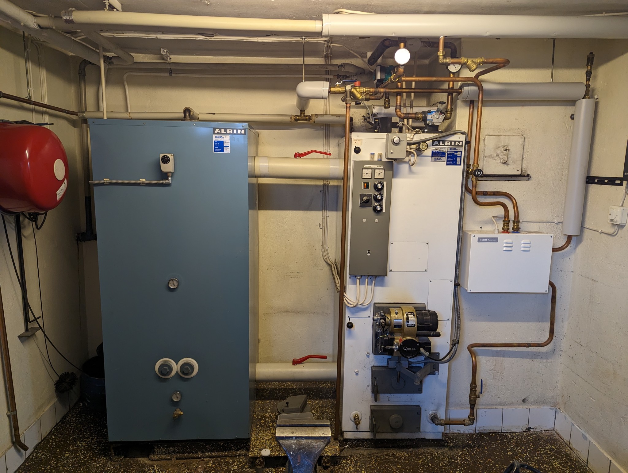

Attached is a photo of the system. If anyone can point me towards cartridges to fit in the accumulator -- i've seen both bare ones and built in thermostat ones. I'd be very grateful

About a year ago I got the same idea as you. I found out that I would need 3*500 liters tanks to store 90 kWh to be charged at 15 kW during 6 hours from 23:00 to 05:00. At that time the electricity cost was often very low during most nights but only some months later that changed a lot. I would have had to buy all the equipment needed but the total cost was not too bad at 40-50 kSEK.
The thread for heaters (elpatron) is usually 2 inch or R50 as it is usually called. You may need a heater with an inactive part (the outer part of it does not get warm). I don't know Albin, you have to find that information.

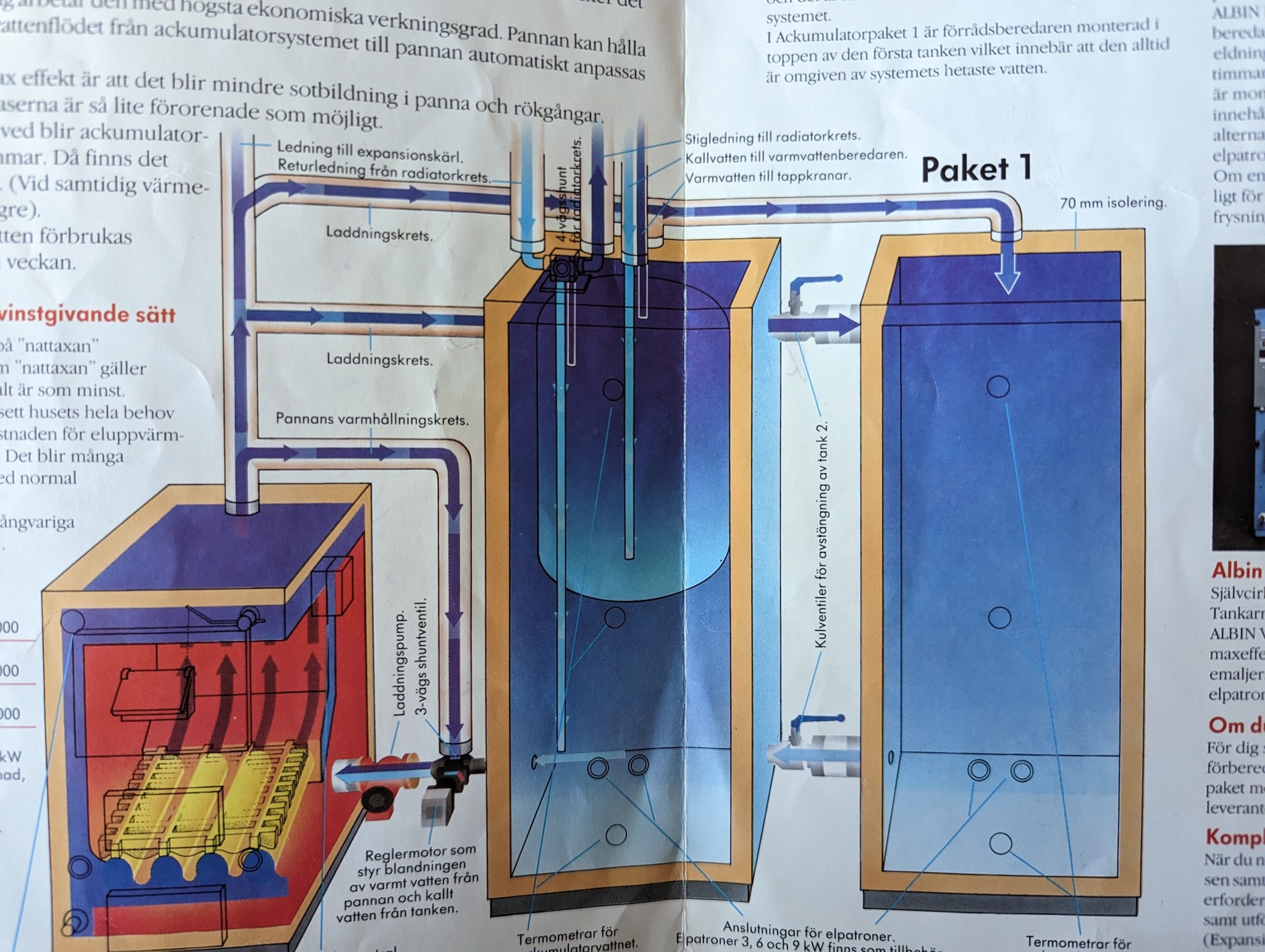

If you look above the right tank, you can see '70mm isolation' - So i think that is what I need to use as guidance?
I think this puts me in the inactive options - Looking at the size the total unit is 740mm wide, + 70x2mm insultion. So 600mm inside, and the non-active elpatrons are 480mm in length.
I wish I had a more 'proper' diagram' but the diagram on the back which shows the measurement implies the tank is using the entire space 'inside' the 70mm thick insulated 'box'.

Hi, Just an update for any future curious folks.
I've ordered the following:
1x 4.5kw Relek 'Inactive' Single stage elpatron
1x 6kw Relek 'Inactive' Single stage elpatron
1x Shelly Pro 4
2x Hager 400v 4-pol contactors
The heaters will be inserted into the accumulator tomorrow while the system is emptied to do other work aorund the system (A few old cast iron radiators with non thermostatic valves).
Monday we will begin the full rewire + new panel of the house. My hope is to have the bits and pieces here to work out an install by the electrician during the rewire.
I *think* the best solution will be to mount a small box on the accumulator tank which contains the shelly + contactors with a new 3phase run to this box (Or use the existing for the boiler). For the 230v coil voltage can either tap the existing line in the area, or I (think?) Line to neutral is 230 if Neutral is ran with the 3 phase run? The electrician knows of this plan, but trying to source the likely needed bits before Monday without bothering them. Worst case come monday we'll just have to make a plan when to do this wiring (or I go and buy missing bits during day -- like if an isolation switch is needed at the accumulator, etc).
1x Shelly Pro 4
We also had the värmepump fixed Friday (Sourced a local company - they were amazing. Hope to recoup the cost from polarpumpin via the ARN/Consumer rights..). With it working, this makes me feel even more confident to find savings. The boiler often wants to 'idle' at 3kw with it's dumb thermostat. Even ability to heat a few degrees above will ensure the boiler is 'off' majority of the day. As well for hot water, preheating during low periods.

So after some planning, and perhaps paranoia. Worked out a plan with the electrician during the rewire, that ended up with a second panel more full than the main panel just for this 'experiment'
A new 6mm2 was ran into the room, into a main breaker. Then 3x 16A 3 Phase breakers. One going to the original 'dumb' boiler/elpatron. The other other two individually going to a 40A 3 phase contactor, then on to the new 4.5KW and 6KW elpatron's respectively.
The shelly is behind a single phase 16A breaker to control coil voltage across the contactors.
I have the boiler's dumb thermostat set extremely low. So in practice it has yet to turn on.
In addition i've placed a half dozen DS810 temp sensors all over the room into an ESP32. I have outlet/inlet flows for the radiators, tankless hot water, accumulator pump, top of tank, etc.
I am still improving my code/logic but so far seeing positive results. Basically I generate a 'heating plan' based off future electrical price data, the current accumulator tank temp, etc. The goal to heat when the cheapest over a time period. I've created the concept of a 'Water Battery %' based off the observed peak temps, and the lowest 'usable' temps (can still take a shower), and build my automation/plan generation from this.
The individual radiators and upstairs heat pump also behave differently in conjunction with current battery level, heat plan.
Before this, it was normaly to see my boiler idling at 3kw (Very short periods of 0 heating), and if one took a shower atleast an hour or two at 6kw when the second stage kicked in. This meant, my floor was around 75+kwh/day consumption (3kwhx24hours). Most of my plans so far are around 4-6hours of heating per 24 hour period.
As the spring comes, I could see as little as 3-4 hours per day heating (To cover showers/hot water) -- We are just two adults no teenagers taking crazy showers yet
I am tracking my actual average cost vs tibber stated average. So far I am around 80% of the average cost -- but also about 30% less consumption.
