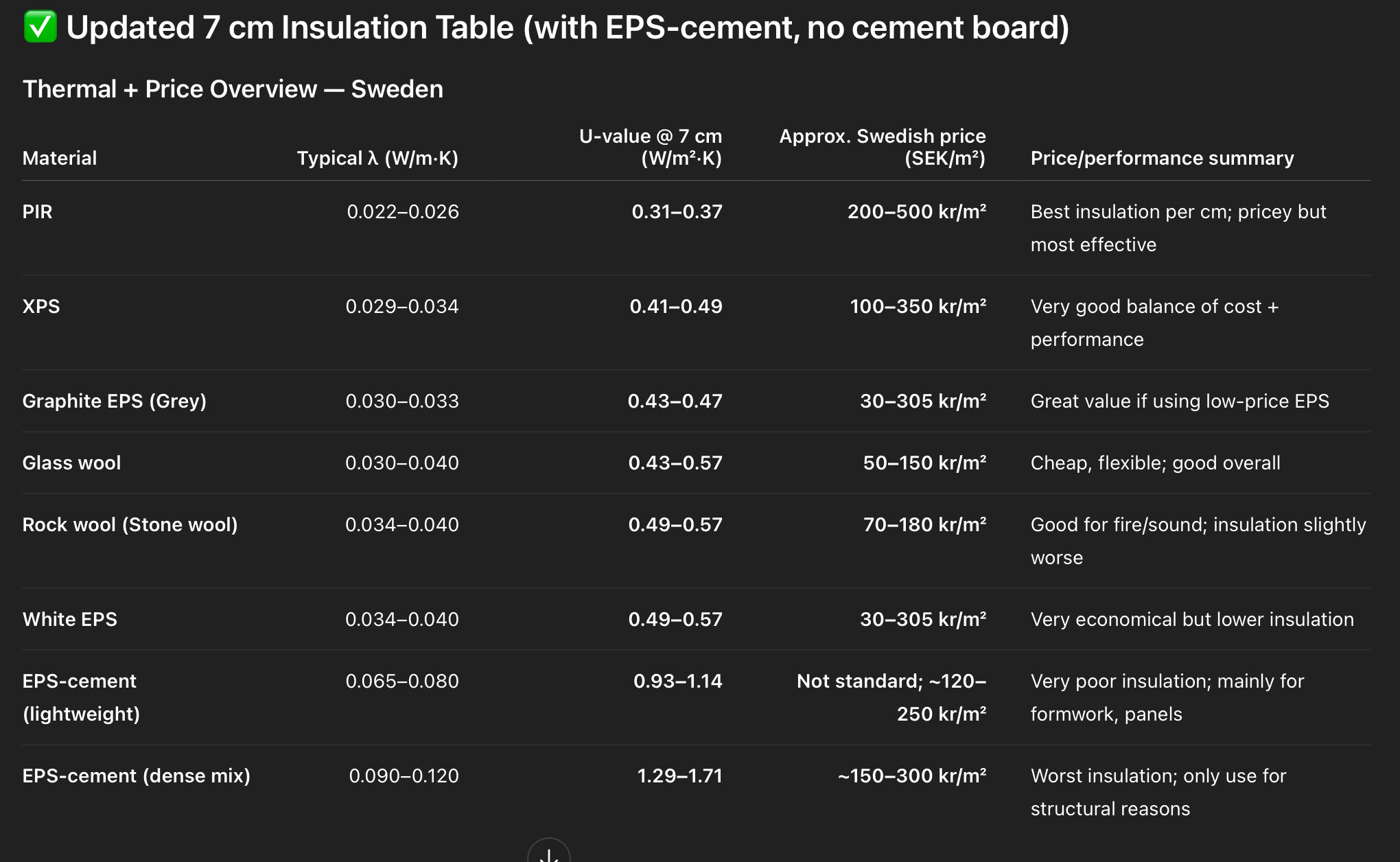

The difference between PIR and XPS is not as big as the difference between XPS and concrete. I was thinking the same when I was chasing solutions for my basement. In the end I decided to go with the simplest method for me which was EPS concrete.

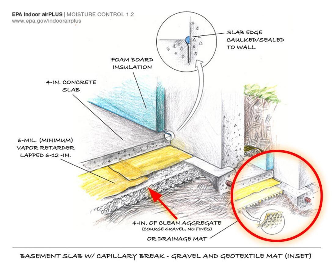

Our house is 69' and the inspector indicated that having that "linoleum" thingy on the slab is a problem, because the moisture is going to be trapped there. That's regardless if have "dranering" or not. I'd personally think about something that would allow the moisture to escape. It might sound crazy, but if you have those extra 10cm to spare, I'd go with a 70mm frame on the floor with 600c spacing, cellulose or wood fiber insulation between (because they can take moisture), tracked board on top ("spårad spånskiva") for your radiant heating pipe (and I'd probably even add some vent holes in the board) and your favorite flooring on top. Disclaimer: I'd just a DIY guy, no construction education whatsoever.

why I don't want to use EPS cement: I have attached a picture. why I think it could work, less room for error, quick and simple job but all that heat going down - what will happen with moisture are there any long term effects. I am not sure. although all material in this list transfer heat some more quicker than others.

@andreaskiesler, you are absolutely right, moisture is the biggest problems I also need to consider on how to handle. Here is my solution, instead of using plastic paper (byggfolia) I am going for platonmatta (ruffly I will lose 1 cm but gain much better solution)- this should allow the bottom concrete slab to keep and release moisture through out different weathers and get capillary break in-between (attached picture). and also bend this mat (L shape) in the corners on the wall 10cm maybe.
Of course all this is very theoretical, but logically it makes sense. what do you guys think?
