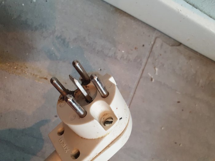

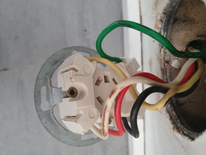

I am renovating my kitchen and have bought induction hob (trevlig) and inbuilt oven (smaksak without pyro) from ikea. I had a free standing double oven with integrated hob before. So the electrical connection is 3 phase (see picture).

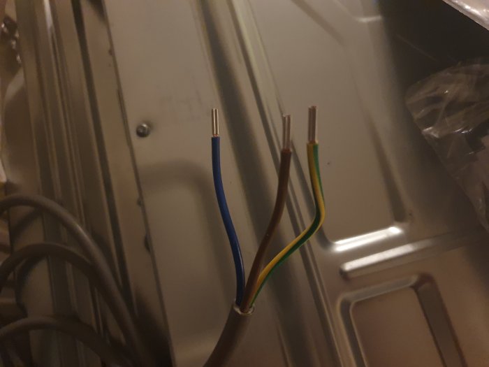

From the wires on the oven, it seems single phase is enough (see picture)

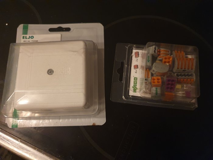

I bought WAGO connectors and have junction box.
So first question : do you think I can make the connections my self without electrician if I use the wago connectors.
Correct.
Only if you feel confident and can safetly identify that your socket outlet contains three phases, neutral and protective earth. And you need of course identify all five conductors. It is especially important that you identify the neutral and protective earth so that they are not mixed up. The colors used are old so you need to check carefully by inspecting both ends and measure voltages. If you only have basic knowledge as you say, I don't want to give you a procedure since you need to fully understand yourself that you are doing. Better to find someone that can.
Wago 221 or 222 is fine, not 773. I see that you have bought a mix. But the connection box on the picture is not really suitable since you also need to have a cable anchorage of some kind to prevent that the cables are pulled out of the box. A better choice is a "anslutningsdosa" which have all that built-in (so it replaces the Wago's too).
Vit anslutningsdosa med två vita kablar synliga, ej lämplig för den beskrivna installationen utan kabelankare.
You can also install two socket outlets and corresponding connectors on the cables from the hob and oven, but that is a little bigger installation.
Eluttag med flera anslutningar, två vita Wago-kopplingar synliga, i ett diskussionsinlägg om installation.
S sweind skrev:
if the wires from fuse box are 3 phase, and the oven wires are not, any risk with connecting them through wago connector ( together with induction hob).
No "if", you need to be 100% sure. I am quite sure that both the oven and hob is 230 V so they can be combined on the same circuit. But you need to assure that your connection box in the wall contains three phases, neutral and protective earth.
