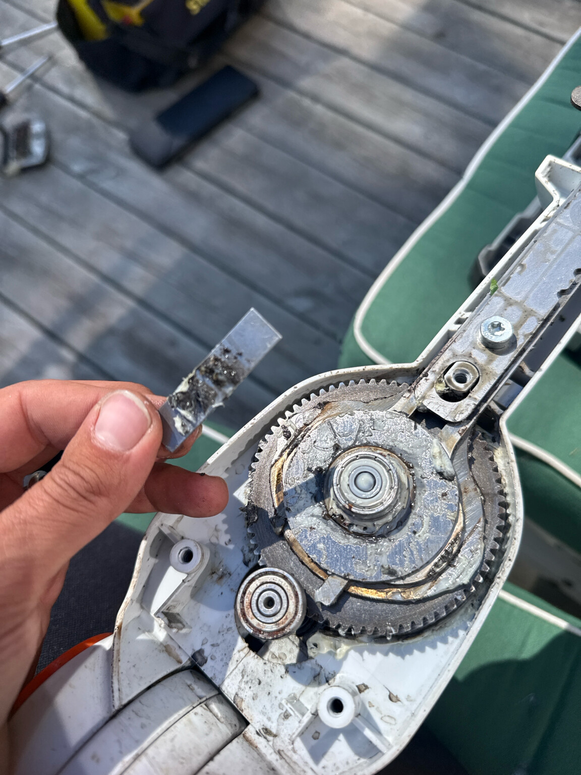

M miboy #1 Medlem · 4 inlägg 29 maj 15:12 miboy Medlem 4 inlägg 29 maj 15:12 #1 Was cutting a hedge, the blade got stuck on a thicker branch, was still hearing a ”click” sound but the blades refused to work. Opened the motor box and this part fell out. So have no idea where does it belong. Inloggade ser högupplösta bilder Logga in Skapa konto Gratis och tar endast 30 sekunder #stihl
P Per i Hamrånge #2 Medlem · Stockholm · 848 inlägg 29 maj 16:48 Per i Hamrånge Medlem Stockholm 848 inlägg 29 maj 16:48 #2 Cant find anything that looks like that on the partslist. Dont know where that fits... HLA 56.pdf
