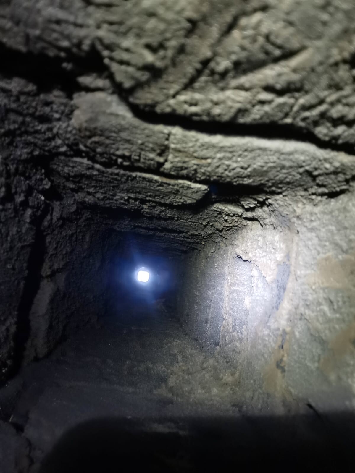

UPDATE:
Please scrap the second question as I have just realized the channel where the visiting door exists, is a different one than the one which serves the stove. I have had a look from the hole in the wall where the stove is connected and assessed the duct, it looks straight and dirty, hence the question about cleaning it properly remains.
As for my plan to attempt the cleaning, I shall try from the round hole where the stove is connected, of which inner diameter is 130 mm, hence if I follow recommendations from this thread, will need to build a plate 2 cms smaller on all sides than the chimney's duct inner wall, so that ends up with 120 x 170 mm the hard plate, plus the foam and the hard canvas on top. once inside, will be pulled by the trolley and should work. Probably a bit challenging when will need to repeat the procedure and the cushion will be full of mortar.
Attaching a picture taken bottom up, with duct's current status.
Thanks,
Adrian
  • Insida av en smutsig murad kanal eller rökkanal, sedd nerifrån och uppåt mot ett ljus i slutet av kanalen.

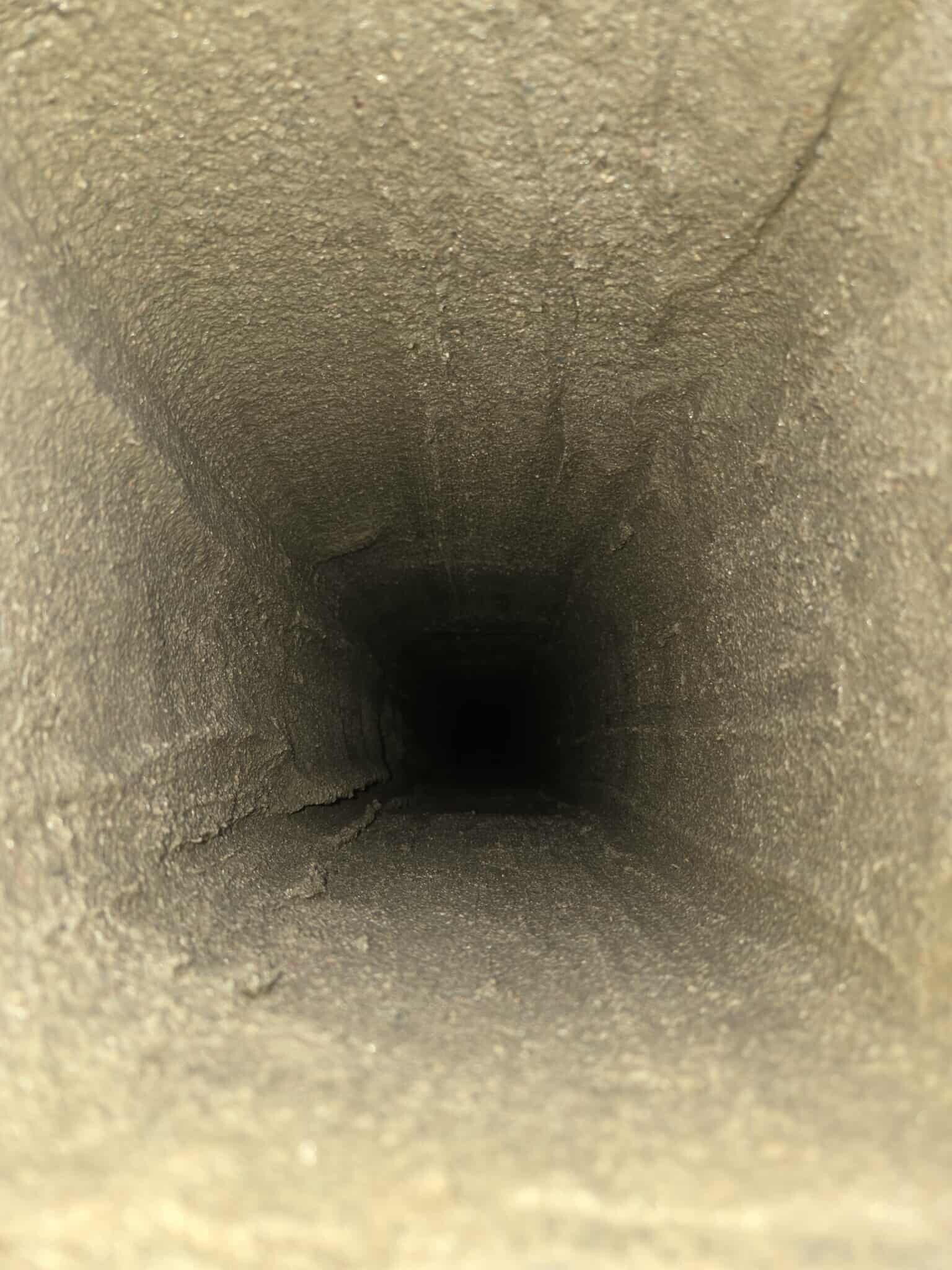

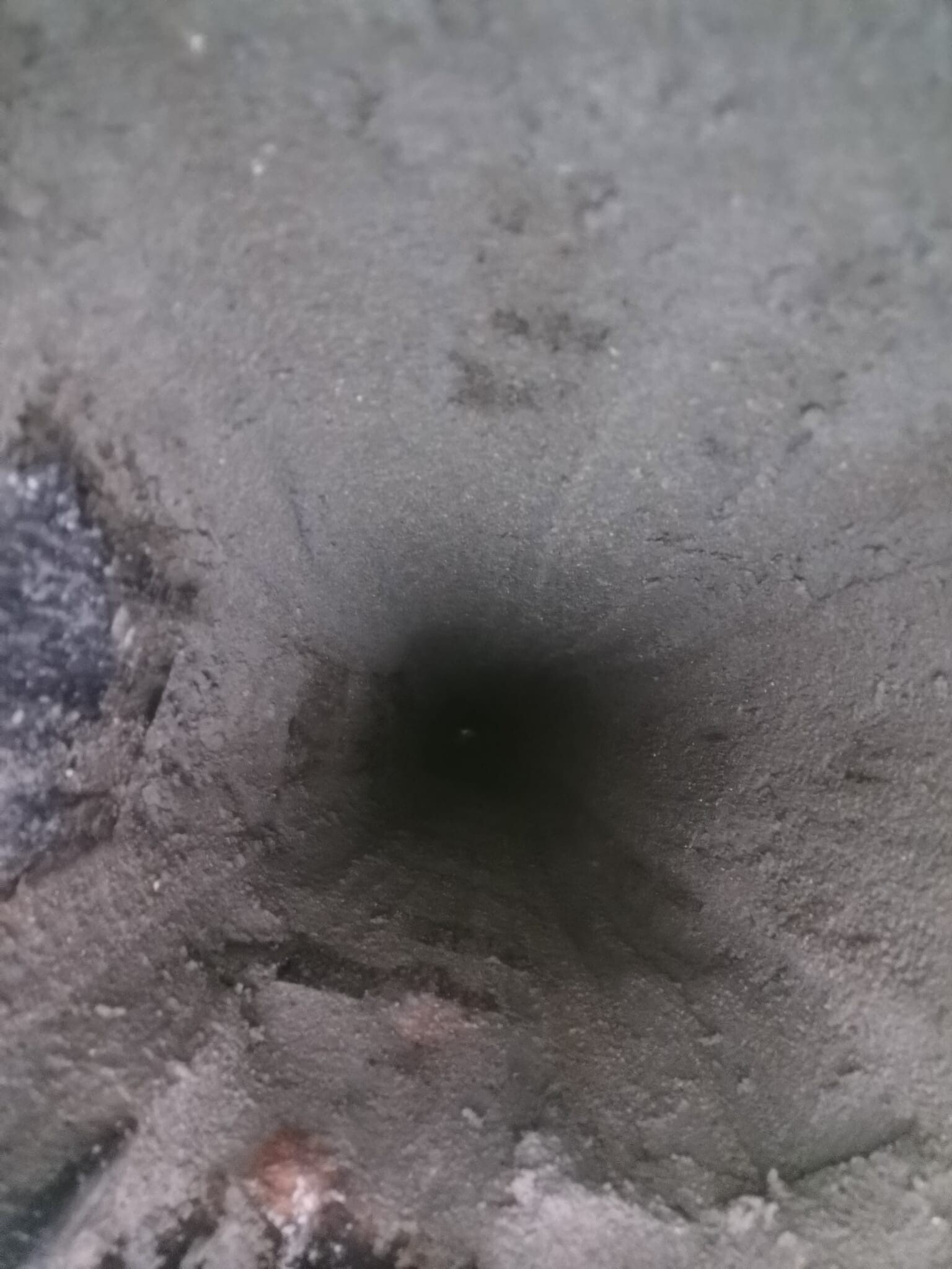

UPDATE 3:
Saturday on a rainy weather, have been cleaning as good as possible the chimney, using the two brushes I have purchased. After the cleaning, it came the washing part, using the water pressure machine, connected with a hose for pipes cleaning (that I have purchased specifically for this job).
I have made sure I washed well for the entire length of the chimney's duct and collected the water at the bottom of the chimney.
Additionally, I have prepared a first cushion, out of wood, which proved too big to be squeezed inside the stove (see pictures), so I changed the strategy and made a cushion adjusting one of the square brushes, added the 5 cm foam on top of it and covered it with two sheets of canvas and strong tape across for easy sliding (picture also added).
Sunday: After purchasing the mortar (c-bruk and tiles adhesive), mixed the mortar with water and proportioned it 60 - 40 % (c-bruk - tiles adhesive) and we have (together with a bricklayer) started to pour from top, after squeezing the cushion to the tube where the stove connects to the chimney.
Initially it was too loose and we had to make it a bit more sticky. Obviously during first drag, we have poured more mortar than needed and consequently big chunks started to fall at the bottom. As part of my job, I had to collect the mortar from the bottom and bring it back to the roof on buckets to be re-added. We did this 3-4 times without adding much more mortar, other than the one which fell off from chimney's duct.
Eventually, we had one final pull up, using a new foam piece, with only wet canvas on top (no strong tape), for smoothing the work.
Attaching some pictures to illustrate each phase of the work and the inside and outside final status.
Still have though a few questions, which will help me understand more work will be required:
1. judging after latest pics, after final pulls, there are areas where the mortar seems to be spread in very thin layer over the bricks, however all the space between the bricks seem to be well covered now. Should I expect to be challenged by the chimney sweeper, when they will come again for assessing the results? I could have seen from others' pictures, the mortar layer on top of the bricks looked really thick (probably due to successive pulls, after the mortar from previous runs dried).
In this case, did anyone try subsequent pulls, after the initial mortar dried on chimney's duct? I would appreciate a response, before reaching out again to the chimney sweeper company for assessing the new status.
2. My understanding is that Zingo and others, made a hole close to the bottom of the chimney for inserting the cushion before pulling it up. Also, understanding the process was cyclic after some years, does it mean that subsequent times they had to create a new hole for the same purpose?
Asking because my aim was NOT to break the walls and create as less mess as possible.

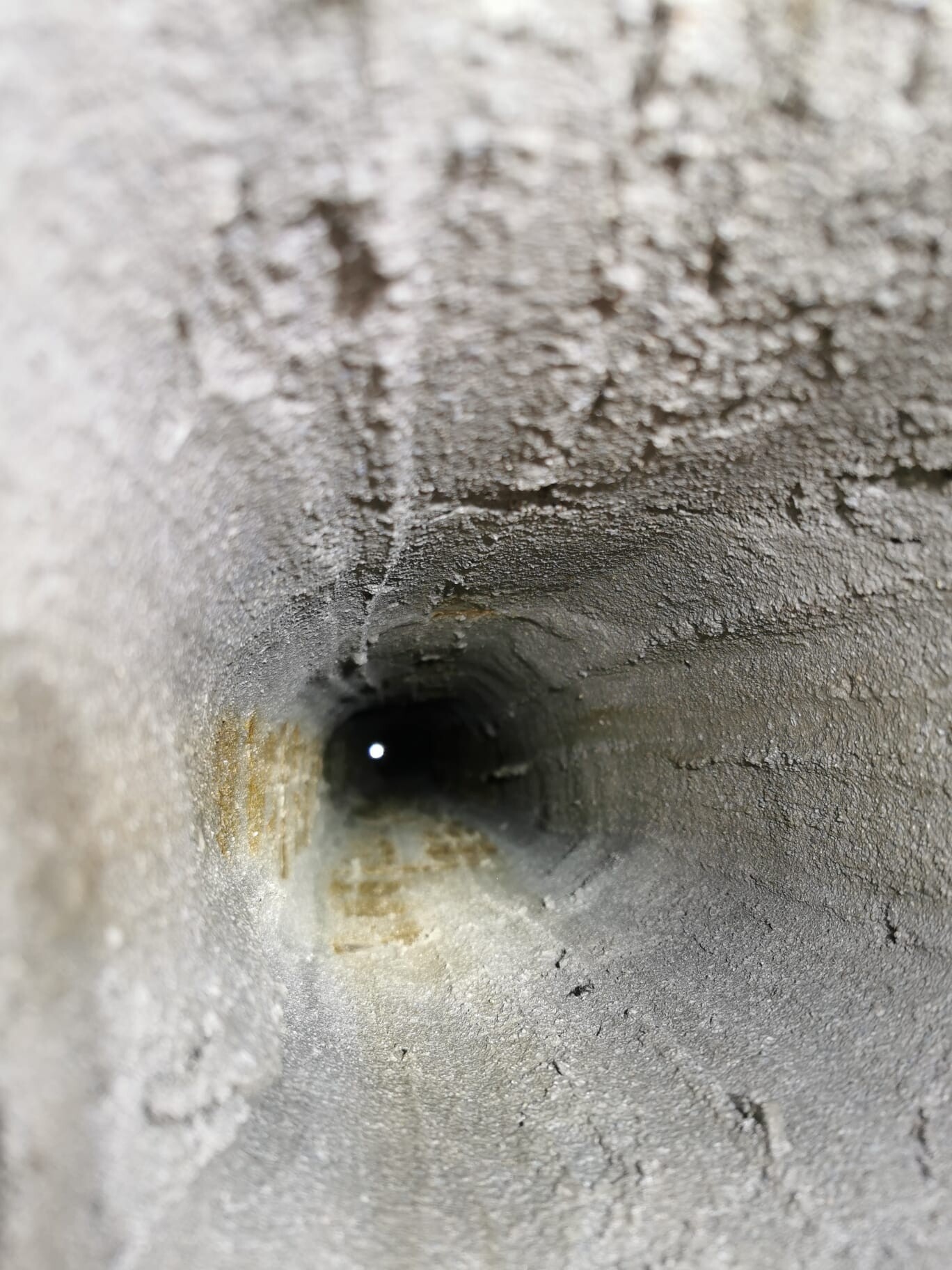

Smiter in med ett inlägg från min glidgjutning som utfördes relativt likt Zingos instruktioner, skillnaden var att jag bultade fast en ögla i centrum på skivan istället för öglor i varje hörn.
"Torrdrog" först och fick justera kudden en gång.
Sedan körde vi på med bruk två vändor efter varandra.
Och tillsist så körde vi utan bruk för att jämna ut enligt bilden.
Pipan var 17x17, vi gjorde en platta av två tunna plywood skivor på 11x11 med 5cm tjockt skumgummi från en trasig mt5 sadel. Den klipptes till ca 18x20 med en bit brandfilt över.
Gick väldigt smidigt då vi var 3st som utförde jobbet. För oss var det lämpligt att ha en som höll emot med linan under skivan från sotluckan så att den inte började kalva i böjen.
