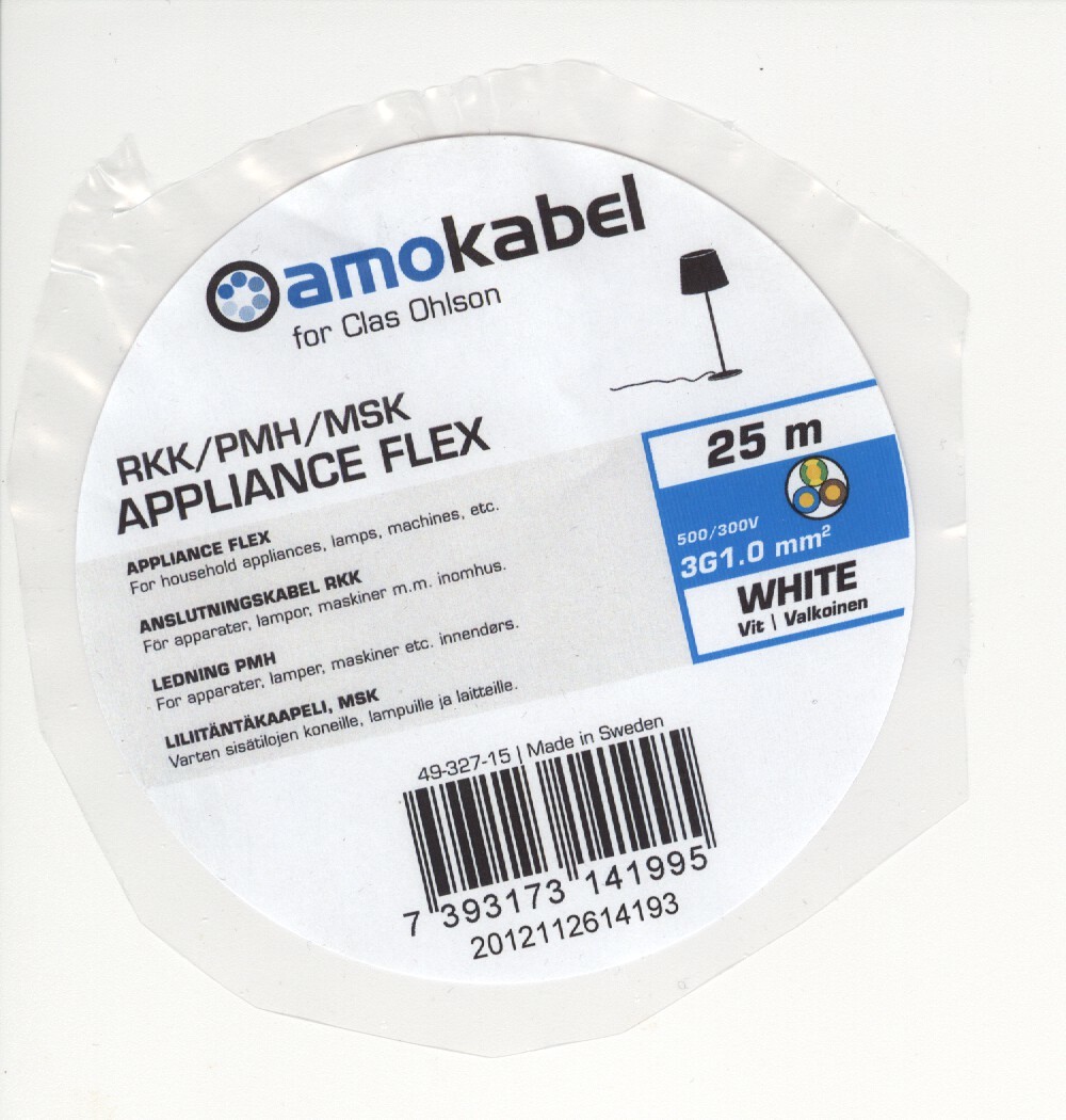

The wires are the below and like thebelow graphic. This cable has 3 wires - blue, white, green...each of which is stranded (ie not solid wires).
All wires fit into the WAGO 222-series connector. But the Wago-8 and Helacon 8 I think only take non stranded cables.
Im connecting 2 WAGO 222's now ... I guess the problem is somewhere else ....

You're right, you need Wago 222 for this cable.
On the other hand, this cable is not mean for fixed installation, so you probably got the wrong cable unless you're assembling a lamp or something else with a plug.
You initial attempt should work. Flickering is probably caused by stripping the cable too short. It should be 12-14 mm if I remember correctly.

In the basement I had two lights and two switches. I added a light - the very simple (cheap) wall hung ceramic light base with a glass ball. The wire goes from the junction to the lamp and el and null only connect to the lamp. I just added the wires in the junction box to where the wires of one of the other lamps was connected.
Am i on the right track? Only real problem now is the flickering light...
Reading the Web - I guess "RKK" means fine stranded ..... which means I cant use any other series than the WAGO 222 series ... (ie the 2273 series, 273 series, 773 series, etc ...)

Ok, you're connecting a lamp. You're on the right track then. Try again.
