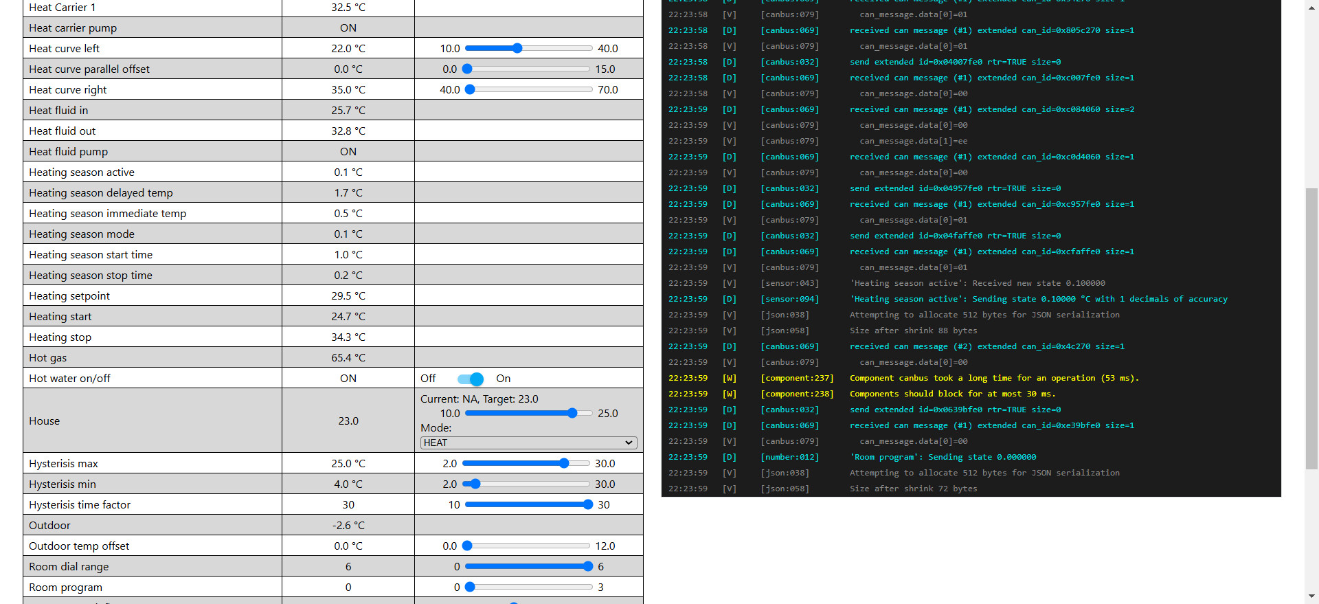

Guys, something great happened. I'm there!
Thanks a lot for the support and the great work with the code. It's unbelievable, but it really wasn't that hard. Yesterday, the board arrived, and I flashed the code onto it that same evening. Today I hooked everything up and voila
I have a question, please. In Home Assistant, I see 49 entities. Is that correct, or should there be more available? Is it possible to do further settings, like delay for turning on the electric heater and its power?
I'm getting a timeout for components 237 and 238. Do you know what that means?
My pump is version 3.10. In the YAML configuration, I used version 3.9 because I couldn't find version 3.10.
Oops, I think I know now... Additional entities need to be configured in the rego1000.yaml file for the variables in 'substitutions'. Am I thinking correctly?

Yes, that's correct. You need to find the right variable, assign the right type of sensor/number/switch entity and then cross your fingers it's working. I've had success with a few I got working, some don't see to report what they suggest.igor.igro skrev:
