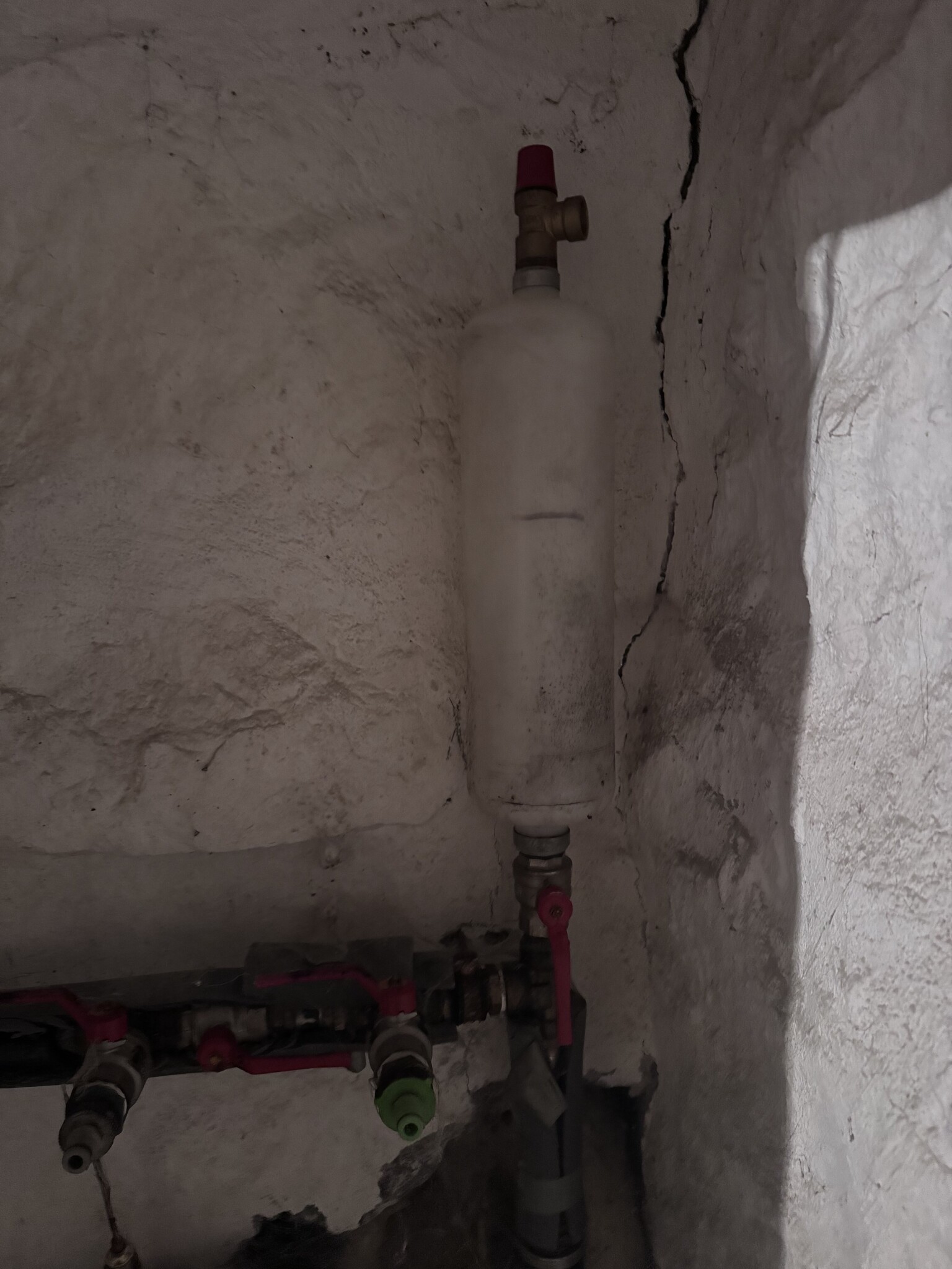

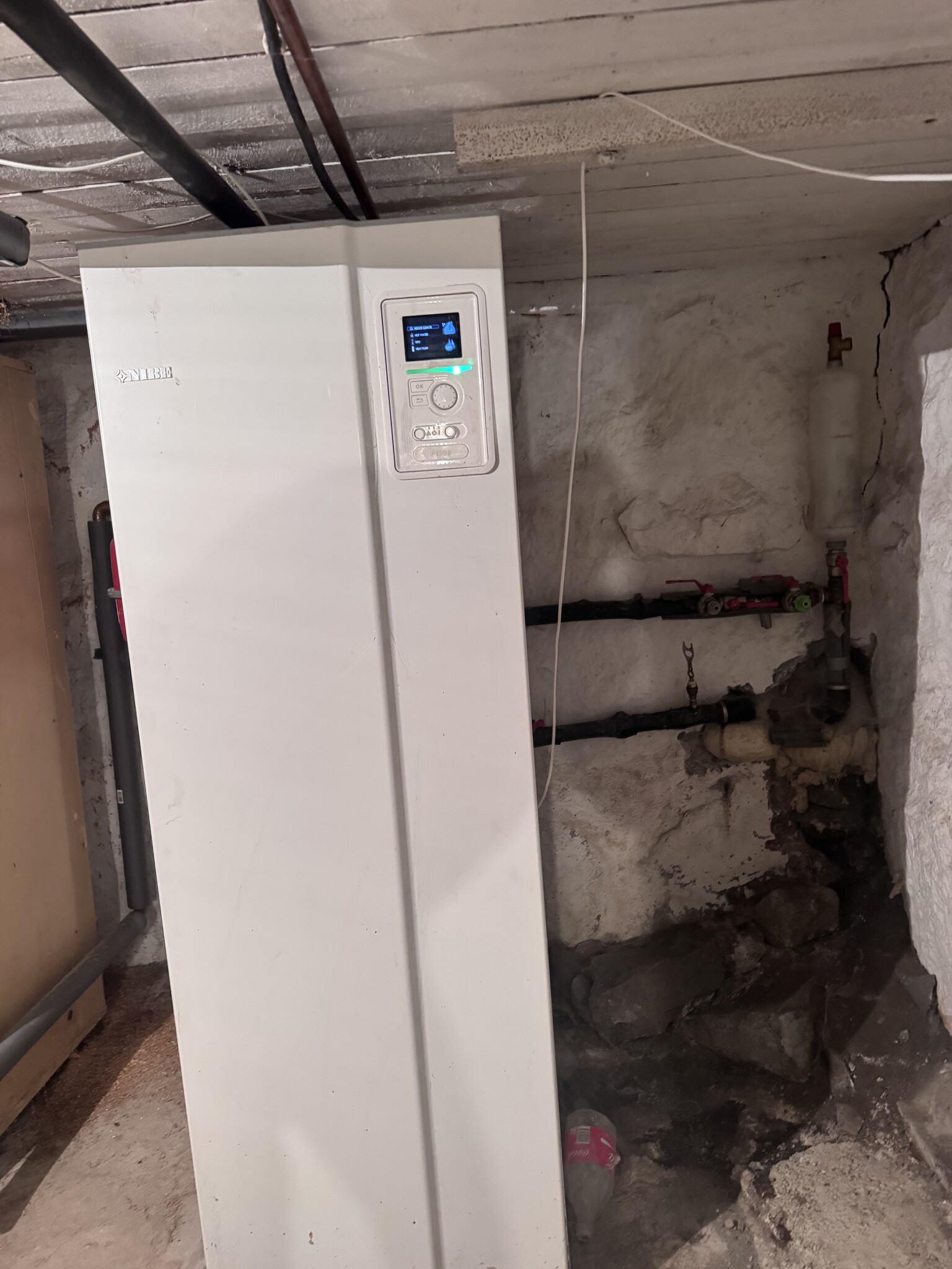

Hello,
We just moved to a new house that has Nibe 1226 as heat pump (the well is 160m in depth). I noticed that level of brine is almost 0 in the vessel level! And I’m worried if it’s in risk minimum level or its normal ? And how I can pop it up ?

Hi and welcome to byggahus!
Not sure about how to fill it, eg remove the top brass part and just mix and pour through a funnel.
But I get some red flags. Garden hose fittings for the filling/circulation valves? Thats usually something neater in a styrofoam box. Lots of spare alcohol for mixing brine? I have not topped up once in 10+years, never had a jug at home. A pressure relief valve at the top of the vessel? mine had a tight plug.
Is this a homemade, leaking system?

I really don’t know if its homemade or not, what I know that it’s made 2013.
I will try to open the brass fitting and fill then see. I hope it will work.
One more question: is this concentrate brine? Should I mix it with 2/3 water ! Or is it already ready to use ?
Thanks
Thanks a lot,DonPablo skrev:
but should I close the valve underneath the level vessel before opening the brass fitting ? I’m thinking about loosing pressure.
Also, is this concentrate brine? Should I mix it with 2/3 water ! Or is it already ready to use ?
Thanks
When I topped up my brine I used only water (was about 4 liters). Formally you should add a mixture that does not freeze easily. But I thought that my 4 l would not really change the balance.J youzarcif skrev:
