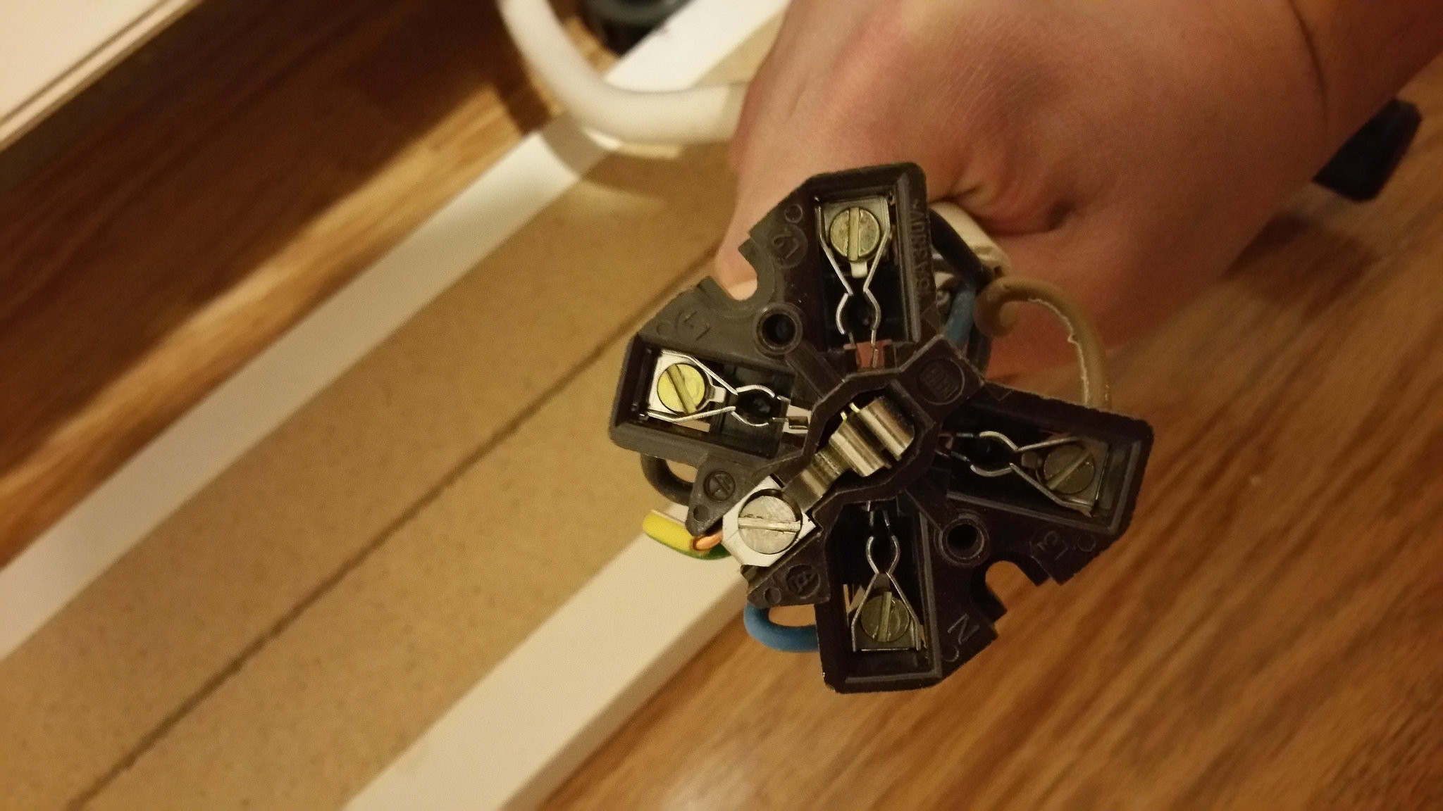

It seems that we are lucky, the neutral line is there
Now ... what. I went to MediaMarket yesterday but the way they place the sample hobs - it's impossible to see if the Siemens/Bosch spisar should be able to handle the 3 phases 230v.
Yes, that looks good. Just to check, are there five conductors coming from the cable? They should be Yellow/Green, Blue, Brown, Black and Grey. It's the grey one I can't see. Also, they should normally be connected L1=Brown, L2=Black, L3=Grey but for a stove/hob it doesn't matter (in this case, if grey is connected to L2 it doesn't matter for a motor either since the phase order is correct anyway)

Hi, yes, they all come from the cable. I guess the most important thing is the blue line aka neutral? The yellow line is ground and other lines are the phases and those do not really matter which is which?
