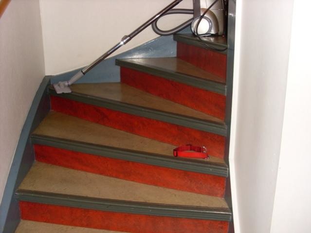

I'm checking out the stairs in our house because they are really dreadful. On the steps, there is some kind of gray patterned linoleum, and in between, there is some red stuff.
So what I've been thinking is to tear these off and then glue together pine floorboards to create units that I can cut out both the treads and the risers, so the stairs will be clad in pine, and then paint it. I've lifted the linoleum and checked, and there's nothing underneath that can be sanded down; it just seems to be junk wood, so that's why I came up with the idea to build on top with pine to get a good surface to paint on...
However, what I can't decide is what to paint with... you want it to be durable enough not to look like junk after a while... my partner wants to paint it completely white, but since it's intended to be pine floorboards, maybe we should whitewash it or something so you can still see the wood but not completely wooden... does such a finish hold up to foot traffic, or will it wear out quickly...
What I have planned to use for the stairs is this -> http://www.byggmax.com/se-sv/Prod/PID-08914117.aspx
What do you think of my idea? Am I completely off track, or could it work as I've thought?
In my mind, it looks really nice at least, but the question is whether it can be done like that.
And I have a picture of the stairs, so you can see how bad it is.

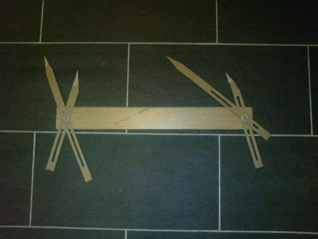

Quite simple actually. Now I might mix up the terms tread and riser... but here goes...Tiger79 said:
I made my own stair compass that I used to measure each tread after we tore off the carpet and sanded it a bit flat.
Once I had measured the tread, I stacked three laminate boards, measured the step with the compass, drew a line point to point and used a jigsaw to carefully cut out the step in the laminate boards. The risers(?) were quite easy and rectangular and were glued with PL600 first.
Then I glued tongue and groove on the laminate boards (also PL600) and also on the tread. Then gently placed the glued laminate boards on the step. In some cases, I had to fine-tune with a file.
Then add weight... books, photo albums, catalogs, anything you could find for a couple of hours.
Meanwhile, I made the stair nose from a tile edging in oak, whose width was about 5mm wider than the existing stair nose + laminate.
Once the laminate boards' glue dried, you had to sand down the short sides to make them plumb so you could nail on the new stair nose without a gap. However, I was a bit sloppy, and there were some gaps here and there which were covered with anti-slip tape.
Hope this little description was enough... Attached is a picture of the homemade stair compass.
A laminate board, two screws and nuts, and hard cardboard pieces as pointers.

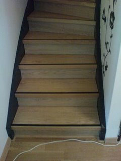

I took 14 mm oak parquet.
There is a stair ruler available for purchase. You can rotate it in all directions.
For the stair nose, use oak trim 56 mm, that way you cover everything.
Scroll down a bit in my album here to see the result.

I did the same and since we were going to paint, I kept the "skitvirket" and sanded off glue and linoleum residues. I got a reason to buy a new solid sander, but with that and 40-grit paper, it was less work than cutting pine/parquet/laminate which were the alternatives. Our staircase looked like yours in the picture and turned out very nice with gray paint, we think
So if you change your mind again and decide to paint, I see no reason to cover it with pine.
