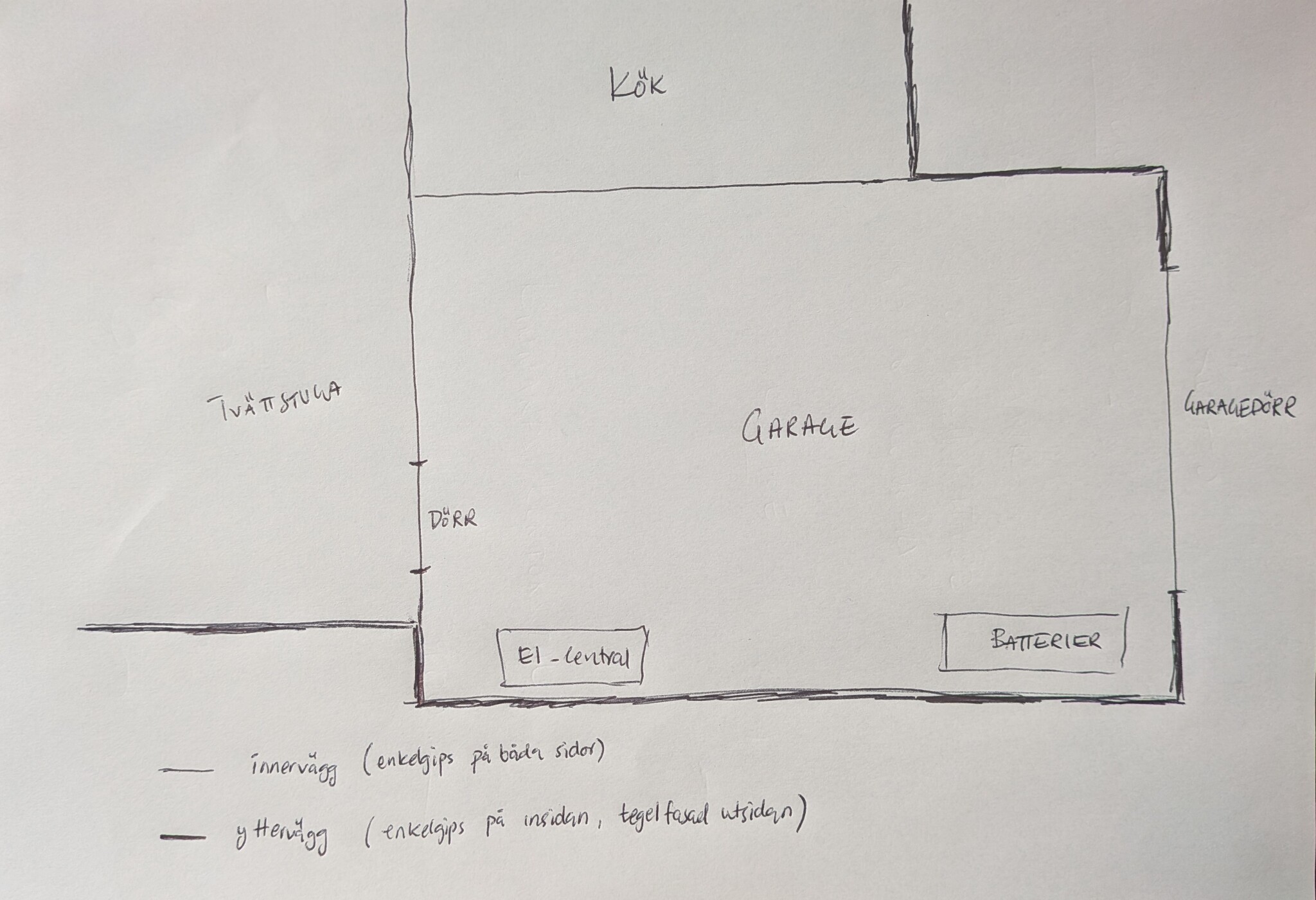

I'm hijacking the thread a bit, have a similar question:
I want to install batteries in my garage which is connected to the house on two sides. There is a new requirement from June 1, 2025, that battery storage over 20 kWh to be installed indoors must be placed in its own fire compartment with fire class El60.
In most places I've read, it says that double plasterboards on both sides of the wall are sufficient. The problem is that I can't tear down/install plasterboards on one side since there's a new kitchen installed... Is it enough if I just install two plasterboards on the garage side then? You mentioned above that one could carry out the fire measures from one side.
I'm aware that there are other measures that need to be taken as well, such as fire sealing pipe penetrations, etc.

I have attached a drawing of what it looks like. As mentioned, I can't do anything about the inside of the wall towards the kitchen and laundry room.
Is it enough with just single fireproof gypsum board on top of the existing single gypsum board on the exterior wall i.e., the part that is not in contact with the rest of the house?
Single fireproof gypsum board on top of the existing ceiling?
I will replace the internal door to the Laundry room with one that is El60 rated.
Do I also need to replace the garage door?
Place mineral wool between the studs in the interior walls, if it can be done without too much effort, or if there is already insulation there. Then you can definitely get by with double fire-rated drywall on the inside of the garage, or at most triple regular drywall (no need for four layers).
Check post #4 in this thread, I have asked the moderator to update the link to Paroc's document, and at the end of that PDF, you will find the addition method, with which you can calculate what fire resistance you get for a wall like this, which doesn’t conform to any standard wall type.

The wall is covered with a layer of plasterboard on the residential side and a layer towards the garage. You should also count these when you add up the total to EI60. Likewise, any stone wool insulation in the wall.ASZ007 said:
The ceiling is actually the most important to be thorough with. It's not clear if it's a roof (i.e., the residential house is built in an angle around the garage) or a floor structure (i.e., there is a residential floor above the garage).ASZ007 said:
In the former case, either the garage ceiling needs to hold EI60, or the surrounding (taller?) house walls need to, or the total of both protections should be at least EI60. If there's a window above the garage ceiling, it's still easier to place all the protection in the garage ceiling; otherwise, you'd need to replace it with an expensive non-opening special window.
In the latter case, the floor structure must obviously hold the fire class, but even there, you can count on the material that already exists in the construction. However, in this case, the floor structure needs to hold REI60, which means not only separating and insulating against heat but also not collapsing within the 60 minutes. This is usually achieved with the most commonly occurring dimensions and spans of floor joists, screw-glued floor particleboards on top, stone wool in between, and three layers of plasterboard on the underside, but if you have an unusual floor structure type, it's worth checking.

The inner walls have insulation, 45x95 studs, and single gypsum board. There is a ceiling in the garage with single gypsum board, then lattice paneling, roof trusses, attic, and then outer roof.
If I add a layer of fire protection gypsum boards, like this one:
https://www.hornbach.se/p/brandskyddsskiva-norgips-gips-brand-f-15-x-900-x-2500-mm/8645244/
on top of the existing single gypsum boards on both the ceiling and walls, is that enough? I've read that one layer of fire gypsum is the same as two layers of standard gypsum, so it becomes like three layers of gypsum everywhere.

It’s certainly possible but I think it would take up a lot of space and limit the available space in the garage. I'm planning to have other machines in the garage as well, so it's better if the entire garage is a fire cell.C Chrzan said:
Regular drywall also works and will probably be cheaper in total despite more layers. Plus, the fiberglass layer wears down the tools and the boards are a bit more cumbersome to work with (at least for me who isn't a professional).ASZ007 said:

But you can check the excellent table linked above in the thread, or look at Gyproc's equally excellent but more comprehensive handbook. Here is a direct link to fire ratings on attic joists, other wooden joists, respectively interior walls with standard studs from that handbook.

Thank you @Chrzan and @Mikael_L for the link to the documents!C Chrzan said:Regular drywall also works and is likely cheaper overall despite multiple layers. Plus, the fiberglass layer wears on tools and the boards are a bit more cumbersome to work with (at least for me as I'm not a professional).
But you can consult the excellent table linked above in the thread, or check Gyproc's equally excellent but more comprehensive handbook. Here is a direct link to fire ratings for attic joists, other wooden joists, and for inner walls with standard studs from that handbook.
It clearly states how to proceed.
