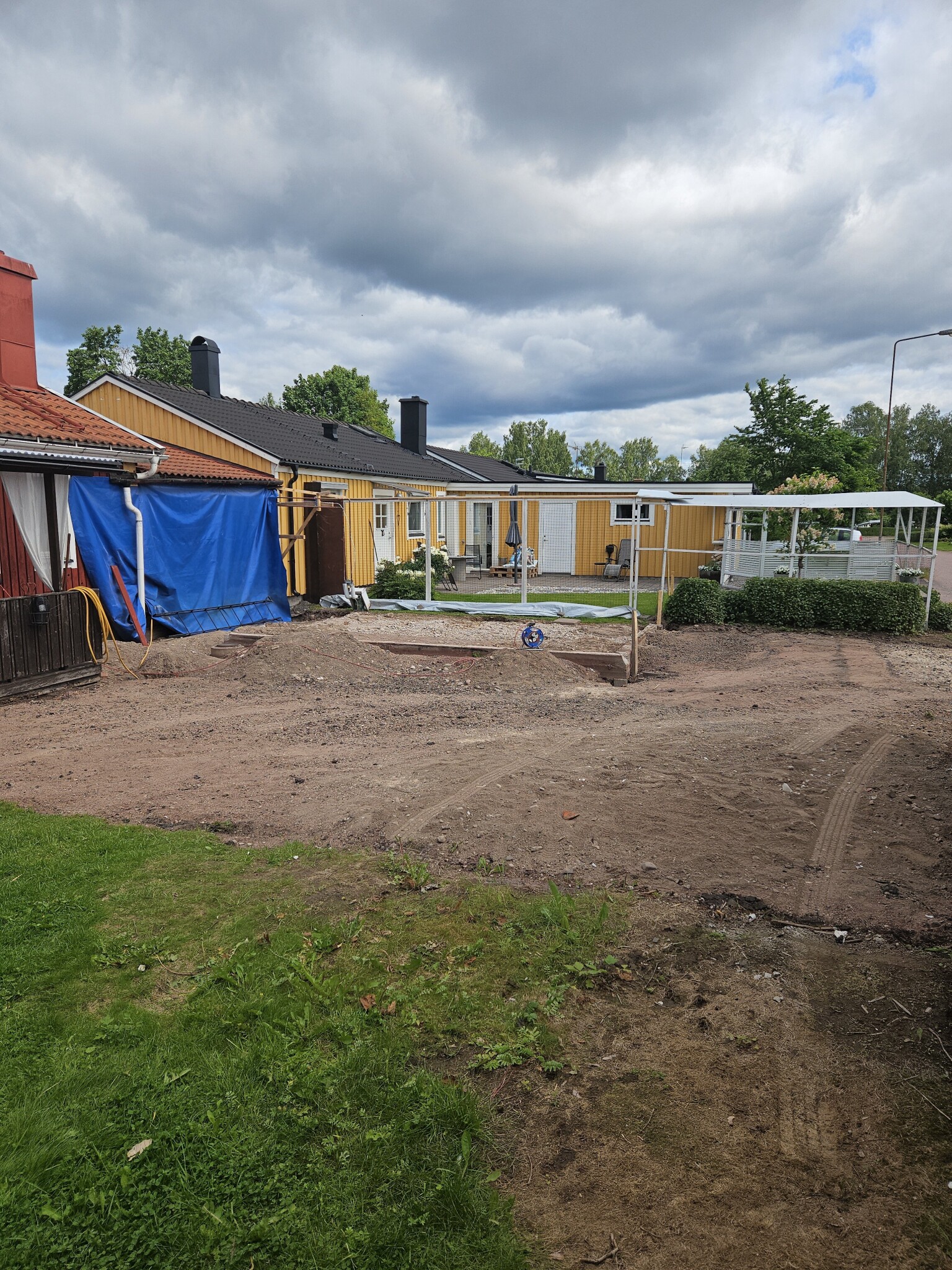

Lifting the thread a bit. I'm building a garage attached to the townhouse, so one wall is against my house. The requirement is an IE60 wall against the house. Is it then just the wall, or does it also apply to the ceiling, so you have to put fire-resistant gypsum board all the way up to the roof decking or double gypsum throughout the ceiling?
Is an A60 door sufficient, or does it have to be an IE60 door?

Thank you. I will buy an EI60 door and go with double drywall on both sides of the wall. However, it will be difficult for half of the garage as it faces the bathroom and I do not want to tear down that wall. Maybe use three layers of drywall?Mikael_L said:

If you fill the wall with rock wool insulation and then have double gypsum board on both sides or single fire protection gypsum board on both sides, it should meet EI60.
You might be able to use just double gypsum board, or single fire protection gypsum board against the bathroom, which will be quite close to EI60, and it might meet it as well. That wall does not exist as a type wall. Do you have tiles on the bathroom wall? That certainly increases the fire resistance sufficiently.
But if you have any requirement to follow, "someone" might not be satisfied with deviations from standard constructions ...

Unfortunately, it's a wet room mat. I'll go with double gypsum and mineral wool where it can be squeezed in. Then I'll use some fire protection sealant in the penetrations.Mikael_L said:

You can choose to perform the fire measures from one side. A rule of thumb that applies to gypsum from the major manufacturers is that a standard gypsum 13mm has 15 minutes of fire resistance. Fire gypsum 15mm has 30 minutes.
So 2 layers of fire gypsum in the garage or 4 layers of standard gypsum and you're set.
Depending on how the ceiling looks, you might also need to gypsum that, alternatively the wall in the attic and 600 mm on the sheathing.
