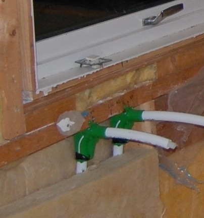

Today (when it was -8), the pipes (that run in the outer wall) froze. My question is whose fault it is. My first thought is that it's the carpenter's fault for not insulating sufficiently. I can't see how it's the plumber, as he installs the pipes based on the conditions built by the carpenter, or am I wrong?

Both will probably blame each other, but I believe the plumber has the responsibility. However, pipes in exterior walls should have an electric heating cable in them since freezing does happen. So bring in the plumber and have him install one. Then, pipes in walls might not be the first choice, but sometimes you have to.
Thank you for the answer! What I was thinking was that the plumber can only install the pipes according to the conditions that the carpenter has built. If I want the pipes in the wall, then the carpenter must insulate enough so that the plumber can lay the pipes as close to the interior wall as possible, or am I thinking wrong?
But sometimes you can't add more insulation without extending the outer wall, insulation takes up space. If, for example, there is 120+45 insulation, there is a risk that the pipes will freeze if they run in the middle of the 120 part. The freezing point can come quite far into a wall, the temperature inside is what counteracts it.
Thanks again! I can add that we tore down all the interior walls before the construction started, so it wouldn't have been a problem to add more insulation, and then the carpenter would have had to extend the wall so the plumber could run the pipes further in. I don't know how much insulation there is, but it's probably only about 120 or something, and the pipe is installed in the middle. Attached is a picture of how it looks.
So it seems like the pipe runs in the middle of the wall, but on the inside, there is both drywall and wood fiberboard and tiles, so I guess the pipes are actually closer to the outer wall than the inner wall.

Most likely it has frozen in the floor, there is probably a horizontal beam there that they have drilled through for the pipes, and the beam also works well as a cold bridge. Otherwise, it might be that further down the pipes have bowed against the outer wall.
But the pipes are supposed to go up between two floors, and to bring the pipes from the outer wall you would have to go through the joist and build out the wall about 45mm on the inside. Otherwise, the alternative is to add insulation on the outside.

But it goes through a stud and this is against the sill or whatever it's called. It could be that it's there that it freezes. I've made a small hole in the basement floor and removed some insulation so a little air can flow up to where the pipes go into the sill.

One cannot have insulation on the "inside" of water pipes, everyone should understand that, especially when it's quite a "thin" outer wall (if I'm not completely mistaken). And whose fault is it? Well, it's likely all parties involved share the responsibility. The client has the overall responsibility and decides how he wants the work carried out, the carpenter because he probably didn't understand the consequence of insulating towards the room, the plumber for not suggesting a different routing. But the greatest responsibility probably lies with the builder for not providing clear enough instructions. Unfortunately, it's quite common for this type of mistake to occur.

I have talked to the plumber and his theory was that there could be a cold draft at the threshold.
