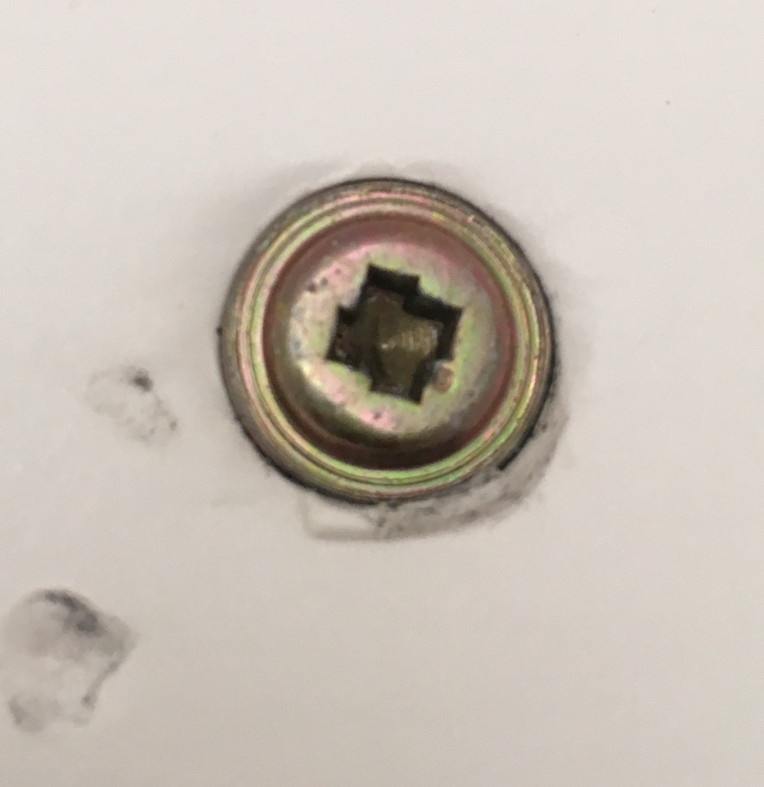

Moved into an apartment and there's a wardrobe that needs to be removed which is screwed into the wall with these.
What the heck kind of screw is this? Where can I get bits for these??
Close-up of a screw with a square socket head in a wall, featuring slight discoloration and black marks around it.
Never seen it before, but it looks like it's designed to handle several different types of bits. I would have taken the bit box and tested to see what gripped best.
It looks like a Grabber lox bit.

It is a so-called LOX bit that you need. I have come across these with screws from Grabber, so those who sell such should be able to help you. Now that you know what you're looking for, it should be possible to Google retailers.

The product information from Grabber states that PH2 can be used in case of emergency.

Thank you everyone! Now I know what to look for at least!!

Yes, found at K-Rauta, they were the only ones who had them as far as I could see. So I finally got rid of those damn cabinets =P
