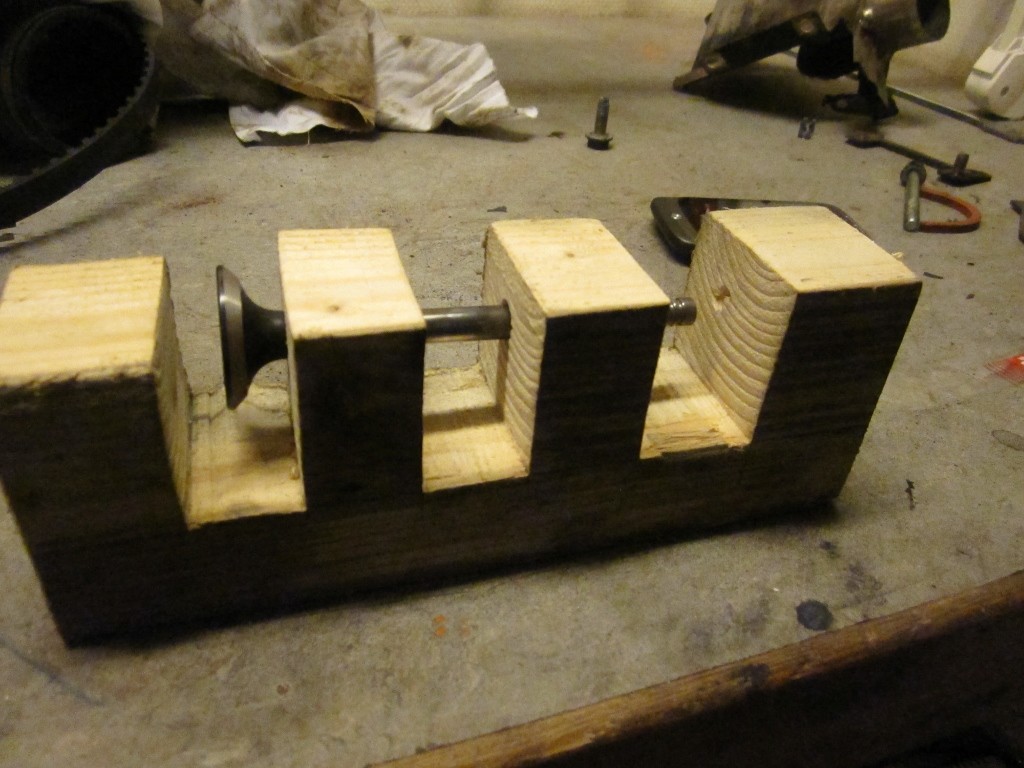

Surf a little on wooden boat builders and get some inspiration on steaming the strip to make it bendable. A wooden block with grooves, holding a metal valve, placed on a workbench alongside various tools.
You can ponder how I got the car valve into the wooden piece; once you understand it, it suddenly becomes a lot less work to attach a bent strip.

It is also more aesthetically pleasing if there aren't "holes" at the bead like there are if you have a strip in front.

You can think about how I got the car valve into the piece of wood, when you understand that it's suddenly much less work to put on a curved strip.
It's awesome how this is done, I've thought about trying it myself sometime in the future! :)
