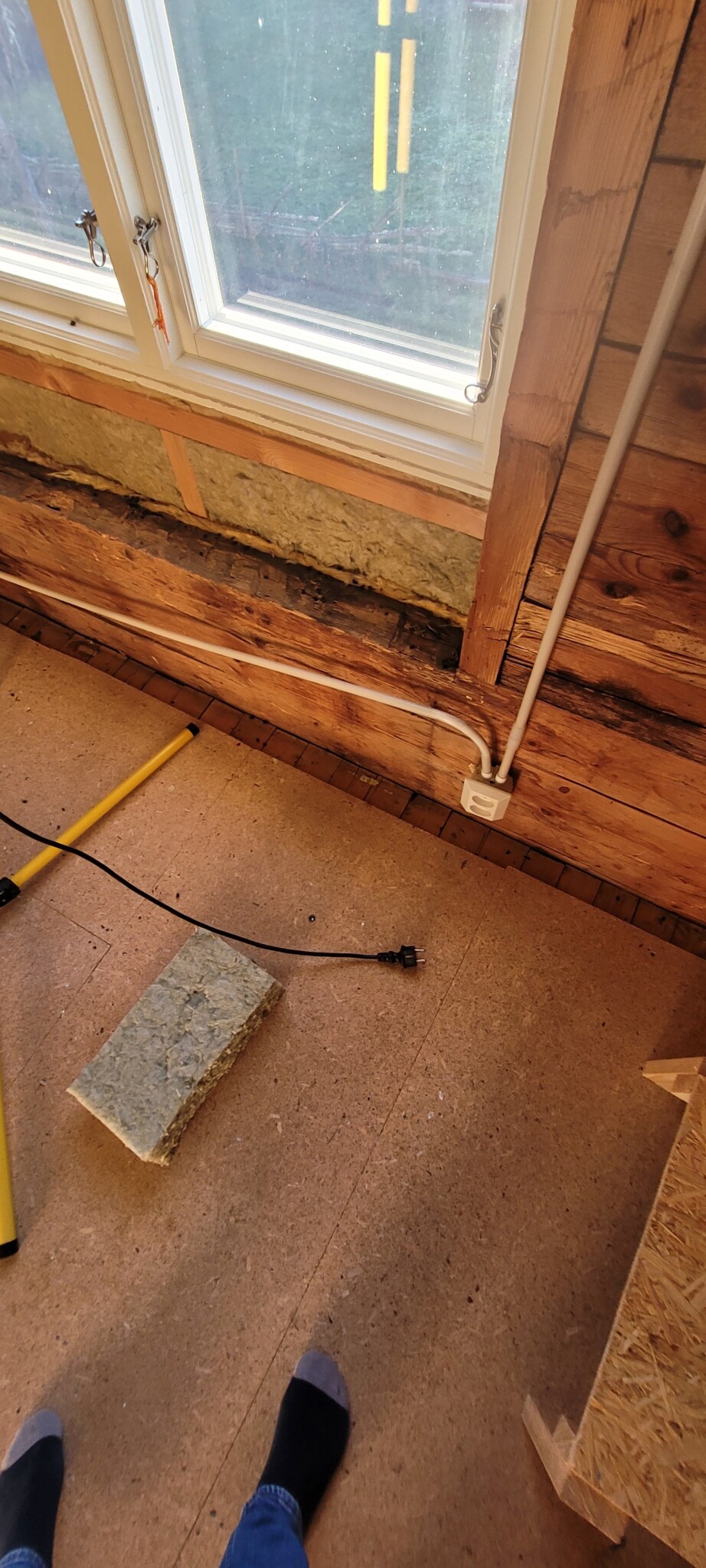

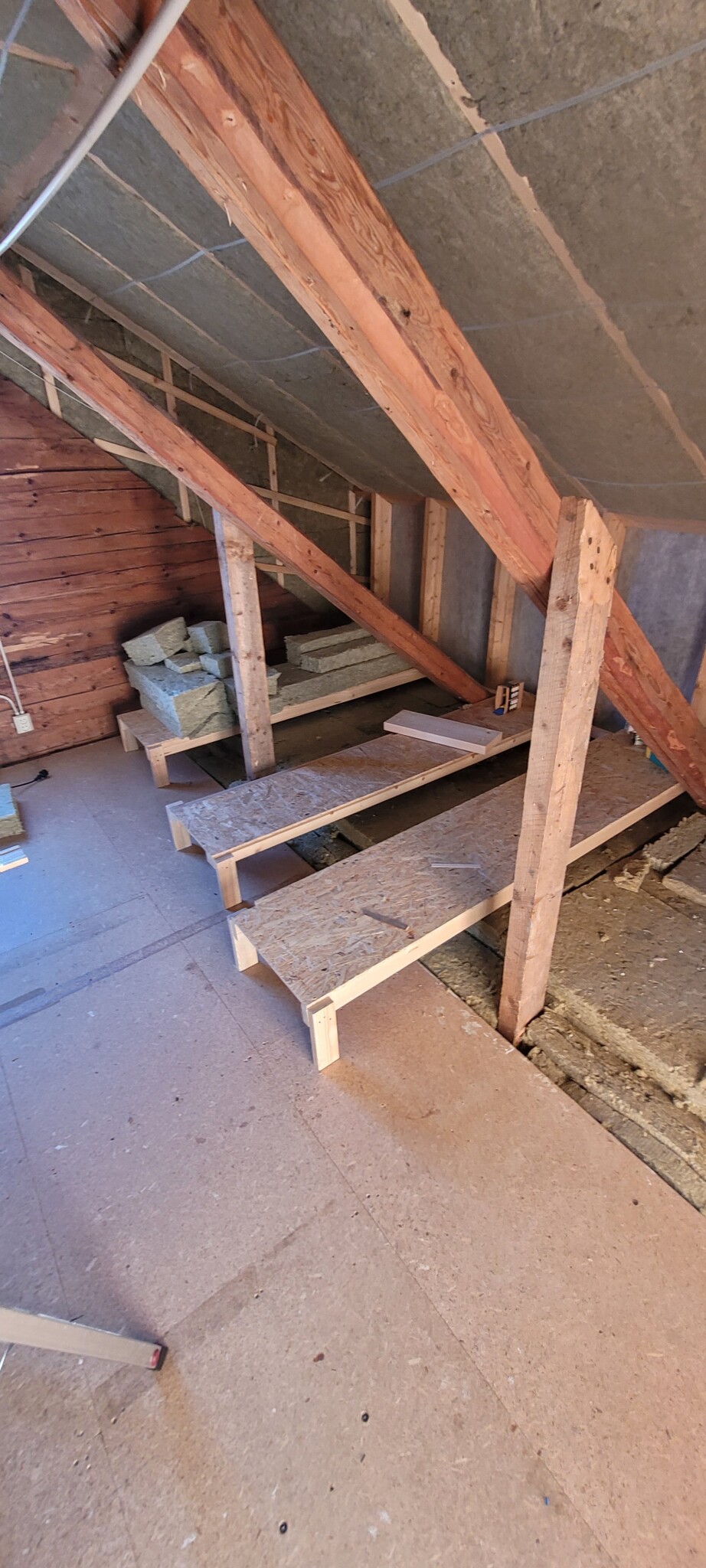

Hello, I have an old house where we will be renovating the upper floor. The room in question is 6×4 meters and the beams run in the long direction. There are 4 beams, 2 of which are on the edges, so there is a long distance between the beams. Problem number 2 is that the ceiling in the room below is raised between the beams, so height is lost there. My idea is to tear out the old floor, try to level the beams, and then lay a subfloor of tongue and groove planks 42×120 to distribute the pressure as best as possible, what do you think about this?
//Thord

What is the problem you want to solve? I don't quite understand how it is structured. The floor beams we see in the ceiling of the lower floor run lengthwise in the house, right? In the picture at the gable on the upper floor, you can see a wooden floor under the chipboard, which is also lengthwise. It feels like something is missing in your description.

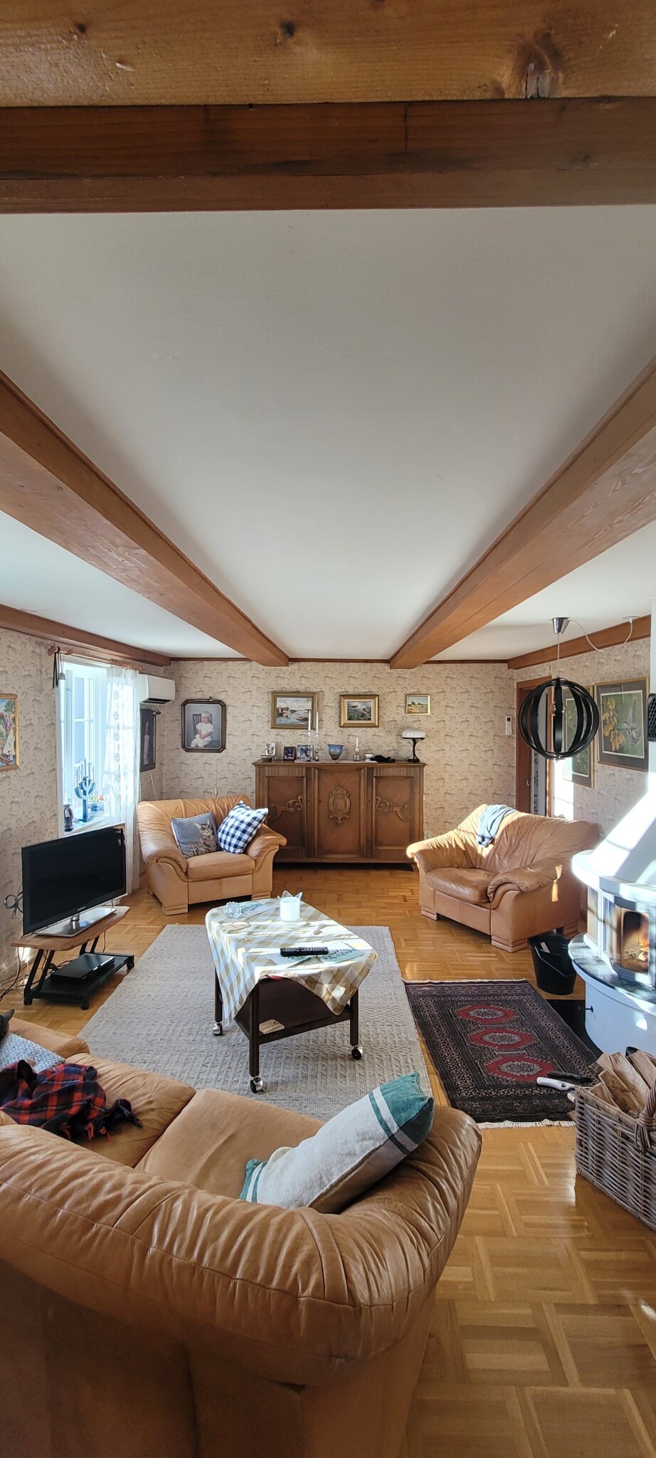

Those beams in the ceiling look like fake beams.
Have you raised the ceiling on the upper floor? The construction looks quite funny now.

I think the beams in your living room ceiling are just decoration

I also think it's fake. I see no logic in constructing the beam structure like that.
It's probably just nailed-together boxes on the ceiling. Fake visible ceiling beams were popular countless years ago.

My problem is that the existing floor is too bouncy, I need to make it more stable without tearing up the ceiling on the lower floor. Therefore, my idea was to remove the old chipboard floor panels and the old wooden floor that seems to be under the panels, and lay a solid plank subfloor.

Just speculating a little:
Probably, the house wasn't designed for the attic to be living space.
The rafters look to be 5x5"? That is, not particularly thick. They are probably intended for a light roof - straw or shingles.
The beams are likely in the same dimension, 5x5" or maybe 5x6", with a span of 4 m. It might very well be that there are no corresponding beams between the trusses, but it's around 120 cm on center or so. There would be some flex in the floor, but nothing that should be a problem in terms of load-bearing capability.
The room is very long for an old (?) house, which indicates that partition walls have been removed. In our old house with a similar structure, i.e., 5x6" beams with varying 100 - 140 cm on center and a span of 5.5 m, there are 6x6-8" beams running lengthwise with the house between cross walls with a distance of 3 - 3.6 m. The trusses' beams are screwed together with these beams with large hand-forged wagon bolts. I think that if it was similar in the thread starter's house, that reinforcement disappeared when they probably removed a partition wall to make the room on the ground floor larger. That is, a room 4x6 m instead of 2 rooms approximately 4x3 m.
As others have written, the beams must be reinforced, which is most easily done with taller studs nailed to the sides of the existing ones. However, this means the floor will come up a bit higher, which might not work practically up there?
