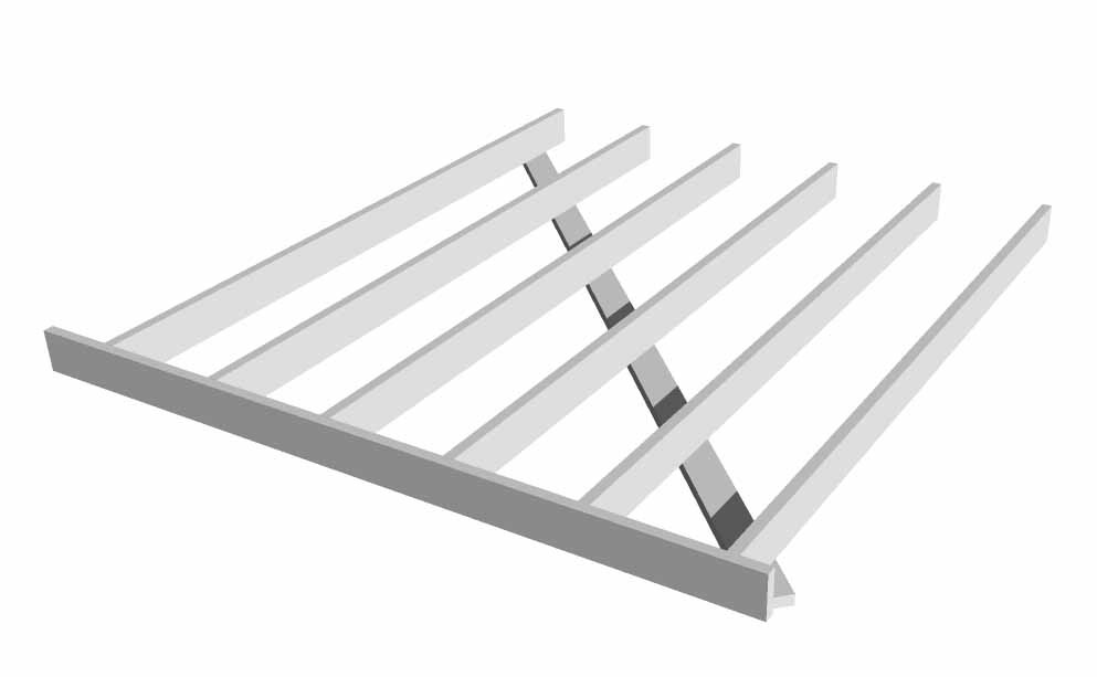

Does it sway sideways? Then it might help to screw in diagonal braces under the floor to lock the construction.
Depending on how your deck is built, you may encounter three different types of stability issues. 1) Post constructions without diagonals and boards are not stable, particularly against lateral movements. Diagonals in the plane of the deck solve this problem. 2) Deflection problems, i.e., the deck moves too much vertically when you walk on it. This is due to the beams having too weak dimensions relative to the span. The easiest solution is to reduce the span. It can also be because the decking is too weak relative to the c/c distance. A 28 mm decking with c/c 600 mm is sufficient. 3) Buckling tendencies in the longest posts, which can give a somewhat swaying feeling. This can be addressed with braces or something similar at half the height of the posts.

It doesn't really matter much where you attach them. It is usually easiest to attach them to the underside of the beams. From the facade to the outer edge at about a 45-degree angle. With your large deck, you will need several in a zig-zag pattern.

1) Something like this: 3D illustration of a roof truss design with parallel beams and diagonal supports, showing the basic structure for a building project.

Remaining tasks, diagonal braces from post to outer support beam/rule.
A row of posts in the middle of the deck to increase load-bearing capacity.
Straps (boards) in a zig-zag pattern under the deck and beams.
