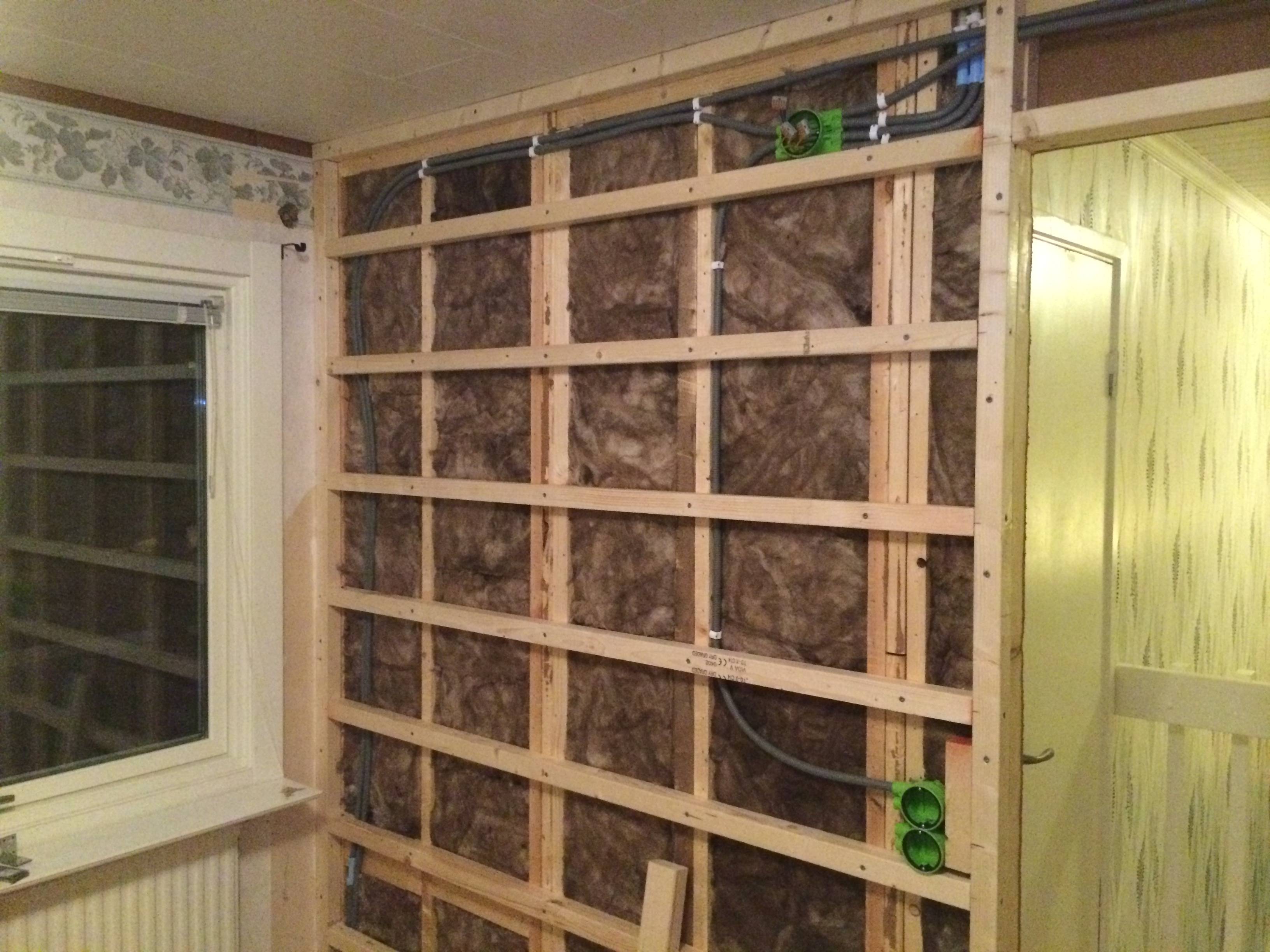

Thanks for the response, but I chose a different path anyway. I ended up using 45x45 battens laid horizontally and attached them to the vertical studs, the wall became much more stable, so I'm quite satisfied. I'll include some pictures so you can see how I did it

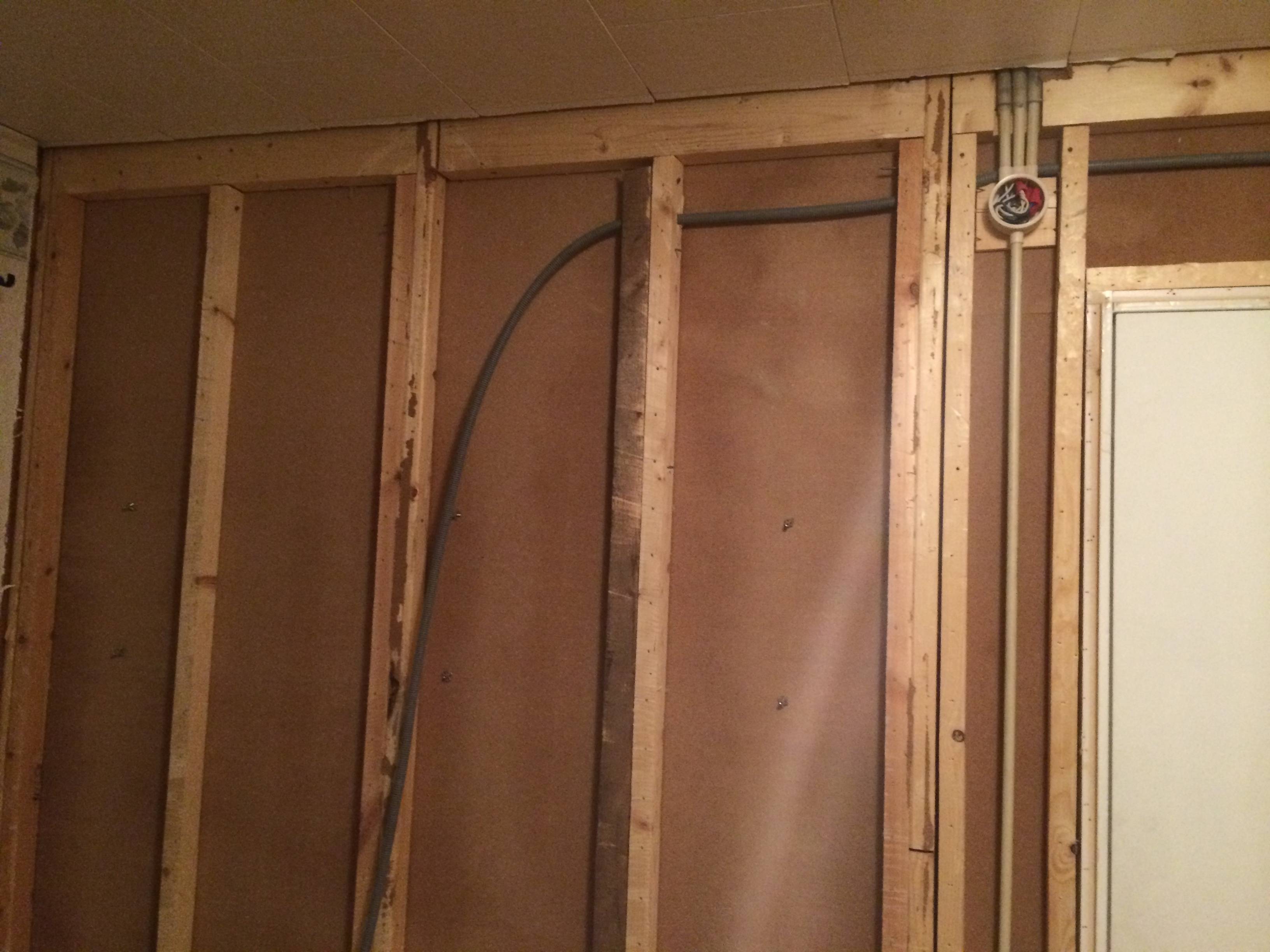

This is how it looked when I tore it down, the nails sticking out are the ones fastening the masonite on the other side of the studs, incredibly the masonite is nailed with 75mm nails :O
A picture of the wall's stud construction. I don't understand why there are three studs everywhere and why the top plate is broken at every "middle" stud.

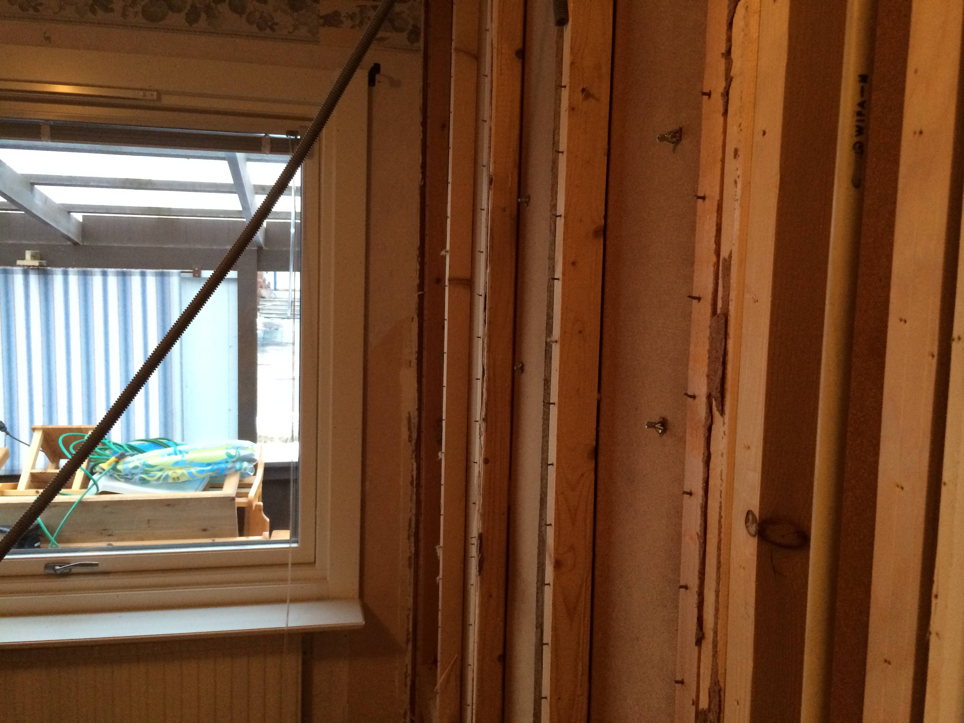

This is how it looked after I worked on the studs for an evening, I glued and screwed the studs in the doorway, otherwise, they're only screwed.

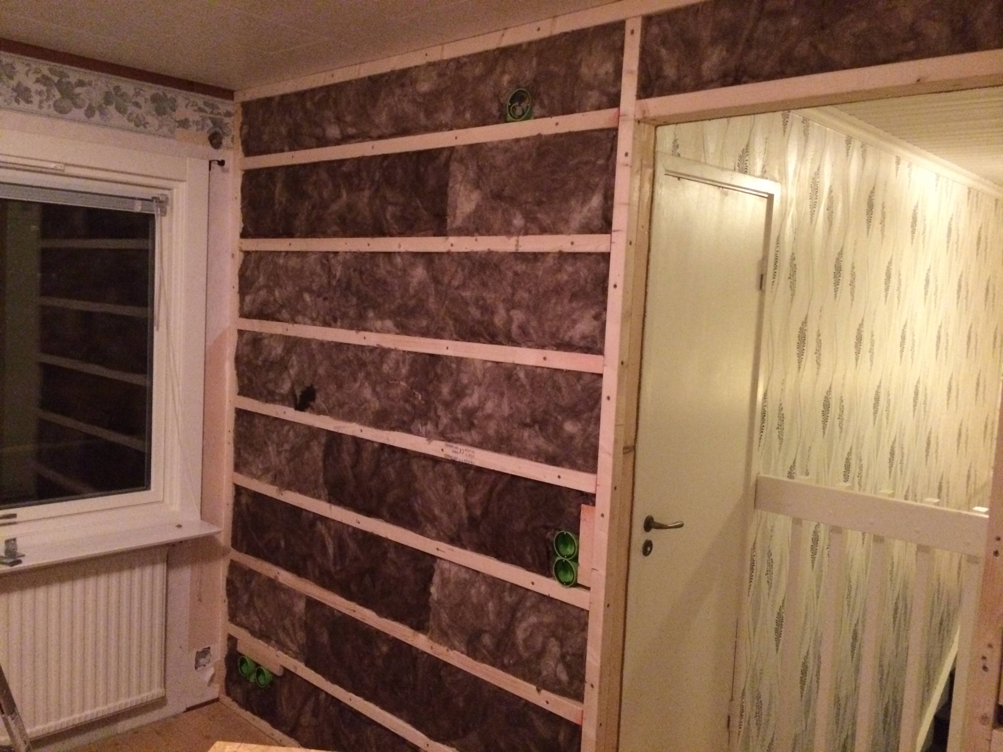

This is how it looked insulated and ready for drywall. The studs situated for the existing doorway had a gap of 81CM at the bottom and 80CM at the top. So the margin for adjustment was completely gone, I set up the new studs to the correct measurements and then sawed off the crooked parts from the existing studs with a reciprocating saw.

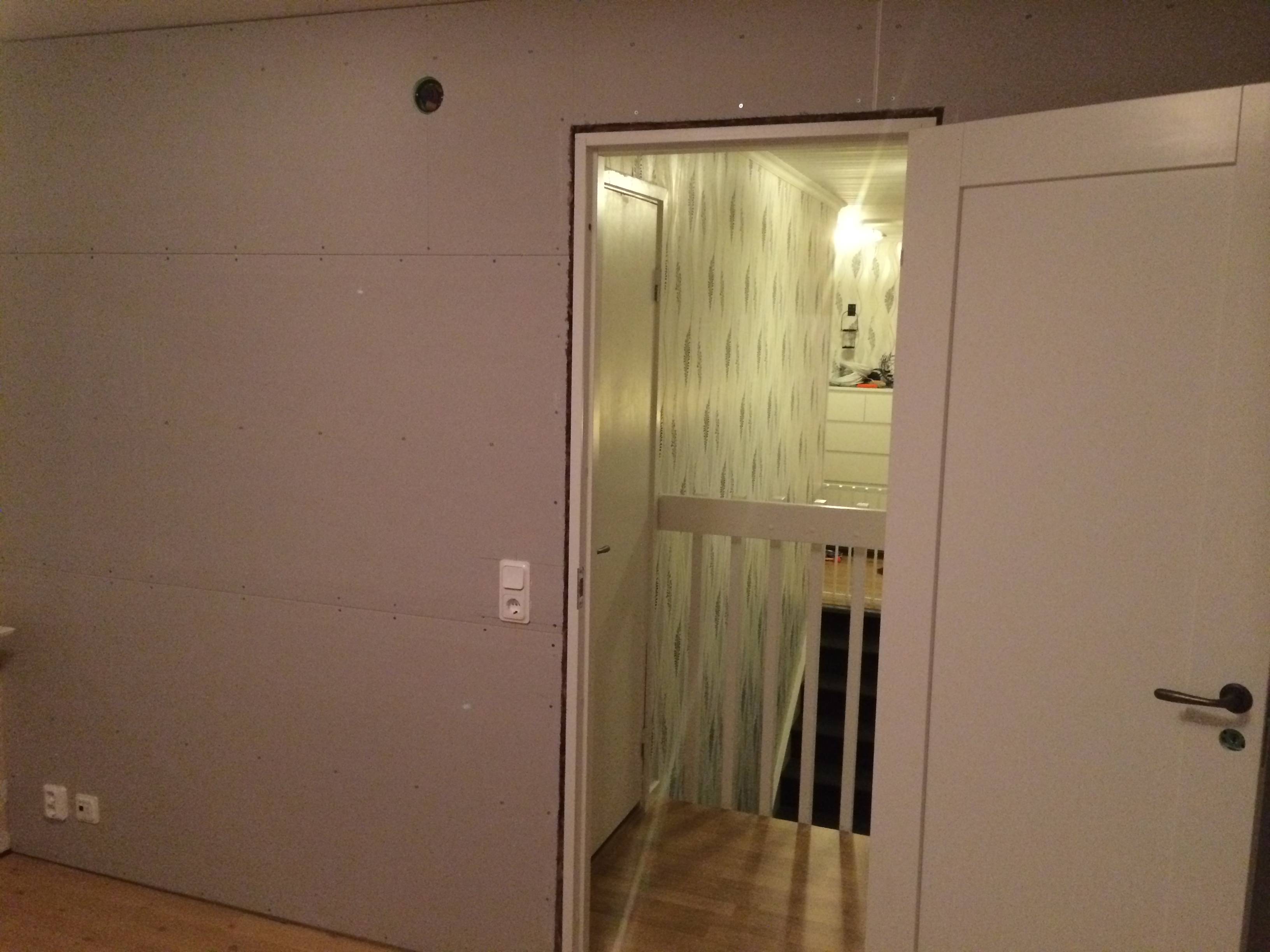

Drywalled and ready, more screws need to be added but otherwise, it's ready for wallpapering, the door frame was mounted in about 2 hours, the first time I'm mounting a frame though so it took a while to adjust it
