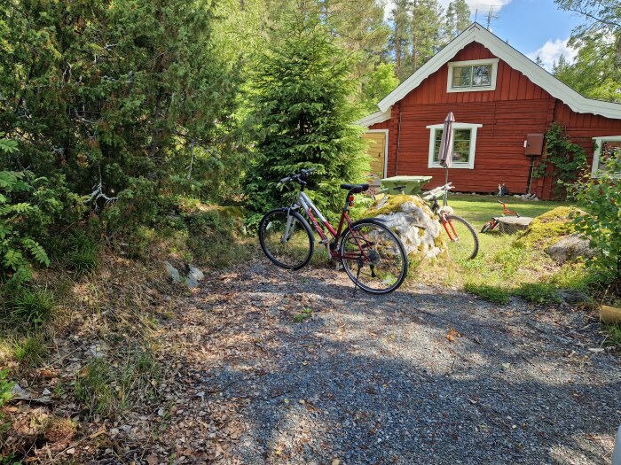

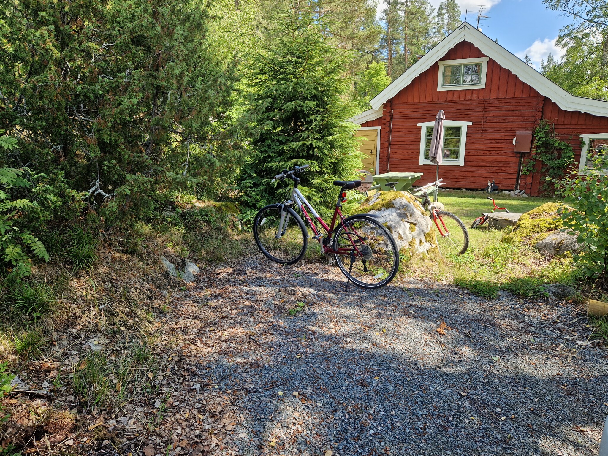

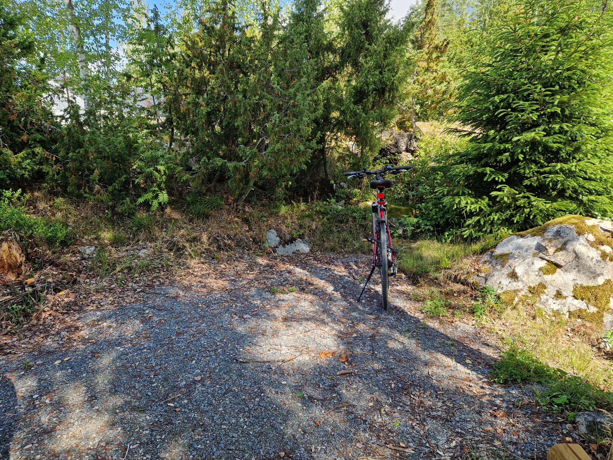

What does it look like around otherwise? Pictures?
There's not much around.
  • Red house with a yard, surrounded by trees and bicycles parked outside. Quiet setting with minimal surroundings.
  • A bicycle parked on a gravel path surrounded by trees and rocks in a forest setting.
The question is how strong the autumn winds will be there? It seems to be sheltered on three sides.

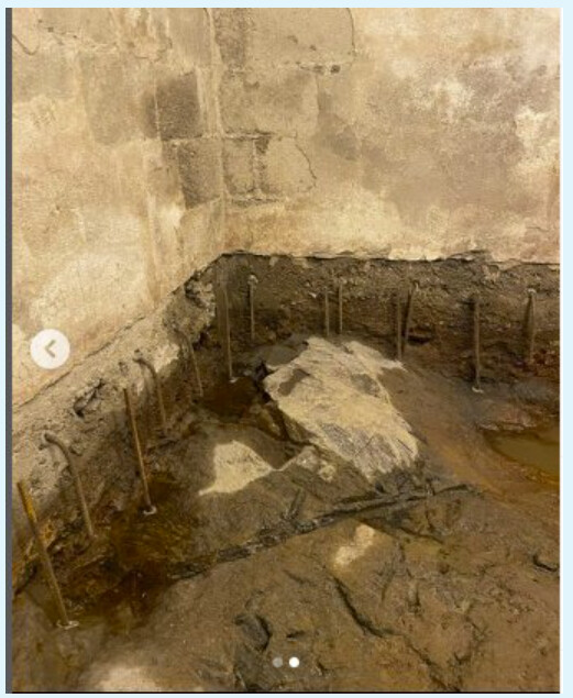

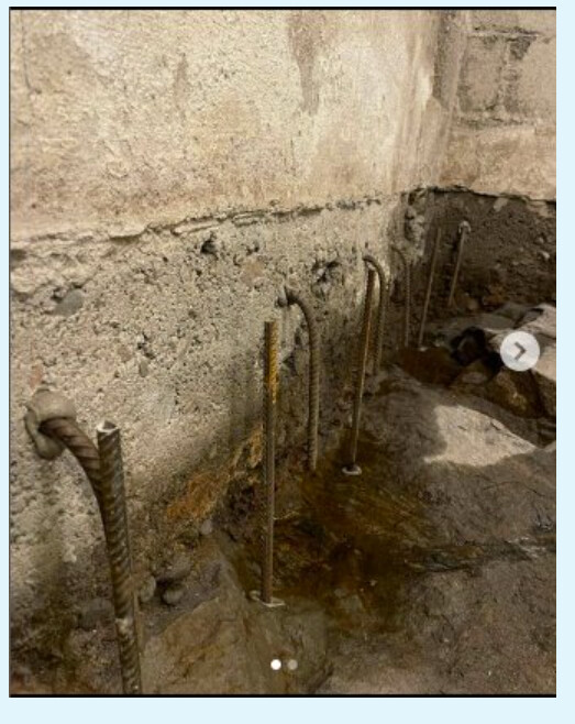

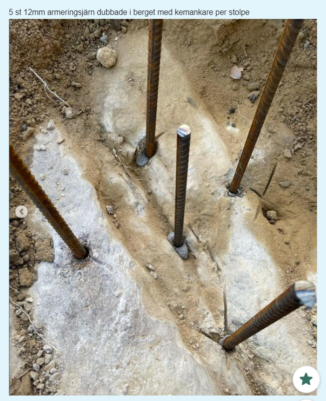

I've done it a bit and can describe how I've done it. I can also provide pictures if needed.
1: Dig down to the bedrock. If you're going to use a 200mm pipe to cast in, maybe 300mm is sufficient.
2: Drill e.g. 16mm holes in the bedrock about 10-15 cm deep. Here you need a hammer drill, which can be rented for example.
3: Buy chemical anchors at Biltema
4: Follow the instructions for the chemical anchors. Generally, it's about blowing and brushing out the hole a few times, squeezing out the chemical anchor until it has mixed (usually 3-5 pumps). Press down the chemical anchor in the hole, insert 10 mm rebar while slowly rotating it.
5: Let it be for an hour or so (the chemical anchor cures quickly).
Now you have doweled the rebar into the bedrock. The chemical anchor can be replaced with expansion concrete fine as well, it's a bit cheaper but then you need larger holes which take longer to cure. But if, for example, you only have access to a 20mm drill, you can use 8mm rebar and expansion concrete. The principle is the same i.e., drill, clean out with brush and compressed air in cycles, fill up, insert the iron, let it cure.
Concrete wall with several rebar rods anchored into drilled holes, illustrating steps for securing rebar using chemical anchors in a renovation project.
Image of a construction site corner, showing drilled holes with rebar inserted. The surrounding area is wet with visible rocks and soil layers.
Construction site with a trench and various wooden supports. Visible is a drilled and anchored rock base for a building project, with tools and materials around.
Five rebar rods anchored into rock using chemical anchors, part of a foundation preparation process for construction.

And when I've inserted the rebar. Is that when I cast in the post shoes?

But do I cast the post shoe instead of the rebar, or do I cast the rebar with that cardboard casting form so I get a post shoe on top?

For a simpler shed, it's enough to drill holes in the rock and drive in the rebar or the post shoe, setting with lead, casting, or getting chemical anchors is overkill.

You place the cardboard tube over it so you cast the rebar into the tube. When you cast, you attach the post shoes so they are cast in place.
