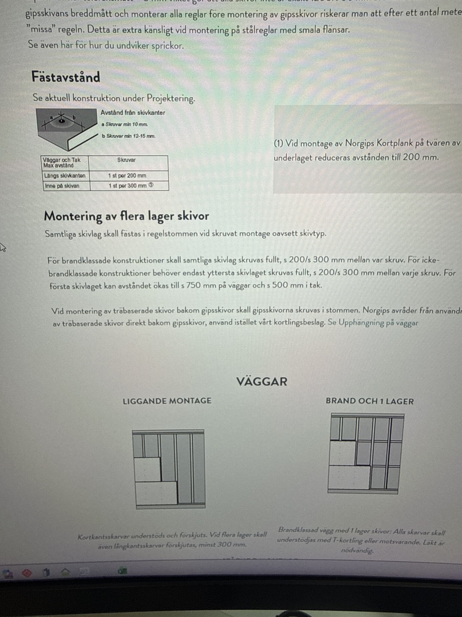

Here you can read what Norgips says about screwing boards. All major manufacturers say the same thing.
It is a common misconception that you can screw into only the plywood, but as mentioned, it is incorrect.
Instruction guide from Norgips on screw placement for wall panels, with diagrams and spacing recommendations for various construction types.

How do you plan to solve this when the plywood is 90 cm wide and the plaster is 120 cm wide? Besides, the boards are often laid crosswise. Manufacturers are looking out for their pockets by trying to sell their "one-size-fits-all" systems. As I mentioned, the plywood is a structural element in this case, so plaster can be attached to it. If you have any justification for the risks of this solution, I'd be happy to hear about it. And the manufacturer's RECOMMENDATIONS are just that, recommendations.
Norgips advises against using wood-based boards directly behind plasterboards, instead use our crossbar bracket.
The above statement from NORGIPS confirms what I wrote. They don't even recommend using plywood under plaster, so you'll just have to BUY THEIR mounting reinforcements, which contradicts industry recommendations for wet rooms.
