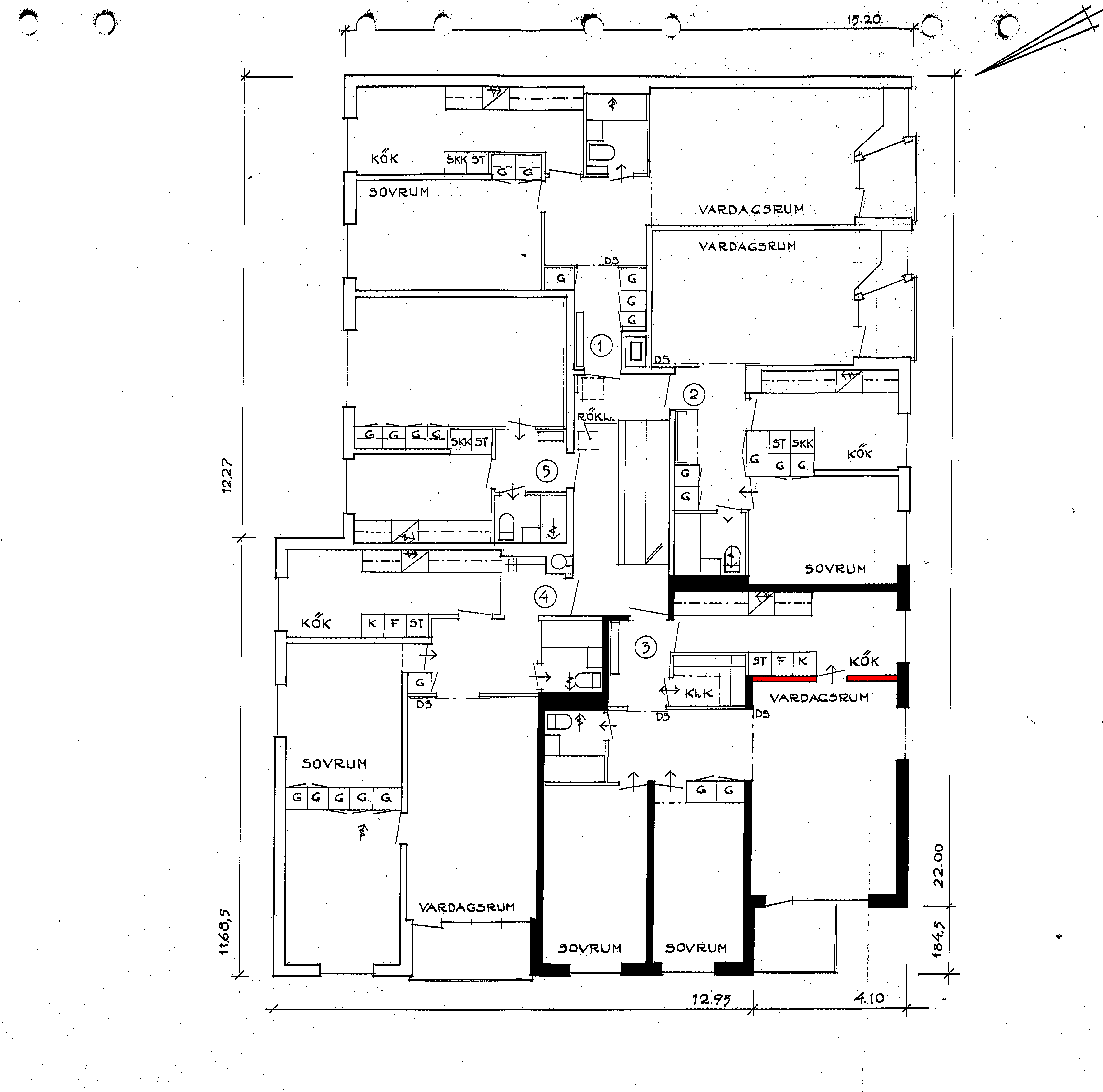

I live in a condominium apartment in a multi-story building from 1958. Floor 3 out of a total of 4. Construction-wise, the whole building is made of concrete, floors, ceilings, outer walls, inner walls, etc. I have obtained full construction drawings for the entire property free of charge from the municipality.
I am about to undertake a complete renovation of this apartment. To allow more light in and to make the home an open floor plan, I want to remove a load-bearing wall between the kitchen and the living room. The total length is almost exactly 4 meters and 150 millimeters thick. See attached plan drawing, where black-marked walls are the apartment's load-bearing outer and inner walls, and the red-marked wall is the one to be demolished.
I have been in contact with the community building office, where I was informed that a building notification is required for this action. Since the municipality wants to know how I plan to handle the removal of the wall and thereby maintain the structural integrity of the property during and after the intervention, I am looking for a structural engineer to calculate the load transfer and provide me with a K-drawing that the municipality requires.
Due to this, I have encountered two problems. I am looking for a structural engineer, which seems almost impossible to find. But when I do find one, the prices seem to vary greatly, and I mean literally greatly! I therefore need to find an engineer with a reasonable price level for their work.

Attaching the original drawings @justusandersson so you can get an even clearer picture and the information you need.
I completely agree with you @Bernieberg! For that reason, I contacted this sole proprietorship. I was naturally shocked already at the 10,000-18,000 kronor range that I got from Sweco. But when I read the email from the guy who runs a tiny sole proprietorship in the area, where he wrote that he wanted 31,250 kronor, I nearly choked on my coffee

It may be appropriate to point out that this type of intervention also requires permission from the housing cooperative. Some cooperatives then place some demands to see insurance certificates for the constructor, or other requirements beyond those imposed by the building permit authority.
Those are quite reasonable points from the board of the association to demand, I think, compared to what I've experienced!H hempularen said:
