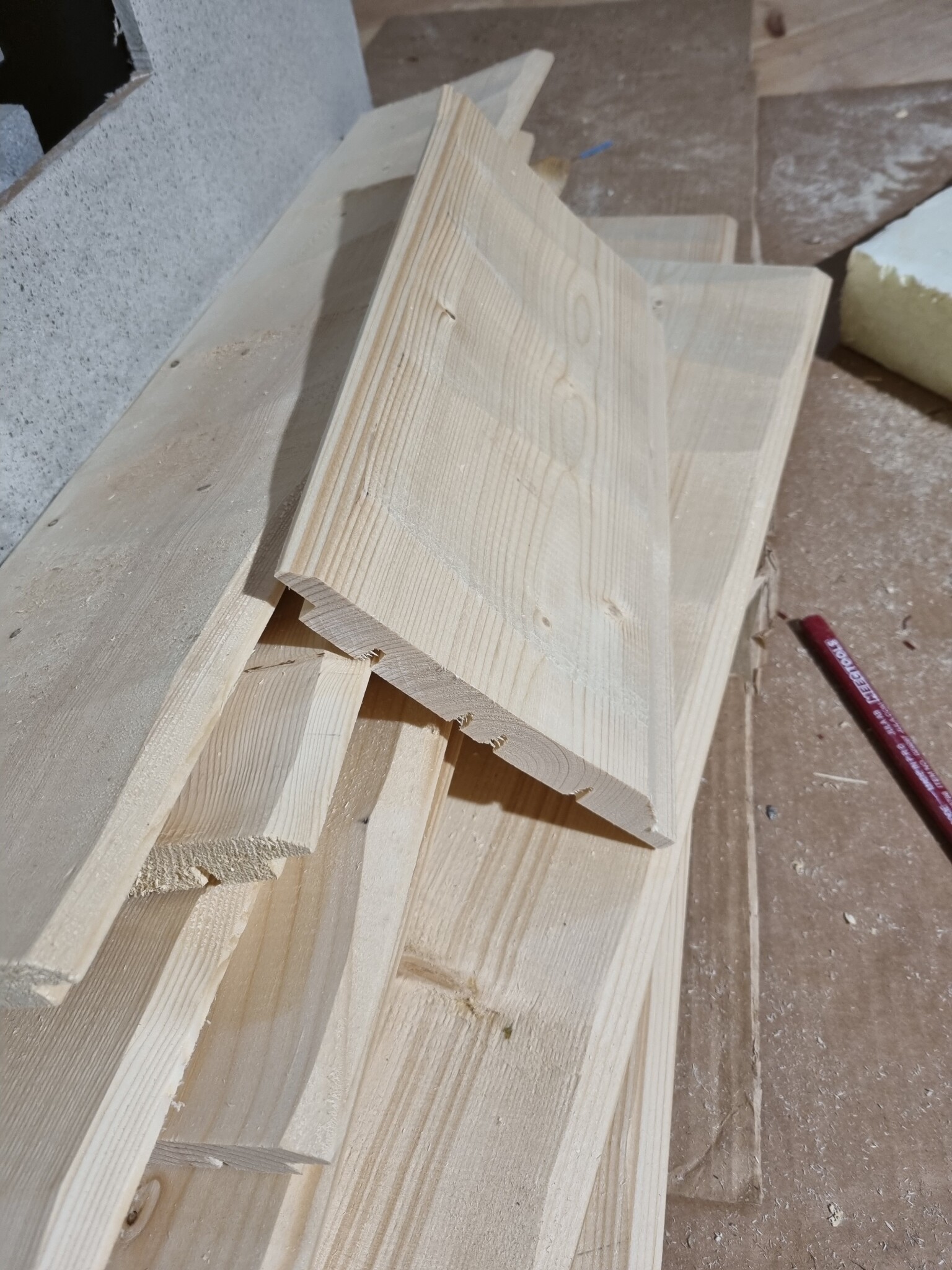

I'm installing timber paneling in the sauna section of a log cabin. My question now is, how do you mount it without it cracking apart? I have self-drilling panel screws, but the darn thing cracks with EVERY screw?

Buy the right screw for the purpose.
Wood screws are usually not self-drilling, more that the tip is serrated to cut its way into the wood.

Have used wsb floor screw. Very satisfied with it, drills nicely and never splits.

Then there's that classic Swedish low-quality wood, with a smaller eternity between the annual rings, mostly only suitable for toilet paper. Unfortunately, it's not easy to find anything else.
Make sure to buy paneling with the heartwood side facing outwards,D Davbos said:Now, I'm sitting here in the sauna build a bit agitated.

not inwards like in the picture, so it bends the right way, and pre-drill and nail.
I installed the same type of panel in a sauna, but nailed it with brads instead.D Davbos said:Now I'm a bit upset as I sit here in the sauna build.
